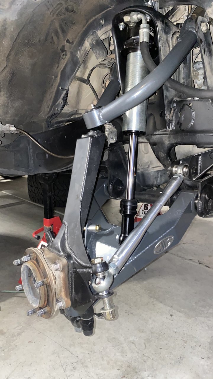

    2A6E38B5-FDD4-47B4-81B1-6B62EB84B3AA.jpg Is it really a bad idea to upgrade the tie rods to a solid piece with heims?

    https://www.tacomaworld.com/threads/airdogs-2012-prerunner-access-cab-slow-build.264263/
    Nope. But it may make your steering rack the sacrificial part in the equation of what breaks first. There are ways to mitigate it. But be prepared to spend money. I went with the JDFab slide rack and spindle double shear setup. Others went Tundra rack.

    Eventually I will do something about the rack but for now I was going to do tie rods

    yeah they work great just don’t be surprised when your rack breaks. I’ve got a tundra rack and I love it…other than you do loose a little turning radius with it.

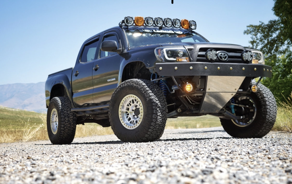

    Who's bumper is that?

    Looks like one of @DTFtacoma bumper options
