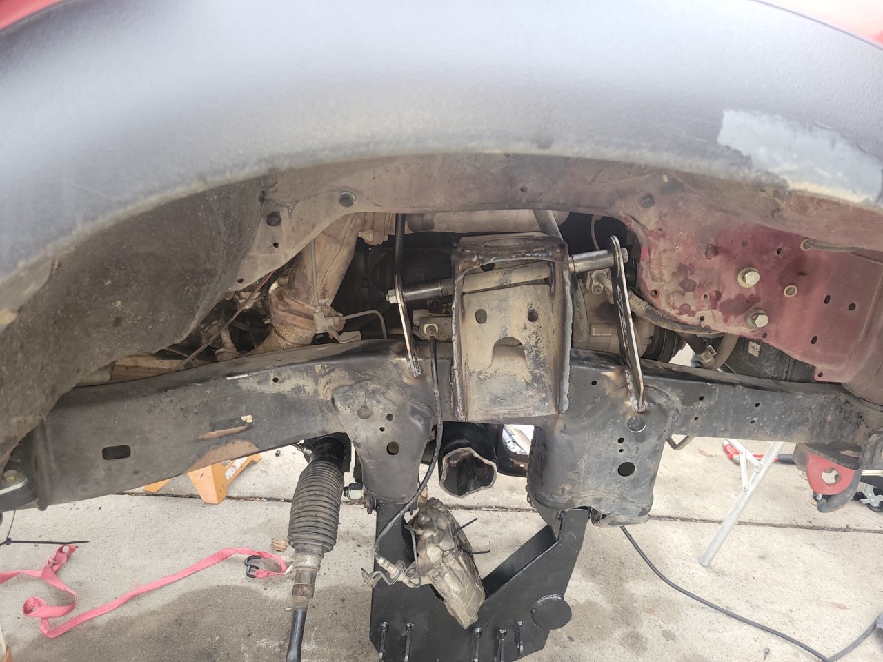

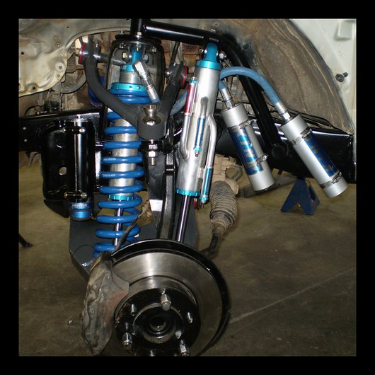

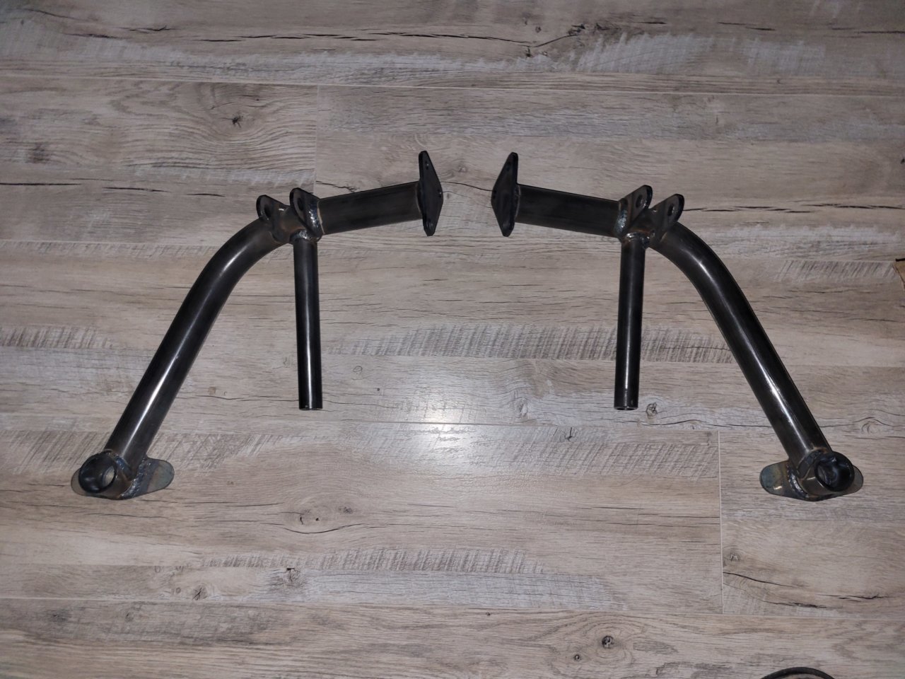

    Ok... I'm a little stumped. The top of these bypass hoops look nothing like the picture. Am I missing something here?
    The triangles at the top of the ones I recieved have 3 holes like it bolts or lines up to something. (Or like they can be plug welded to the side of a taller coil bucket.)

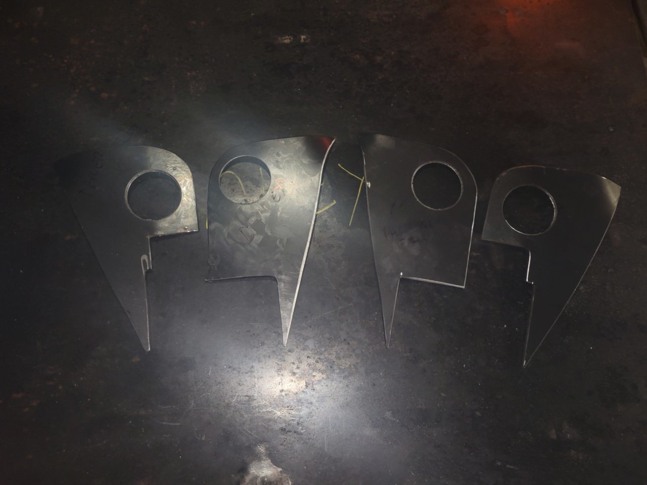

    Made WAY less progress than I wanted today. But I think what we're doing is worth it.
    Did get the rest of the tear down complete. And then we got the coil bucket reinforcement plates (about 95%) made. @Kwikvette was some clutch help today. Thank you, for real, Nelson :thumbsup:
    A CNC table sure would have been nice. But we managed, with angle grinders and determination :rofl:

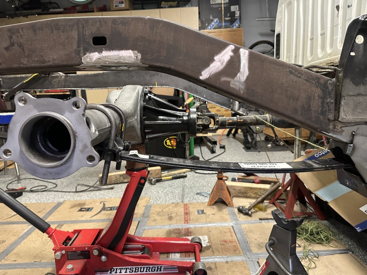

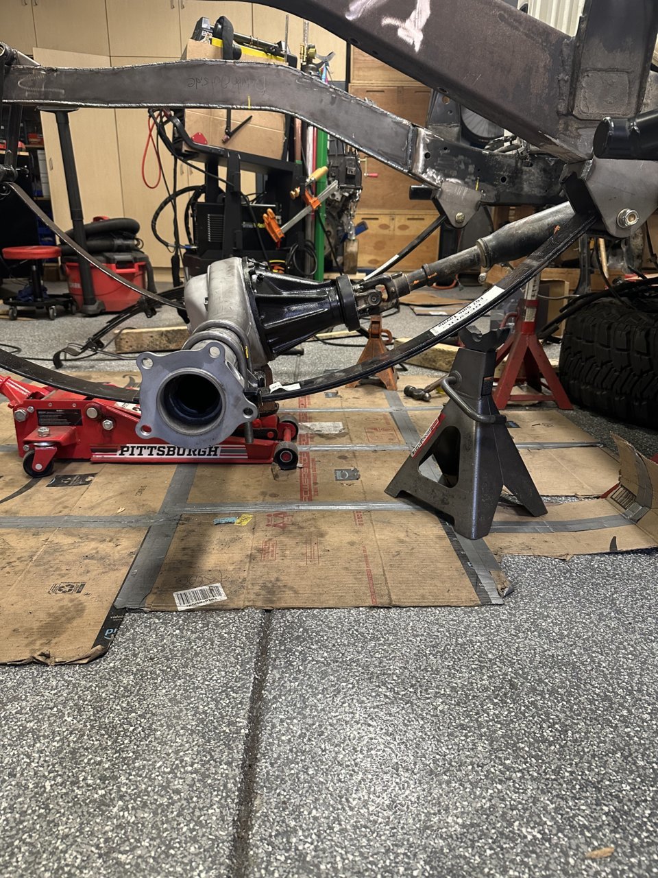

    SUA experts: Any tips/opinions/pointers?
    02 xtracab, everything is only tacked in place at the moment. Took 4-5 tries to line everything up:anonymous:
    • Pinion-driveline angle 2-3 degrees
    • Spring perches front to rear 52.5 right on target
    • The bump seems off. Main leaf is nearly flat/ inverted @ 4” from the frame. Is this typical? Or did I mess something up?

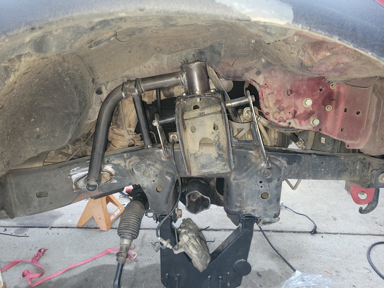

    What ended up happening with the hoops? Still don’t look like the ones on the site.
    Also your coilover tower doesn’t look like it’s enjoying this process. :rofl:
  18. Dec 18, 2022 at 5:25 PM
    El Taco Diablo
    El Taco Diablo Professional Pinstriper
    Nov 6, 2017
    #235223
    13,979
    Matt - KN6DZP
    Hughson, CA
    Impulse Red DC, 5vz-fe, 4wd swap, LT, dual case, F/R locked
    Just 3 tons of fun!!!
    LOL... that frowny face in the coil bucket... LOL
    I just cut the bracket and welded to a piece of DOM that was thexact right size to be beveled where it nested in the center hole on the top of the coil bucket.
    I actually like the way it ended up, where it will end up being easier to get a wrench on the top plate bolt for the coil over than it would have been.
    I'm lucky I'm running a 1 inch body lift. It gave me way more room to move in there, and made the way I did the top of the bypass hoops easier.
    The bypass shock mount moved up a little bit. But, when I end up running bypasses, I can just make that up in the rod end.
    Right now, I just wanted to get as much structure on the coil bucket as I could, and since I was already doing the UCA double shears, I figured it was a good time to do the bypass hoops.

    How much travel is it cycling?
    I think 2" inverted is as far as you want to go, could be wrong.
  20. Dec 18, 2022 at 5:58 PM
    Robmonster117
    Robmonster117 Well-Known Member
    Sep 29, 2013
    #113490
    1,963
    Robert
    Gilroy
    02 ext. cab 4x4
    Truck parts
    Currently measuring 18" @ full droop (Top of axle to bottom of frame)
    I suppose the axle perches I'm using are low profile (<1" rise) That may be part of the extra space Im seeing at bump.
    4" when the leaf starts inverting seems odd. Id like to get full bump up closer to the frame or on it if possible. Good news is the driveline seems happy through the range of motion
