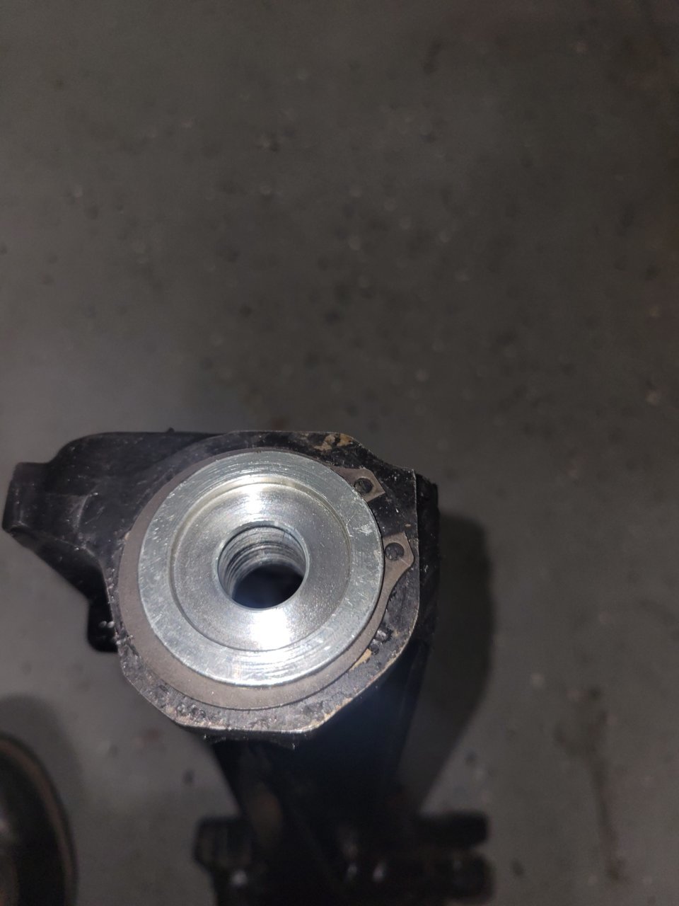

    Anyone here running a Solo LT kit with stock spindles, that have spindle gussets?
    The UCA slug that goes in to the top of the spindle... I'm pretty sure I know the answer here, but wondering if others have done that without grinding the crap out of it to get it in there.
    ... Nevermind... I know the answer to the question.
    I just had to grind the corner of the slug off, to get it to line up with the hole.
