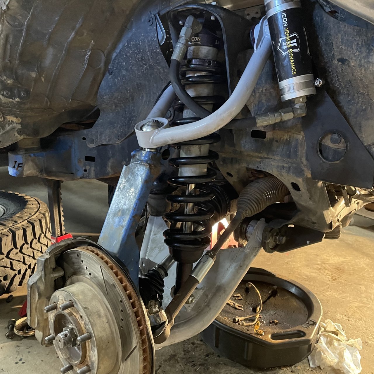

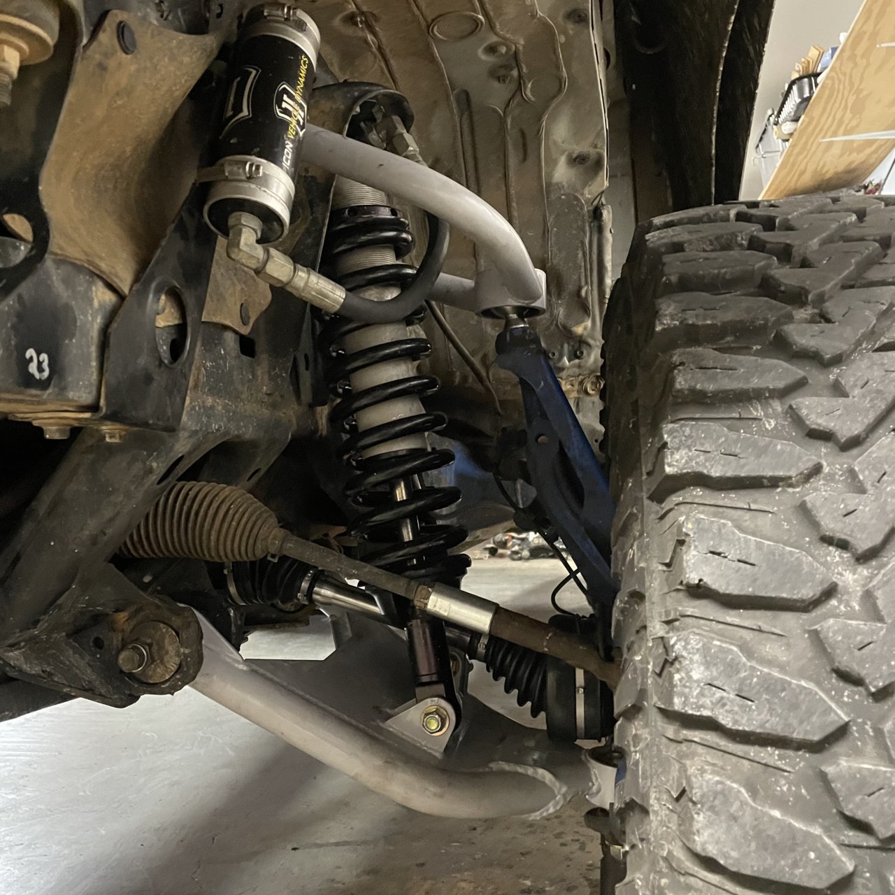

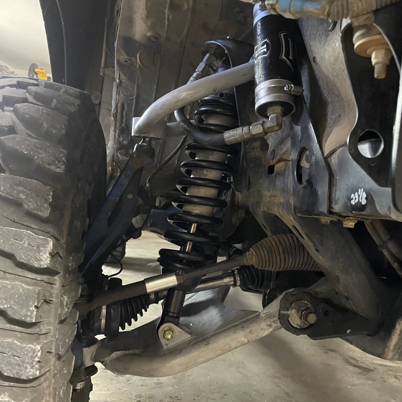

    Completed my LT install yesterday. Converting the CV’s was a task. My 20ton press gave up and had to get creative. Other than that, install was simple. It’s an AllPro 2+ kit with Icon LT shocks. The shocks were gifted to me, so that was nice.D85B5BA8-87CE-498B-8AAB-FFB25B6B7DAA.jpg D5FB3966-9745-4531-A1EE-C838B355997E.jpg B3A761C2-DDAF-48E4-8A07-782907FF8BD1.jpg 9C505D1E-B588-4014-AAFE-15658ACE40AE.jpg Next step is an alignment. I feel that 4* caster and 0* camber would be ideal for a daily driver with LT. This is a humongous amount of travel over the mid travel suspension that I had.

    Hows the bumpsteer? I've heard from some that those kits have issues with that.

    The all pro kit won't have any more or any less bumpsteer than any other kit that uses stock frame pivot points and the stock spindle
    You'll get bumpsteer when you start moving factory geometry without compensating for the changes
    Some examples could be a different width rack or tie rod changes using a clevis that does not mirror factory pivot location without changing the other end location of the tie rod to compensate
    2nd/3rd gen/4runner/FJ front suspension geometry cyles very clean and has very little bumpsteer

    i don’t think that is entirely accurate because a poorly designed kit can easily introduce bump steer if the geometry of the uca and lca are not correct. you are talking about the pivot points but there is more to the equation ie: the length of the ucs and lca and the location of the tips of those triangles where your bj’s or uniballs reside. If that geometry is not correct it will cause bump steer.

    While agree with the last comment I can say after 4K miles on my depo kit (all pro copy) I can say I’ve had very little bump steer. So idk if his will be the same or not.

    Didn’t you severely limit your up travel on your kit? How can you attest to bump steer if you limit you up travel? :boink:

    You realize bump steer isn’t always felt right? Measure toe through the range of travel, it might shock you. As @Evenflow said. There’s way more that contributes to bump steer.

    bro…you have less travel than a stock truck

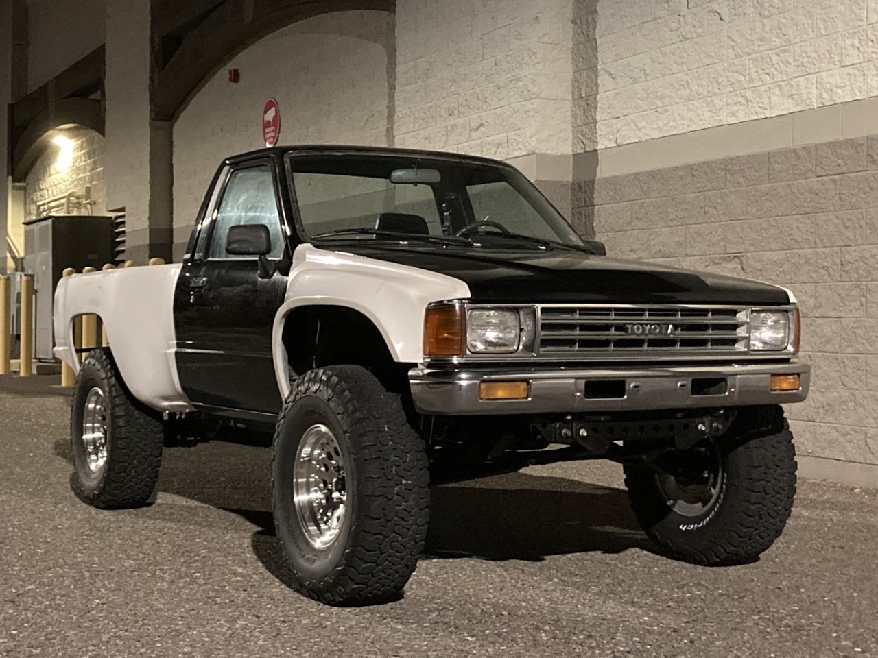

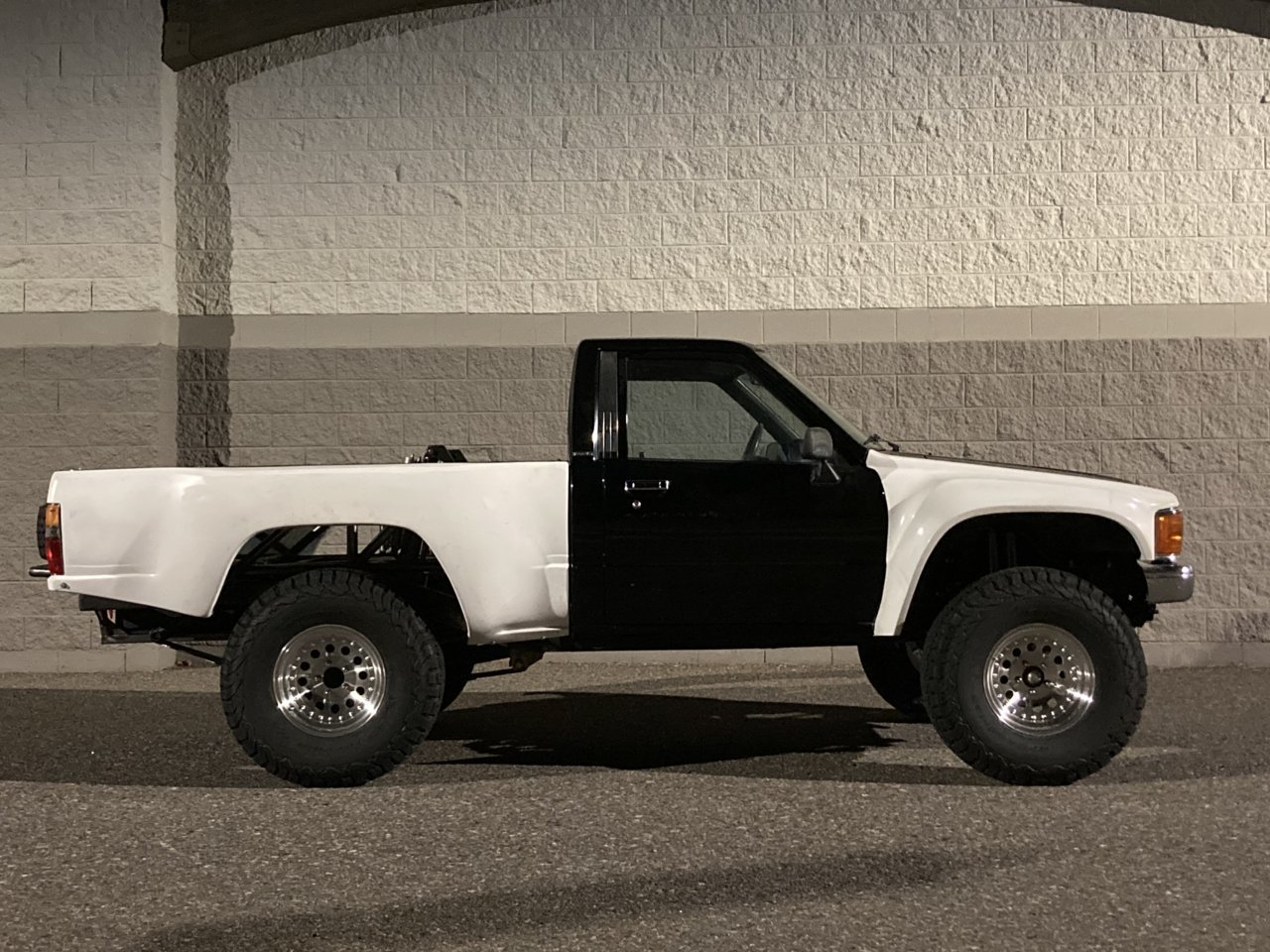

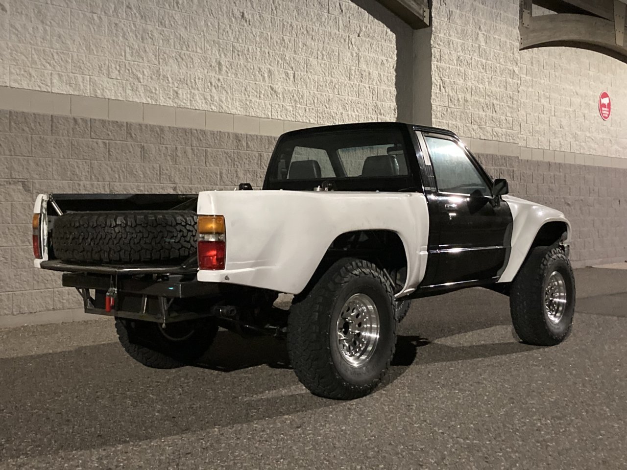

    Posted a build thread of my 89 toyota on bad lines good times
    Somehow snuck it in this morning without a bunch of BS comments cluttering it up
    Some cool DIY builds over there

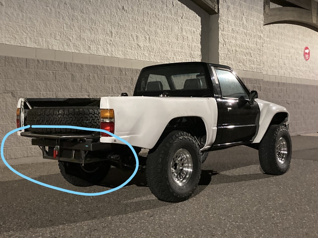

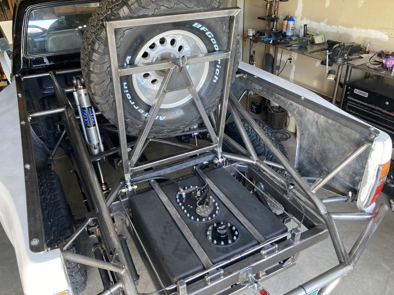

    This thing is rad! You have a link to the build thread? Love the work you've done to it.
    Really curious of what you've got under the bed?

    Came out looking good! Is that a new kit or did you do a refurb on it? I also didn't realize that Icon made an 8" C/O.
    Getting my axle shafts out of the outer/inners was also a PITA. My 20ton press also wouldn't do the trick. Ended up cutting the shaft on the outside to get the shaft out and taking the inner to the lathe at work.

    thanks, have a build thread on bad lines good times for it
    22 gallon cheapy fuel cell under the spare out back, gotta mount gas struts for it still

    Nice! Unique and clean work. Lots of tube work done back there for a "street mobber!"

    Ha , yeah, this one got away from me, eventually paneling the whole "bed" in
