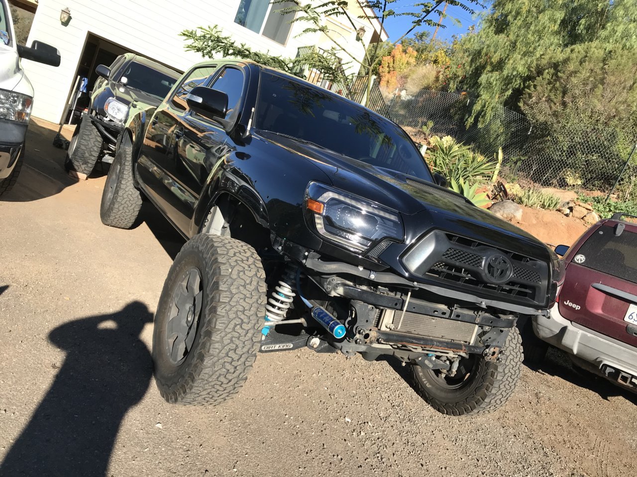

    Gotta clean up the fender flares... But I reached a milestone :thumbsup:
    Caster is set
    Toe is set
    Chamber is close, but won't know for sure until I set ride height.
    Have to clean up the fender flares for sure... but full stuff and lock to lock is clear.

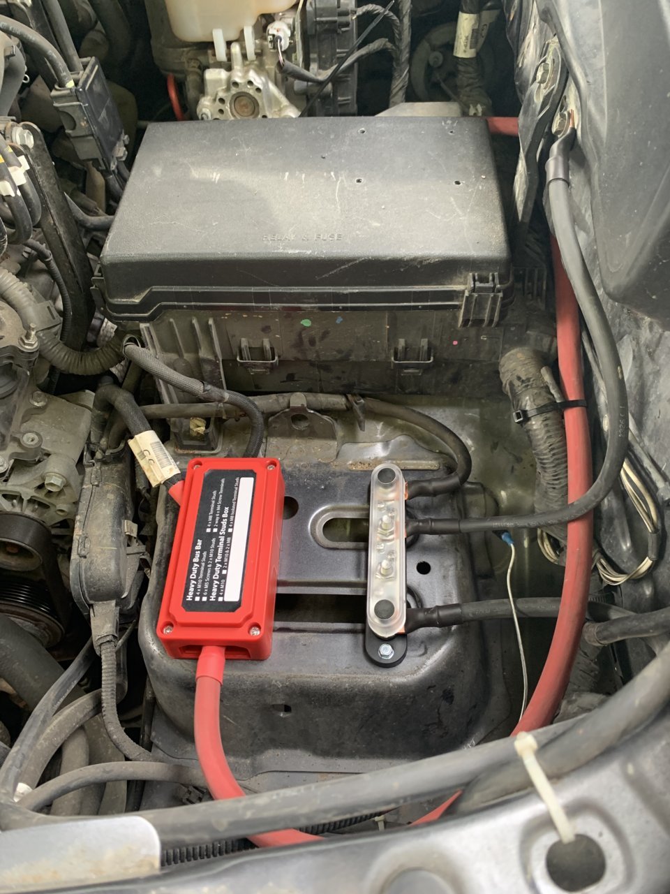

    Imposter
    This is a bit old but here’s what mine looks like “done”. Note the wires are way too long on purpose. This is only going to be temporary until I chop up the wheel wells and move this stuff around.
