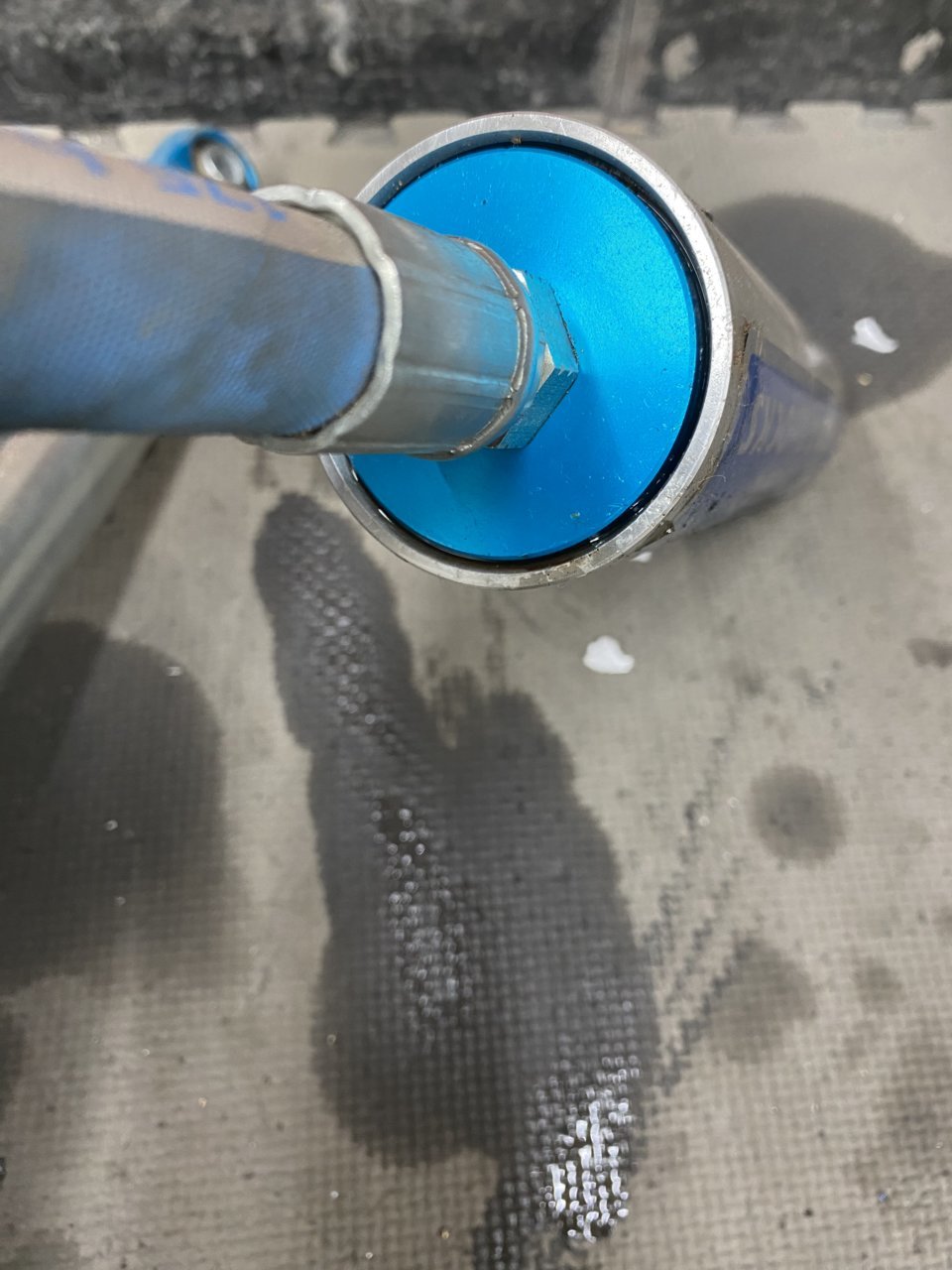

    Not sure if anybody has ideas or not, but I’m getting damn close to jumping ship from King. 1,000 miles in I blew the IFP seal on the drivers side. 1500 miles in the seal blew on the passenger side. Now I have the coilovers and bypasses off of the truck, dumped air out of them and collapsed bypasses for storage. Both bypasses are now leaking profusely from the end caps. Has anybody ever ran into this? In my 6 years of owning king products I have never had issues like this. And it’s really odd to me that all failures have been on the reservoir end.

    could it be caused by the extreme cold you’ve had ? seals shrink when cold ?

    They are in a 65 degree area and have been since removing from the truck. Also, I had kings on my truck back when I was daily driving it year round. They saw negative temps often. And aside from being super stout when that cold I never had any issues. It’s almost like my resis themselves have some kind of issue.

    might have got some dirt or something in there and eventually tore the seal up causing the leak. All there are is Orings. Make sure you choose wisely between Buna and Viton as one of them doesn’t like extreme cold if you find yourself ever in that environment.

    Yup, I am aware of the viton VS buna deal. Mine are buna for sure. My concern is I’ve now had 4 blowouts with these reservoirs. Just doesn’t seem like I should have had any at this point. Like I said before, both IFP seals have gone on me once already as well with under 2k miles. Now the end caps are leaking pretty heavily.

    I did that 3x now. They apparently have never had a manufacturing flaw and won’t give me the time of day on the situation. Customer service has gone to shit across the board it seems. They did however quote me new resis. I’m convinced there’s more going on here. It can’t be coincidence both front bypasses are having the exact same issues at damn near the exact same time.
