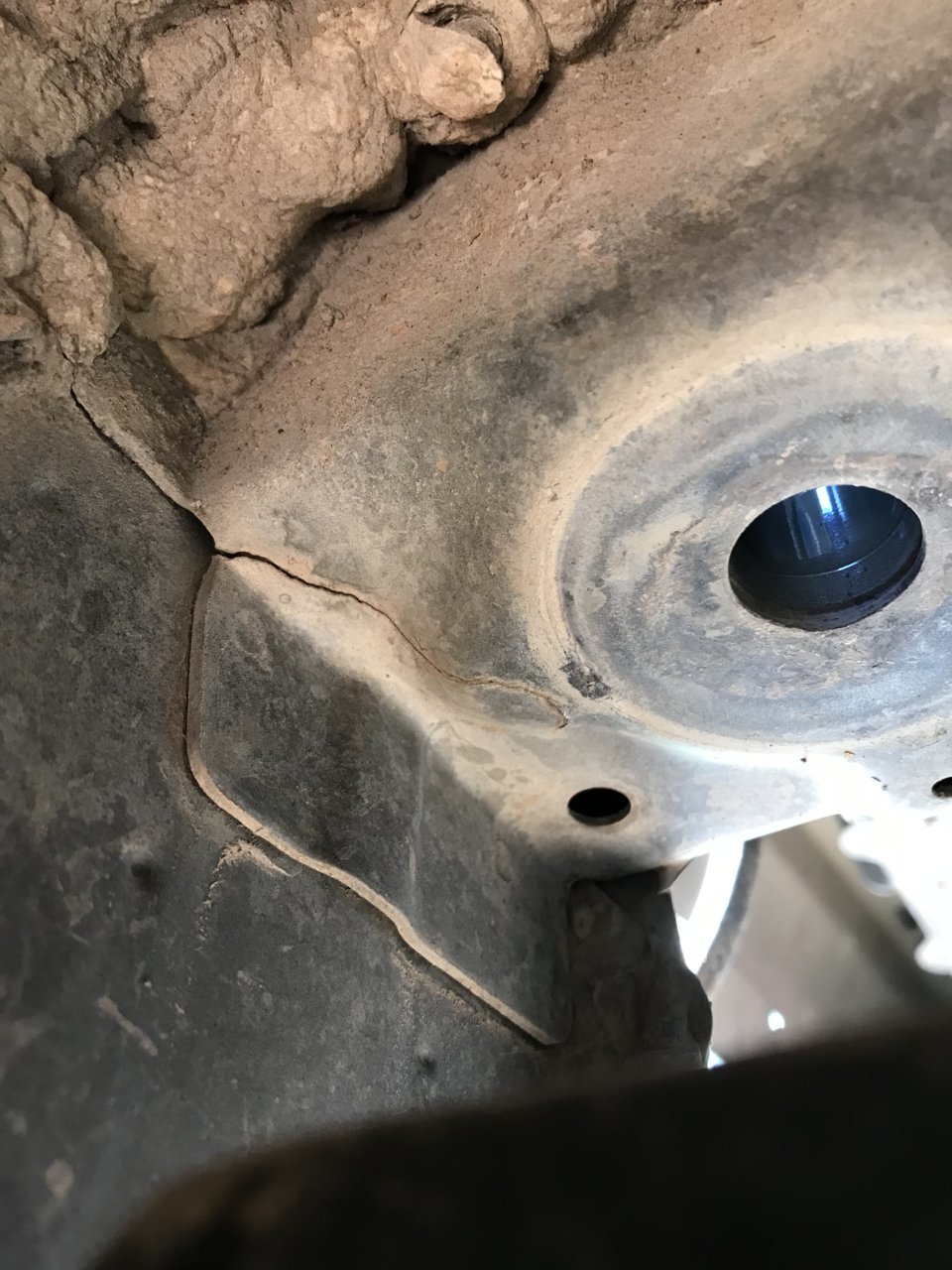

    Finally listen the cab to take a closer look and replace the bushings. Luckily it only looks like one has started cracking. Passenger rear.

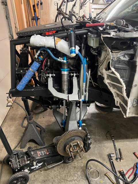

    Made some progress this weekend.
    Looks like my guess at camber was really close. It'll need some minor adjustments.
    The guess at ride height came out within a half an inch of where I wanted it. (I think I'll see how this feels for a minute before I decide if I want to go down from 650# to 600#... I'm even thinking maybe 550# now)
    Had to order different length limit straps. They should be here by the end of the week.
    But she's on all 4 wheels and drivable. :thumbsup:

    You driverside is likely cracking too, except it will be concentrated around the "hole" in the chassis, it will look like the "hole" wants to punch through the bottom of the chassis.
    If it isn't already cracking, it will at some point in the future.
