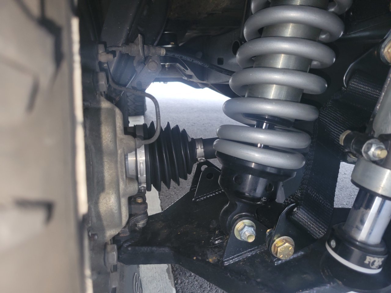

    One thing I'm also noticing. Bobby recommends 16 collapsed x 24 extended 8 inch coilovers with 600# 16 inch coils... But I'm noticing that the cones at the bottom are taller than the cones I'm running. I think I may have enough room here for 18s.

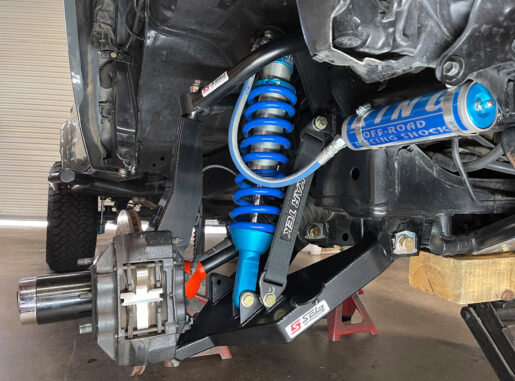

    Here's the 4 runner example on Solo's site.
    He's running a taller rod end and maybe the same height cone than I am.
    Here's the bottom of mine.
    @Robmonster117 you just did a Solo install on a first Gen. Have you had a chance to cycle and dial it in? Are you seeing anything that resembles these issues? What coil length and # did you run?
