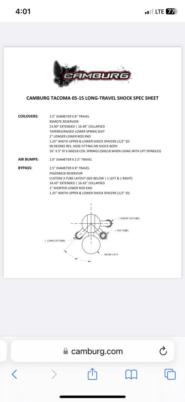

    Does anyone know if Camburgs 3.5” LT kit for 2005+ trucks requires a special bypass layout?
    I know they need a shorter rod end and 1.25” spacers, but don’t see why I couldn’t order Fox #980-02-212 from Accutune or DownSouth and change those parts.

    Good to know.

    Yes

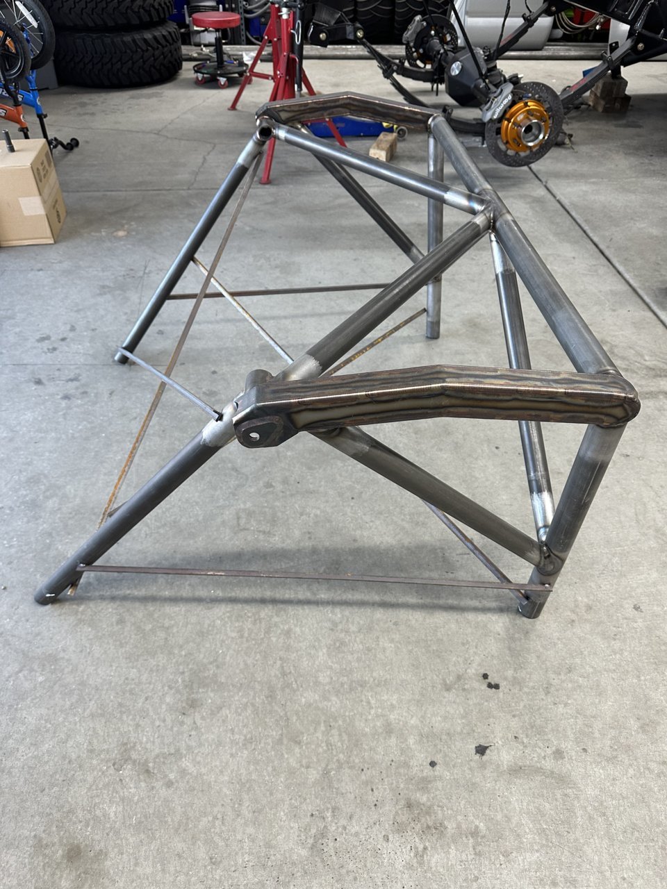

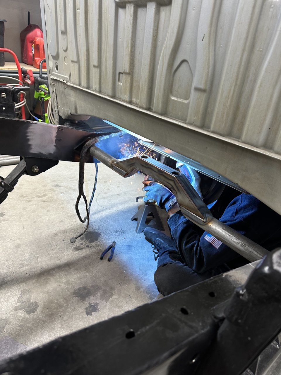

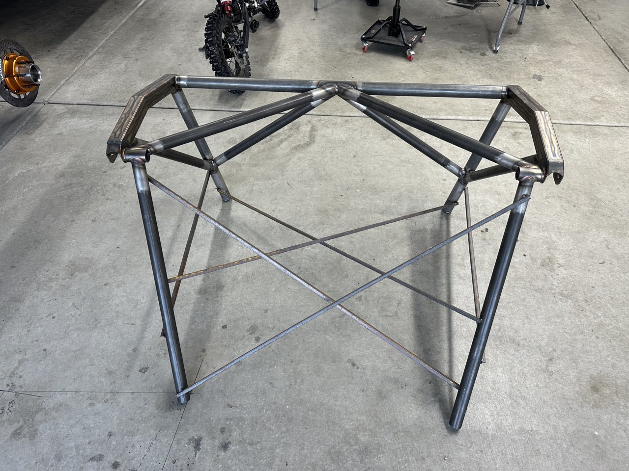

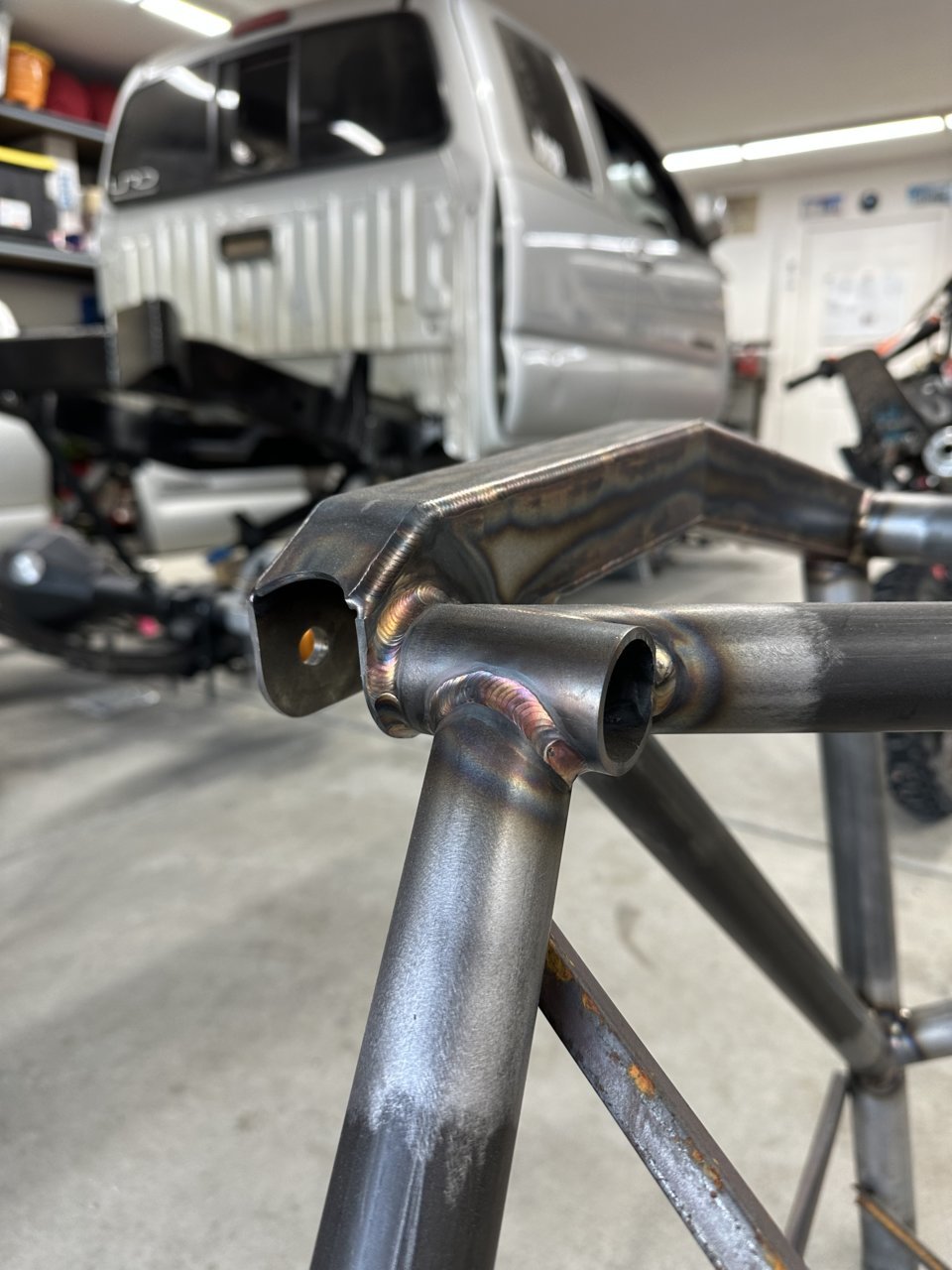

    Some carrier bearing support and bedcage action

    Very nice! You doing all of the MIG work?

    You ask about MiG work when he posts up some of the better Tig welds we’ve seen in recent past? Those are some beauties

    yeah, if that was MIG then I need way more practice.

    You're correct. I meant TiG. That’s why I asked. Some beautiful welds.
    That’s what happens when I post before I’ve had any coffee. :anonymous::facepalm:

    SMW, 312, ? Welds really look nice. Great work.

    Depends on how visible it is :anonymous: I haven’t been welding for a while and I have friends that are way better so I just have them do it lol

    ER70S-2
