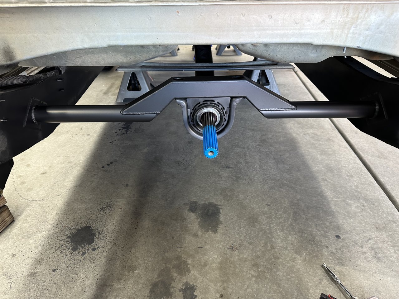

    No I built my own driveline. It’s a Dodge 3500 carrier.

    Nice. I’m debating what to do with mine. I have a sterling rear and want to keep a two piece because my lower link mounts are right under the carrier bearing. If I build the ds myself I’m not sure what carrier bearing I’d go with. If I get JE Reel or someone to build them I’ll do whatever they suggest. Not sure what yokes I’m going with yet or anything though, just know I want all DOM shafts. Just gathering info.

    Yeah I didn’t feel like spending $1000+ on a drive shaft that I would have to order because no one here makes them so I just build my own for about $350

    That’s probably what I’ll end up doing after getting a quote haha mine won’t see any high speed so it won’t need to be balanced any more than what I can do. I think WOD and BK have some driveshaft kits that would be easy to worth with and mate up to DOM without machining anything down.

    This carrier bearing from mitchmade on IG is a winner in my book.

    i ran a solid bearing once and as long as i am dd’ing my truck i’ll never do it again… basically a constant hum and vibe. it did make the driveline feel super tight though def a good idea for a dedicated play truck

    I have no hum or vibes. The diff may be that this CB is mounted in what seems to be modified leaf spring bushings

    yup big difference, mine was one of those mcmaster carr bearings, bearing in a cast housing bolted directly to the shitty oe cross member. could feel the driveshaft in my ass…wait that didn’t sound right :anonymous:
    where did you get that one ? i’m going back to a two piece when Harry does my 4 link and frame boxing etc so i need to figure out what to do for a carrier bearing. OSide Driveline mentioned something they had but it just sounded like that Ranger bearing a lot of folks use

    mitchmade on instagram. he's a pretty solid dude, i've got his uca/shock mounts on my truck.

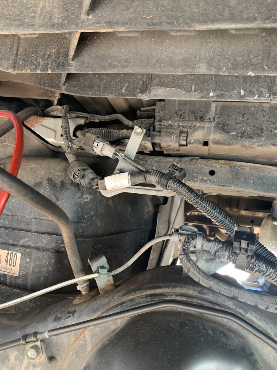

    For those of you that have/still have this bracket, what did you do with it? Currently at full droop the bracket needs to angle down but at full stuff the diff pushes it up. I can’t see a way to angle/mount it so it works both ways.
    Currently I just slightly loosened the bottom bolt and just let the bracket pivot when it needs to. Maybe a little bushing in between the two and a little rubber bumper where it connects with the diff. Other than that I don’t know what to do with it.

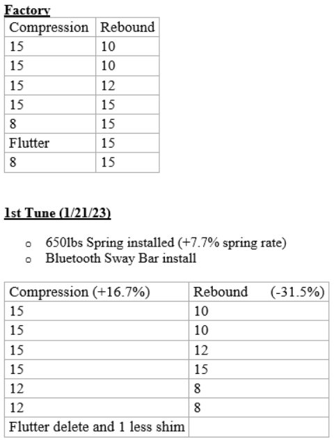

    Does anyone know a good thread that discusses valving of shocks? I cant seem to find any but feel like people on here would be "experts" with good intel. I was told to ask in here, despite being a peasant mid-travel.
    The reason I bring this up is because I am trying to dial in my front end of my 2.5 King Ext w/ adjusters. My neighbor showed me the art of revalving, but I assume one of the TW guys knows much more than him even. This is what I documented along the way to keep track and am mostly happy with it, but already wish I went stiffer on the compression valving.
    While doing this, I swapped springs to 650lbs to account for the armor/ AGM battery / steel bumper / etc and went from 1 1/8" preload on both sides to zero preload on passenger side and 1/4" on driver side. Going to go up another 1/4" I think, but will figure that out later. Below are tables showing what King valves their shocks at from factory versus what I did.

    Never make multiple changes at once. You made 3. Spring, compression and rebound.
    What is it you are looking to get?
    erok81 and Airdog like this.

    Point taken on making one change at a time, however I just am not able to tear apart the front end multiple weekends in a row. Ultimately, I am trying to be able to handle larger bumps (or small whoops) at a higher speed.
    With factory valving, it was wayyyyyyy tooo soft on compression and too much restiction on the rebound... With that said, we did not know what most guys start with as a baseline. So this is my baseline-- pretty confident the springs were a necessity with my "prelander" setup, and honestly not as much of an increase in stiffness as expected.

    I'm assuming we're looking at the valve stack with the piston at the bottom? How much bleed do you have?

    Explain what you did with your rebound and why? Am I understanding 10’s would be the big shims and the 8’s would be the small? As mid travel these trucks really do need a bit of rebound valving to reduce how hard they top out. The top out is incredibly harsh. You’re super light on the rebound side from what I was as mid travel. But then again, it’s not a one size fits all deal. Which is why you don’t find much for resources.
    If you’re unable to take the truck apart constantly to get it right. I would suggest sending the shocks out to down south or similar so they can tune them.
    Personally, I’ve had my shocks out 6-8 times in a weekend while trying to dial things in. It takes a ton of time to get right if you’re not a pro.

    The shims were stacked
    TOP
    15-12 (comp.)
    // shock piston //
    10-8 (reb.)
    BTM
    Bleed? Is that reference to the nitrogen PSI? Sorry, first timer that leaned mostly on my neighbor who has more experience with this.
