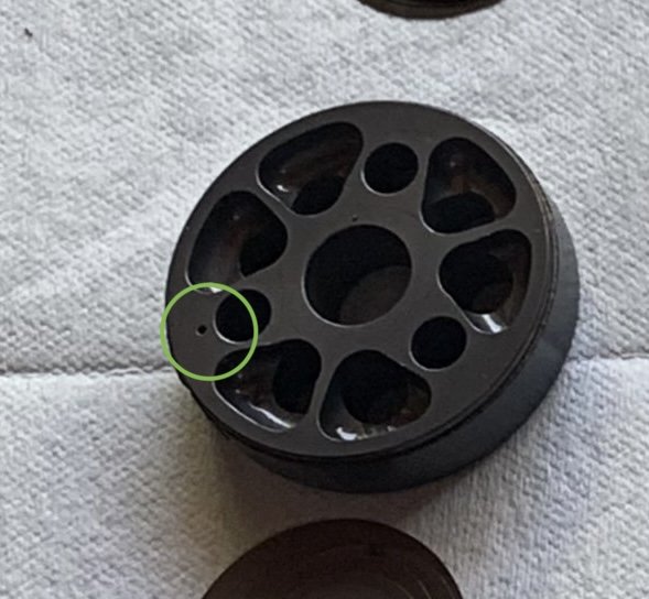

    Drill more holes in piston or enlarge current ones - increase bleed.
    Hole example. Little one on the left. I wanted to see how it changed the ride so I drilled a few new ones for the rear. Not too difficult to “undo” if it’s too much.
    Edit: that photo was way too long.

    You should have 3 holes already in your shocks. They should be tapped for a .050 screw. Bypass pistons typically only have one small bleed hole. But you can always get a numerical drill set and play with adding more of different sizes.

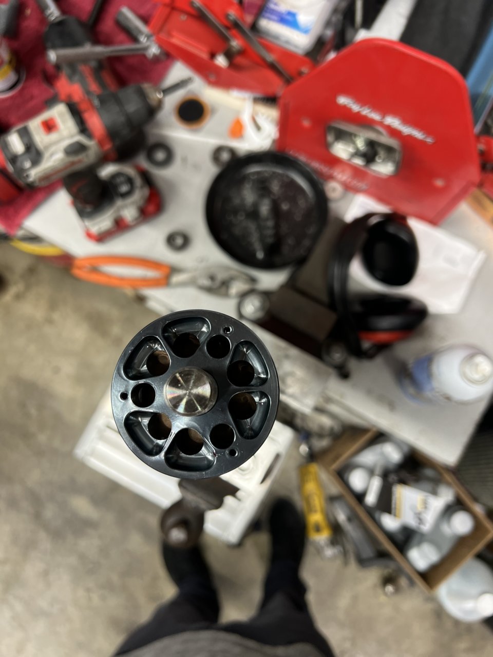

    Good to know, I just so happen to have snapped a photo of my front CO and it helps to know what I’m looking at now— thanks to all
