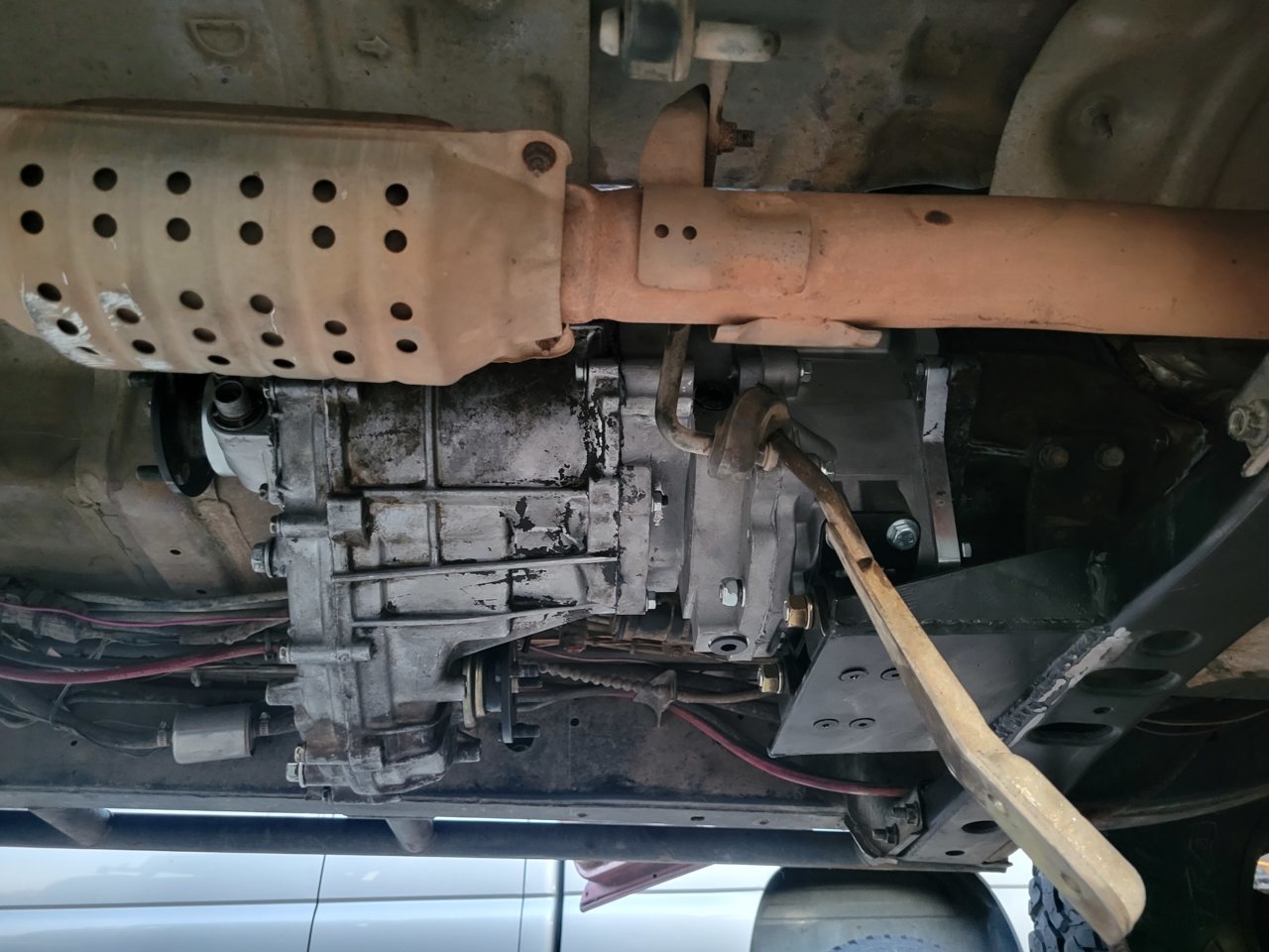

    Been too busy installing the dual cases to switch the front coils until yesterday.
    But the answer to the dilemma I was having with the 650# 16 inch coils having a gap to the preload collar at full droop was DEFINATELY 550# 18 inch coils.
    I'm at bearly any preload and ride height appears to be where I want it. But I need to mount all the skid plates and take another look.
    Now to build the transfer case skid and hopefully get the front adjusted a bit more before we leave for Hammers on Wednesday.
