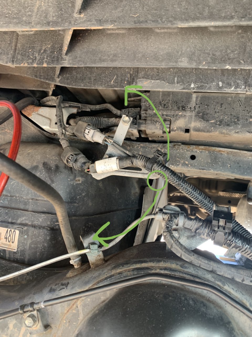

    Imposter
    Posting this again since it got buried. Unless second gens don’t have this wiring harness someone has to have ran into this before? Unless no one noticed. Which I find hard to believe.

    Excuse this crude edit. Arrows are the movement. On my phone. This sits right above the diff. It’s the wheel speed sensors and the diff lock. I noticed after full compression I was checking the downtravel and they were banjo tight. What happens is uptravel my diff hits the circle piece and pushes it up then during droop it pulls it down. Right now I just have it semi loose so it can pivot. But that can’t be the best solution.
    Only other option is maybe ditch the entire bracket and cut/lengthen the whole thing. :notsure:
