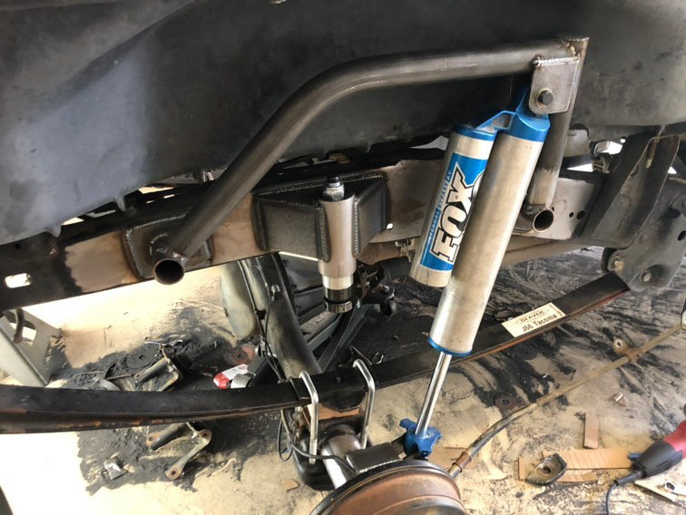

    I got raptor shocks as well out back… better than any oem replacement, and a lot cheaper than a 12” archive setup or something similar.
    works alright for now, but it’s no SUA.

    What shocks are you running? Part numbers?

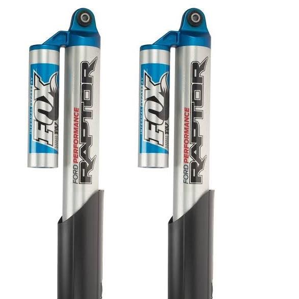

    Eh I forget the PN, honestly idk if I knew them. Got them at a local Ford raptor shop that has takoffs frequently.
    basically the 2017-2019 or something ones.
    Fox, 12” stroke, 3.0 diameter, piggyback 2.5 resi, internal bypass. Not the Orange fox live valve or the earlier gen1 raptor 2.5 ones with the darker blue. They have a light “king” blue caps despite being fox.

    Compression adjusters? Eye to eye mount? Everything I’ve seen online is “approximate product image” or what ever the verbiage

    These.
    I don’t have the measurements.. I ordered DMZ lower shock mounts and made some hoops under the bed along with hydro bumps at the same time. So I just cycled the main leaf and set everything based on that.
    Not a bolt in replacement I should clarify.

    Kinda what I was thinking, I can Fab so that’s fine, how does it ride?
    I found these while looking into your set up
    https://www.stage3motorsports.com/9...MIrrCYl8ix_QIVIgbnCh1w9gwfEAQYECABEgKTl_D_BwE
    ps that shock hoop looks great

    Also, I wonder what kind of travel numbers this produces. I cant find the data on it but if it fits a 4” lifted f150 with a stock travel of 12”…I’d imagine that this would have to have at least a 14” travel? Idk I’m a noob to this stuff lmao
    disregard. Found the travel numbers and it’s 12.1” per fox for pn 985-26-054 but pn 985-26-055 is 14.1
