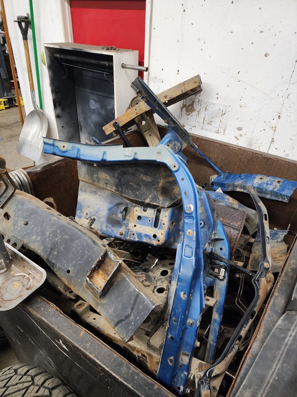

    You don't have to own a tow rig and trailer, all you need are jack stands. If your truck is just in the garage being built indefinitely, nobody can call you a poser.
    Or you can save even more room like me and just fit most of your truck into a big box.
