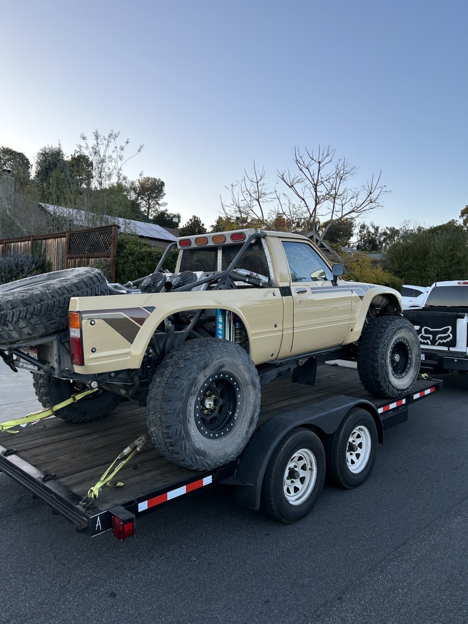

    The old school graphics came out perfect!!
    Buttskevin21 likes this.
