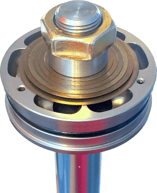

    Trying to decide on flutter shims to add in my coilover I came across Accutune’s “superior” double flutter. Not that I need to run this double flutter (I might just pop in a 15 after shim 1 but I’m curious what it is. I tried google’ing every version of double flutter but only got results from them. Only thing offered was this pic. My first guess would be multiple flutter shims in different spots, but the pic doesn’t look like it. Just a major thick shim in position 2.

    i wonder if its referring to a flutter on compression and rebound. when king revalved my old rear shocks they where talking about that accutune ordered them like that from them, they where very critical of it and said in all there testing they've never seen it work better and said only accutune does the rebound one...they basically said it was dumb.

    I have also seen double flutter on Compression side. Cant say it was from accutune or someone else, ive opened so many shocks before. But Even hearing from fox say adding the flutter benefits from 2nd inbetween 3rd shim largest shim. Usually see it as a .010” and a 1” diameter or so. I wouldnt do double.
