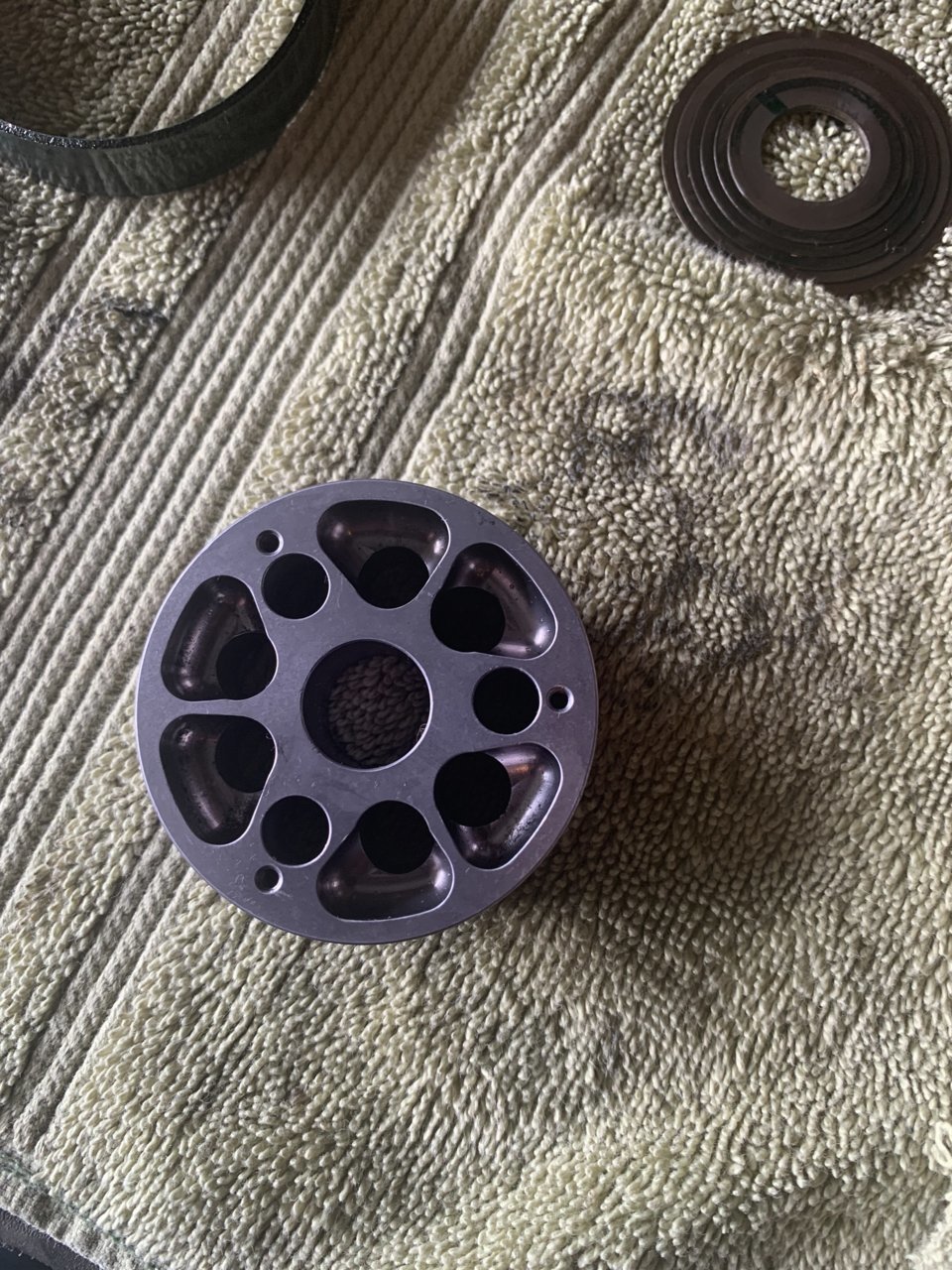

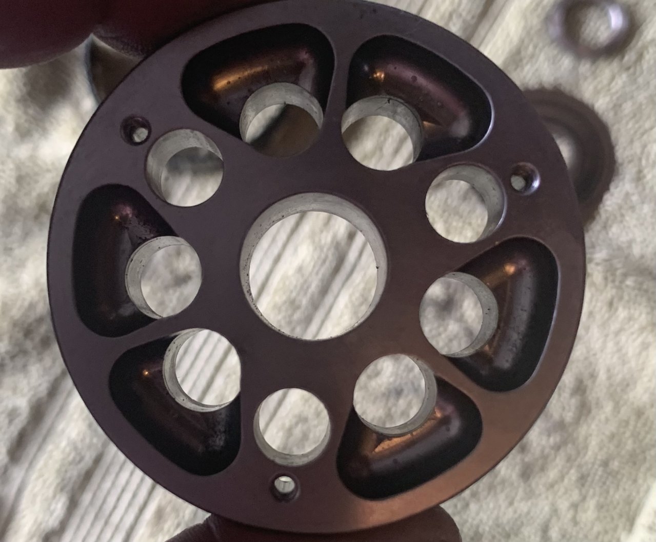

    You're 100% sure all three were open? King pre-drills the holes but they use set screws to block them off. I'd make sure before putting back together. Also, what size bleed holes? Did you measure them?

    Yep. All open. Funny because I was going to post this pic but the other one looked better. I left them all open. I’m pretty sure they were bigger than my rear bypass bleed hole but I spaced measuring. Was in a hurry to get it back together before I was totally soaked by rain.
