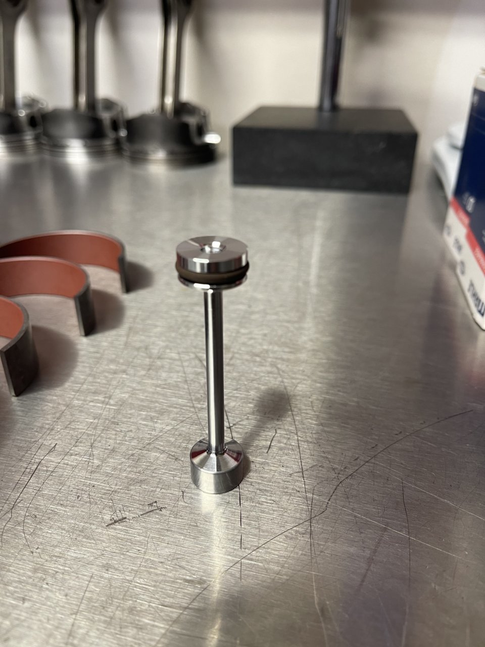

    I did a BTR stage 2 cam
    Was not enough in the buttcheek dyno
    did you remember to swap out your oil valley barbell for a metal one?
    It’s surprising how often I hear that it’s overlooked

    I'm putting the btr Truck Norris cam in mine. Haven't built the motor yet. It's a 6.2l l92. Hoping to find an ls3 intake for it as well. I'm pretty new to the ls, and had never heard of the metal barbell till now. Easy enough, I'll order one up!

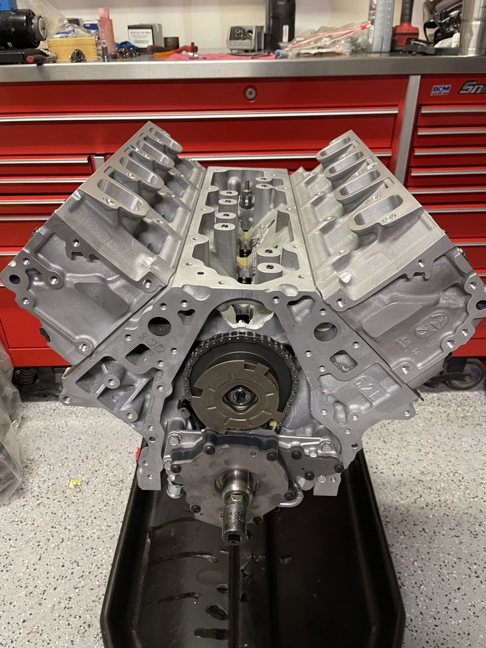

    I am just finishing a 6.2 LT
    It’s in my build thread
    My motor guy is nuuuuuuts

    OEM one is plastic
    Once it breaks
    Your oil stops reaching the filter and you just recycle the same oil through the motor indefinitely 05E2663D-092E-4ED6-9630-36F4E872B4F1.jpg

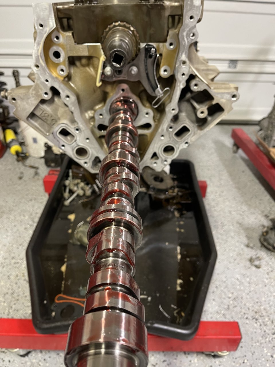

    I cheated with my 5.3
    I grabbed the stock 6L90 torque converter in it that’s rated higher but keeps the stall basically stock
    The 6.2 has bored cylinders and Diamond rods/Weisco pistons with a 225 cam
    you know who built it, I’m sure

    Top is 6.2
    Bottom is 5.3
    90F11F69-D925-424B-907F-53838387A315.jpg 43DE2C49-B46C-4B44-9692-EA0D312EFB5D.jpg
