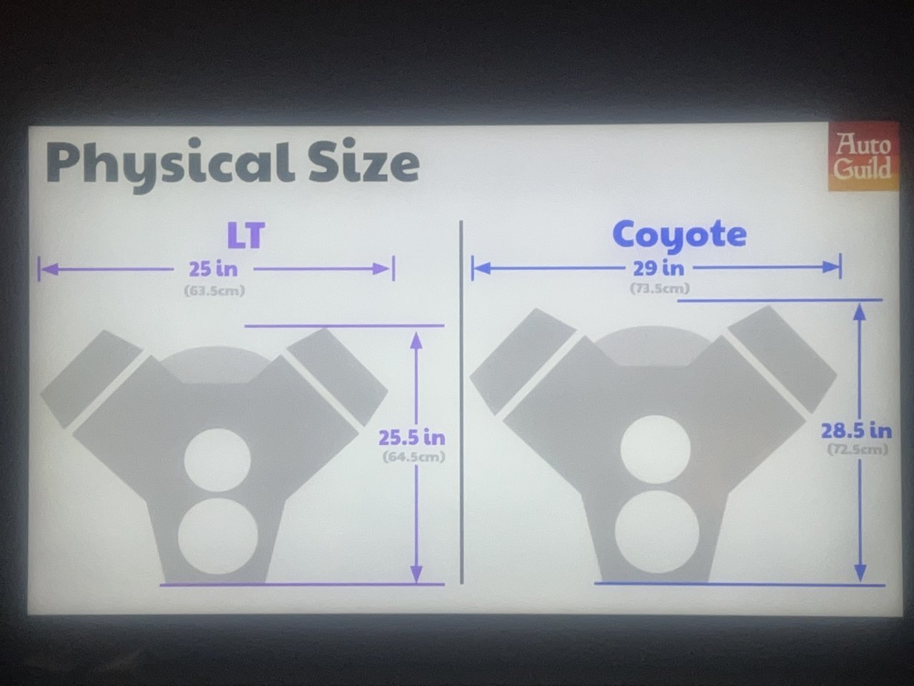

    That’s a coyote. Not a Godzilla. Godzilla is not dual overhead like the coyote which makes them substantially smaller. Even as a 7.3, the bore spacing is more in line with a small block than it is a big block. It’s truthfully a surprisingly small package with a fully dressed weight similar to an iron block LS.

    They discuss both in that video
    That is just the picture I had handy
    The ford family makes more powerful motors but sizing leaves them overall more bulky
    LS/LT lost in most every category except size
