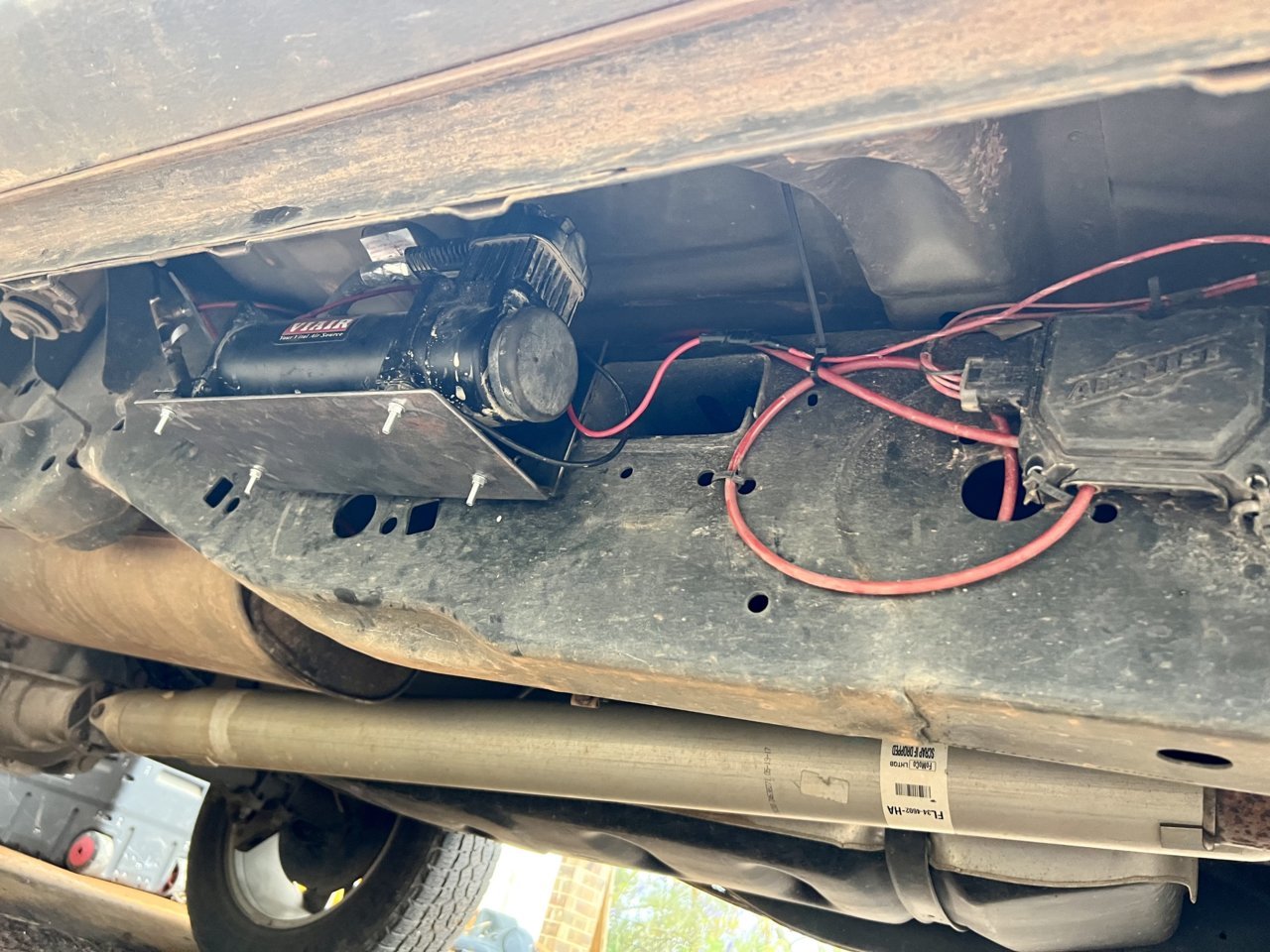

    I wonder if you can add air bags after the fact to the tundra? Since it’s linked I don’t guess a generic one would work. I have an aftermarket system on the Ferd you can fill from an app. Hooked up an extra VIAIR I had so I can fill tires with it.

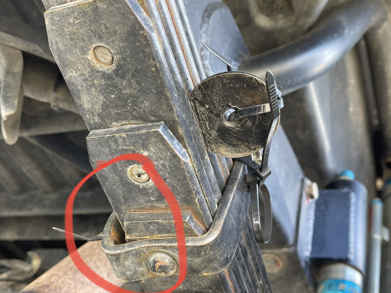

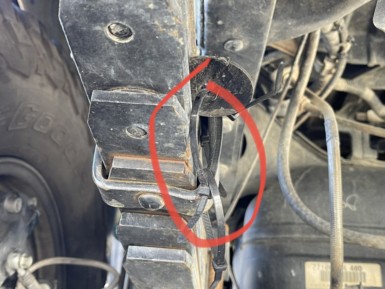

    Noticed this from my last trip in Baja. I noticed the pads whine in Baja and quickly zip tied them. I assume there was separation and they came out. Today I noticed the parts on the leaves are bent. Likely from movement. will limit straps help here? they were supposed to be added last time but they forgot.

    This post just reminded me I need to get new pads. I have 5 MIA on my brand new springs, after one summer of use. No idea what the deal is.

    I completely removed the pads when I rebuilt my springs. No worry about losing them now.:cool:

    You’ll be pretty shocked when you see how fast leafs start cutting into the bottoms of others. I wouldn’t really suggest doing that.

    Except deaver recommends leaving them out? But yeah you can’t just drop them and call it a day. You bevel the edges so your scenario doesn’t happen.
