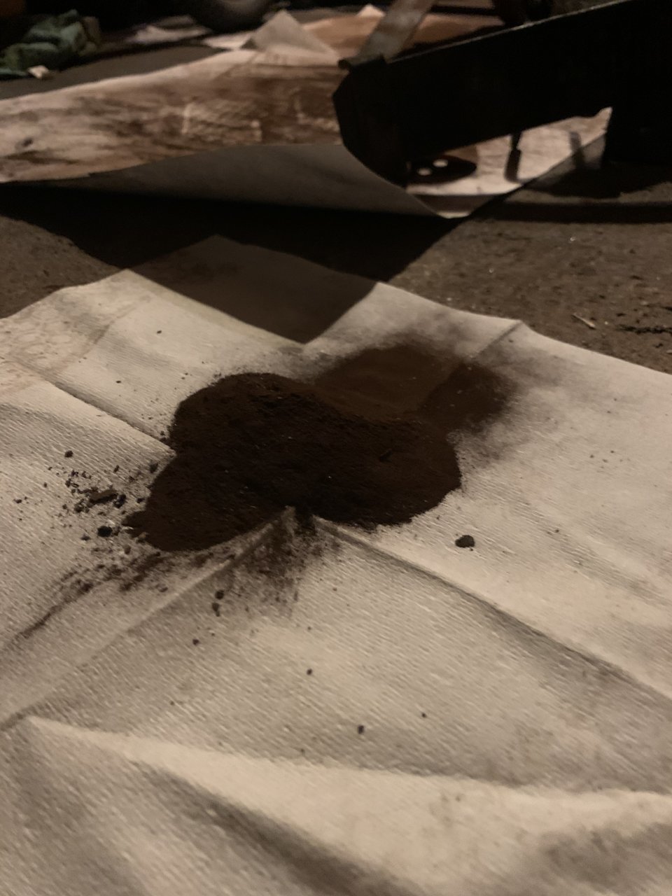

    Ha. I noticed a difference right away in mine after driving it. It’s a huge project though and takes forever. I sand off so much rust. Ended up doing it by hand because the rust cloud was too much. :rofl:
    This was from one spring.
