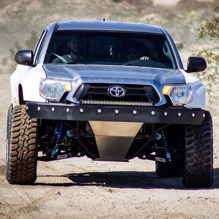

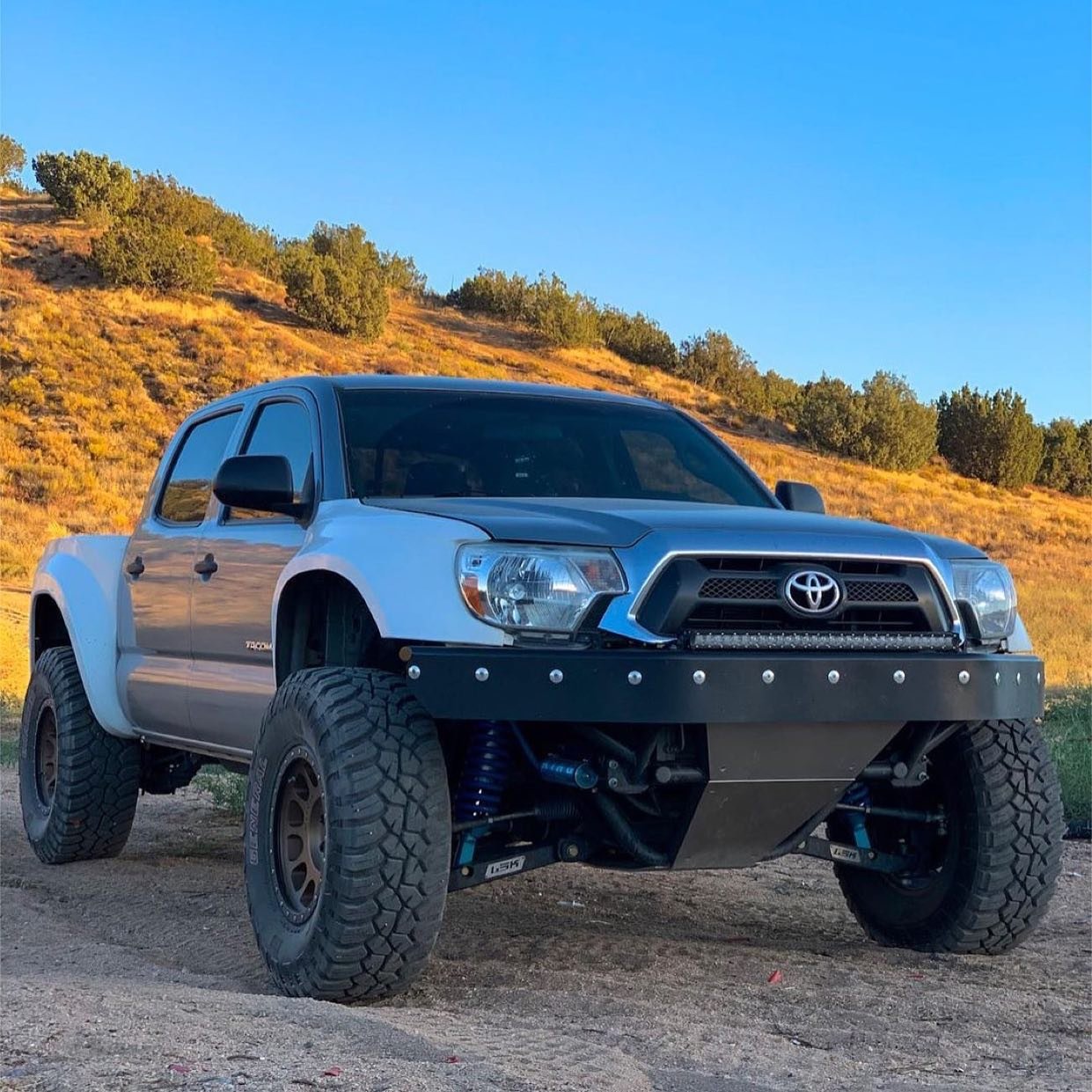

    So.... I've got this Prerunner build that I need to get moving on. I'm thinking of making a dedicated build thread for it once I get some decent pics, etc but I figured I'd start having the conversation.
    2013 Prerunner (2wd) with a DK LT kit up front, basically stock in the rear. It's got all of the proper gussets up front to include DK double shear & spindle gussets. Also has the MC LCA gusset kit already installed.
    I've got McNeil 4" front & rear glass on order for it already and bypasses for the front. My plan is to fit the glass and then build a tube bumper that fits the truck. Been eyeballing some ideas and leaning towards something similar to the below. Something relatively simple yet clean. Interested in thoughts or options.
