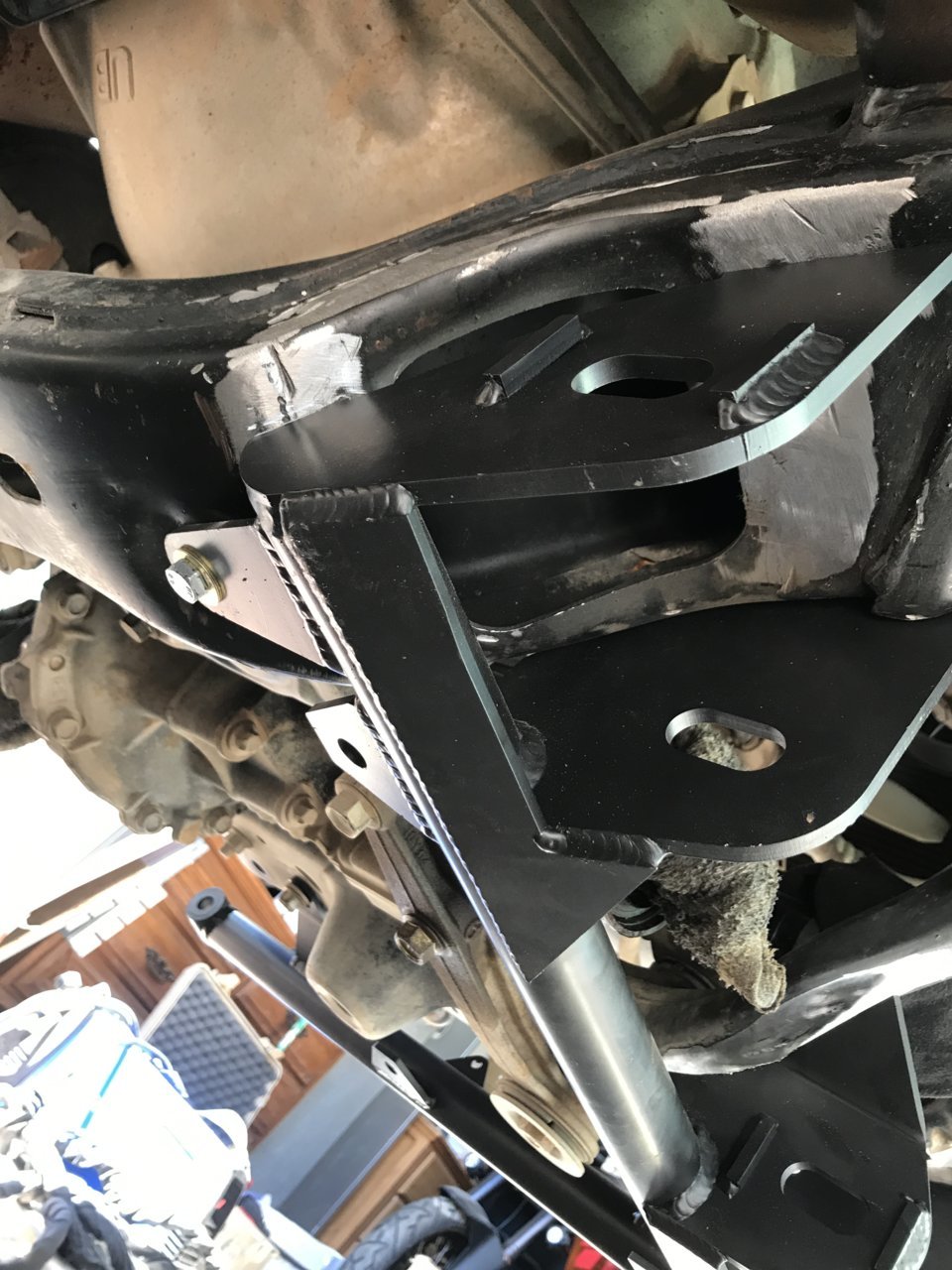

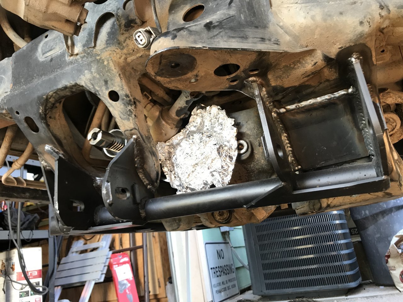

    Mid install pics and installed pics mainly.

    Found some. 827B7091-330D-446C-A73C-5D0AADFACE95.jpgDA8FD551-7F56-43C5-B104-D513AD4E74A4.jpgF8059D19-713E-4DF7-8D1A-4BF98AEB120E.jpg

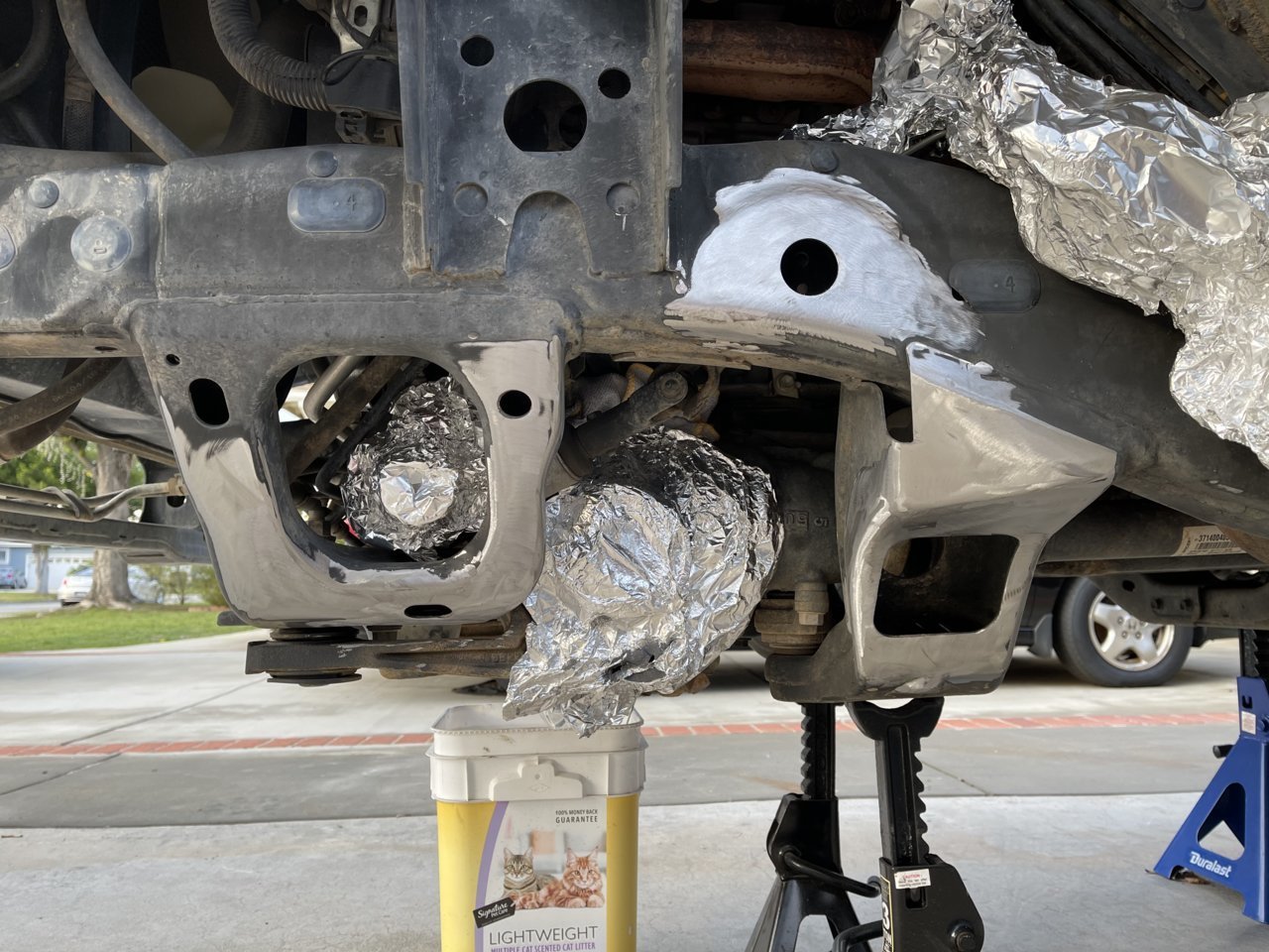

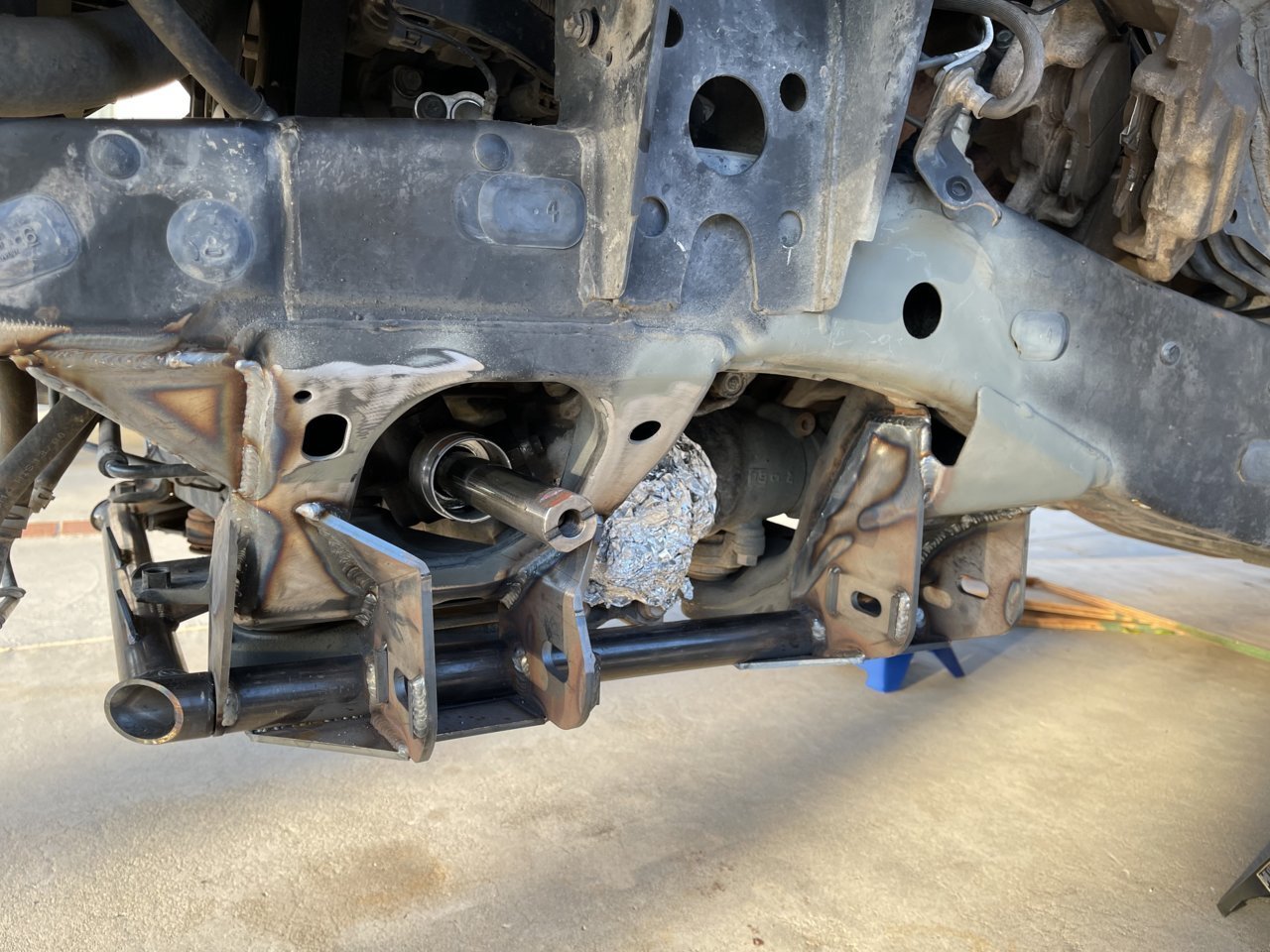

    I do as well. I just didnt take a ton of photos when @snowsk8air2 was welding it on.

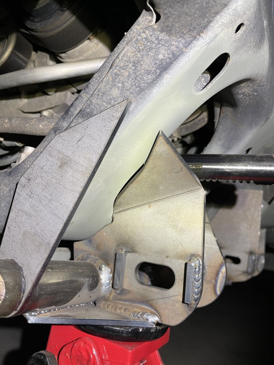

    I’ve installed a few sets of the jd subframe. It’s a nice kit, once you’re happy with the alignment they have a setting bolt to lock the alignment in.
    Thay said for my personal truck I have just gussets the crap out of the stock mounts. Similar to what dirt designs offers. Been beating the crap out of mine for years without issue. I’m sure if 454 is gonna gusset the stock mounts and then solid mount the alignment the you’ll be fine. Just saw those stock non-gusseted lca mounts in the first post and thought I’d chime in haha

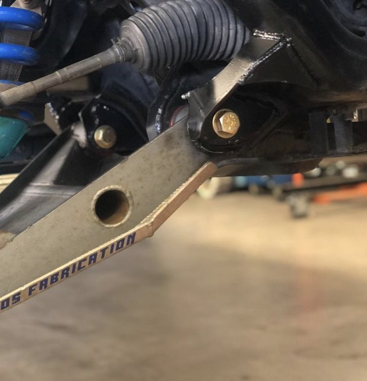

    I had the dirt designs reinforcement and the Quixotic cam delete (they are beefy) done a few years back and still going strong and I feel like Ive pushed the truck pretty hard since, I sheared a lower spindle bolt a while back LOL, the JD is probably the end all bullet proof reinforcement mod
