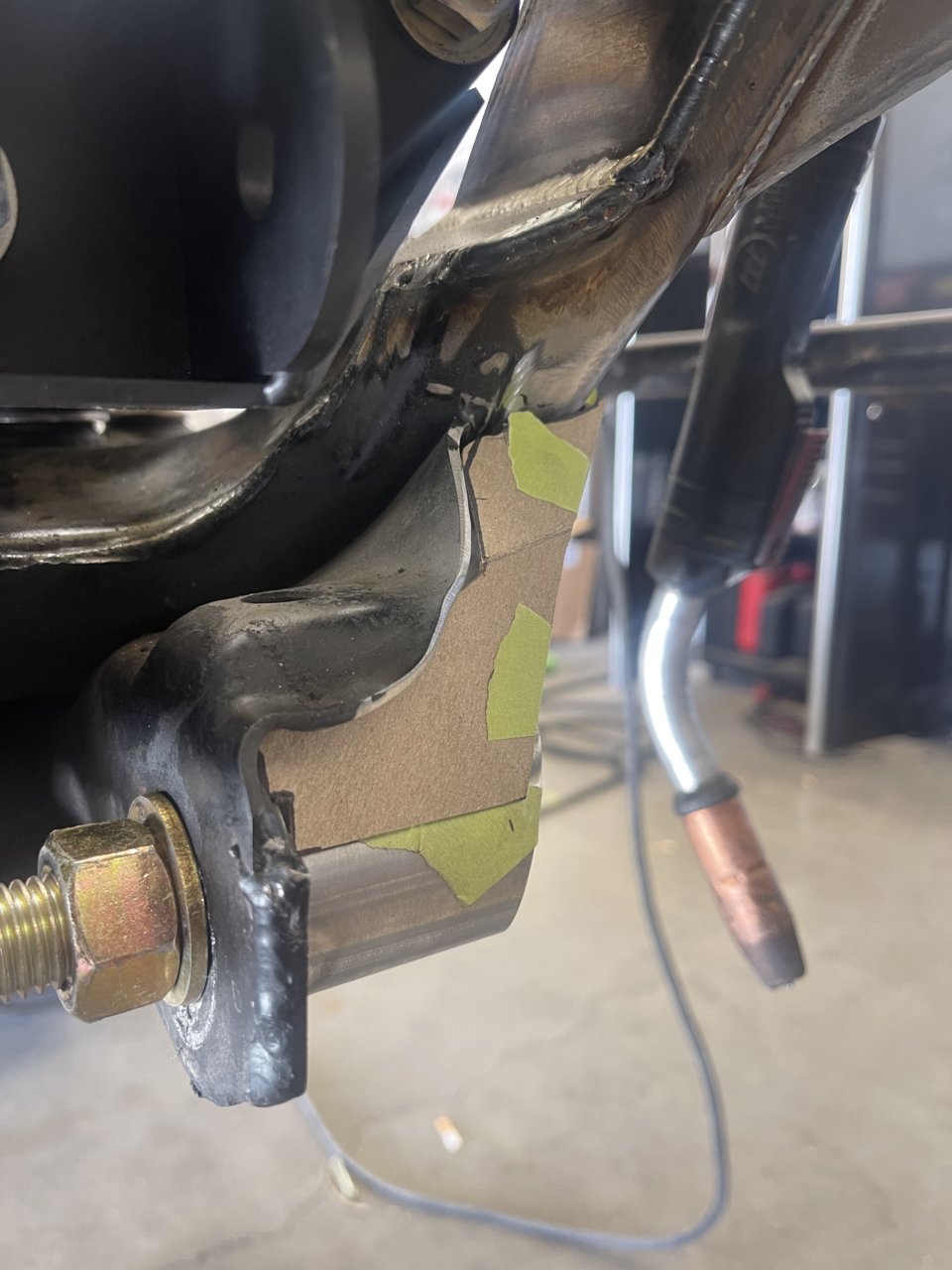

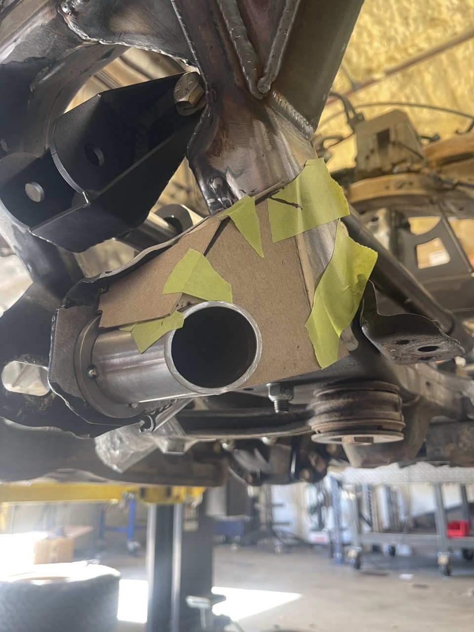

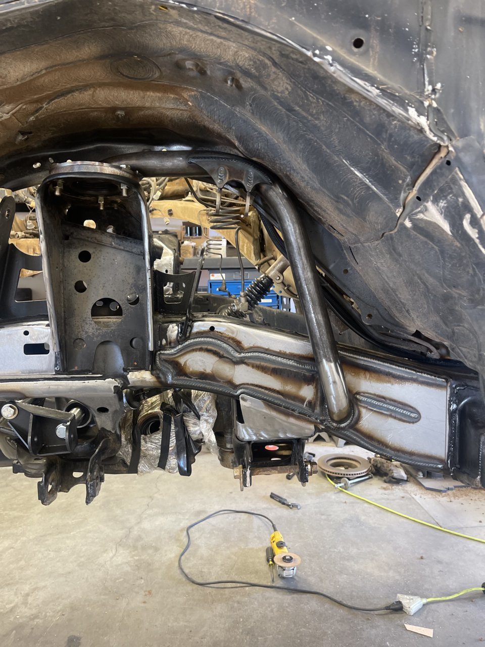

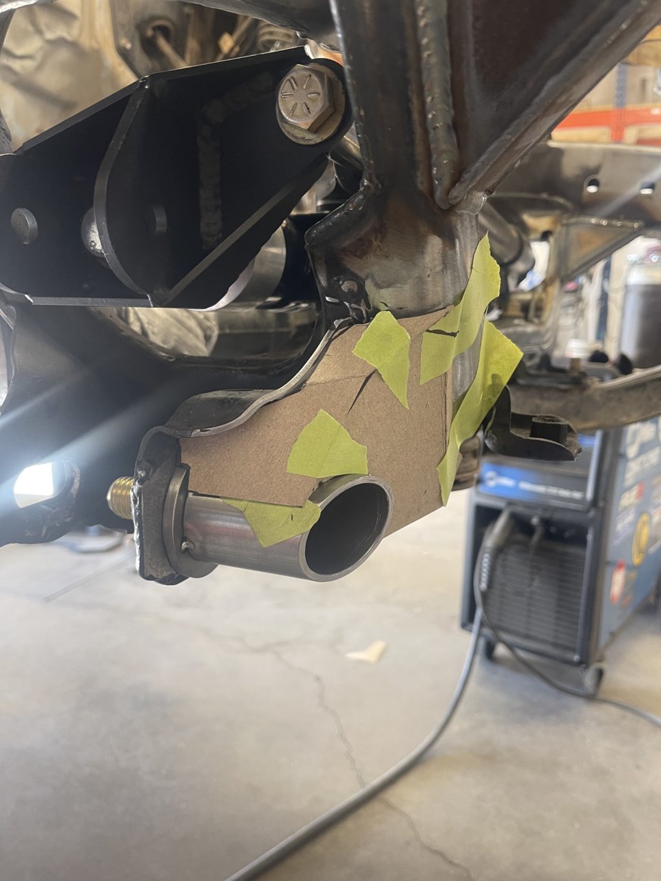

    Dirt King frame plating kit is on, as well as the BTF bypass hoops. Also attached are the pics of the gussets 454 came up with. They look really stout to me. I’m happy with how they’re turning out, and if I bend or break them I’ll come back and say I was wrong and you told me so.
    I push the truck hard, might jump it a time or two, but I don’t think my typical use will break these.
    BMiller421, Tbasch, not_nick and 3 others like this.

    Yeah that will do for sure. Way more than I’ve got for mine and mine have held up to all of my abuse.
    Tbasch and Pittsy[QUOTED] like this.

    Hey Guys,
    Just thought Id chime in here.
    Have 0 issues with the JD subframe. Super nice piece for sure and alot easier install than the gusseting being done currently. 2 main reasons I/ we didnt go that route.
    1) Timeframe - truck is already here, torn apart. Didnt want to wait for the subframe to ship and get here in order to be able to start mounting and cycling the kit.
    2) I really wanted to completely get rid of the slotted holes for the alignment on the lowers. Kit we are installing gets aligned from the UCA. My thought process is the LCA cant get knocked out of alignment at all if theres not a slotted hole for it to move in. Also as a side note, by getting rid of the alignment cams in here, the LCA will have a 3/4"-16 bolt in the front pivot and a 5/8"-18 (iirc) bolt in the rear pivot. Both of which will be gr8 and properly shanked.
    Would have been nice to replace the stock LCA pivots with 1/4" steel but Im pretty confident that the route we are going will hold up. If im wrong then ill chop it all off (including subframe as my guess is that will be FUBAR too) and do it again with JDs subframe or some other option.
