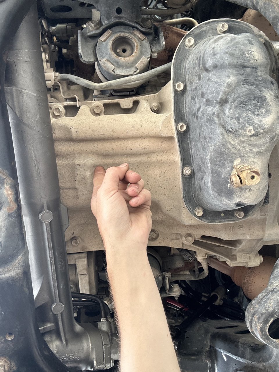

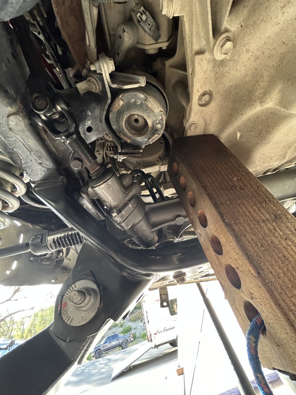

    Engine mount time. This part scares me a bit. Got some MarTec mounts with some spacers in case I need them to clear my tundra rack which now sits against the engine.
    Best way to lift up the engine?
    this seems like a decent spot for the driver side.
    Maybe the middle of the upper pan with a solid 2x4 ?
    Anyone in SoCal who has done motor mounts and would be willing to lend a hand?
    don’t know why, supporting a loose engine off of a jack sketches me out more than doing almost anything else on the truck

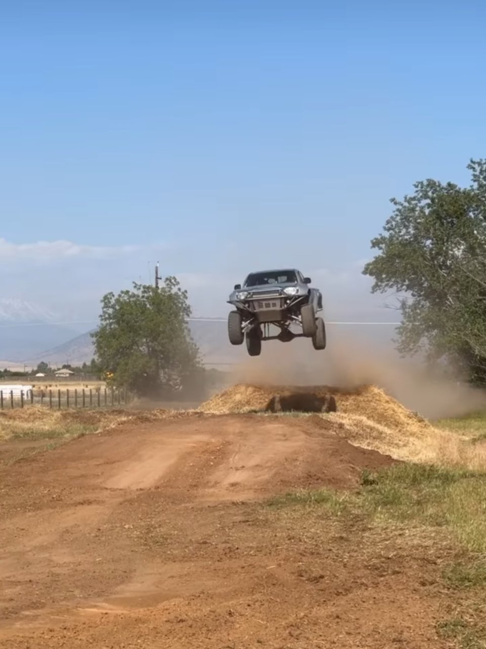

    MOTHER OF GOD!
    TrailBoss Goes Beast mode!

    Yep - I've had 2 done for $150 and $175 with upgraded viton seals and it's 5 min from my place. 1-3 day turnaround.
    You can put a flat piece of plywood on top of the 4x4 to distribute the force a little, but that should be ok.
    Just replacing the engine side bolt in motor mounts or are you replacing the perches as well? Bolt-on stuff isn't too bad if you have a bunch of wobble tip extensions and maybe an electric ratchet, but not necessary on the ratchet. Loosening up the trans mount will help as well - watch for any stretching wires / trans shifter linkages.

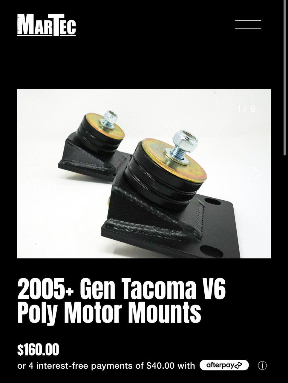

    Both sides with these aftermarket ones:

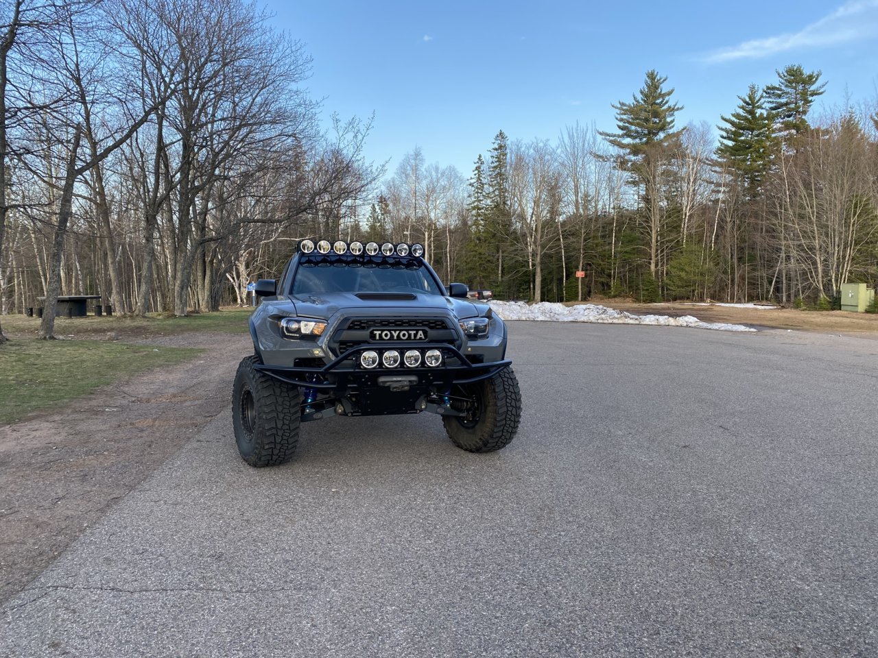

    Drove my truck yesterday
