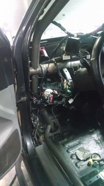

    Nope you could probably kick that and bend it, the A pillar tubes of your cage will go down through the floor and tie into the frame then your new dash bar will tie into those.
    Here is a pic of @906taco 's cage, you should check out his build thread he has a ton of pics of his recent cage build.

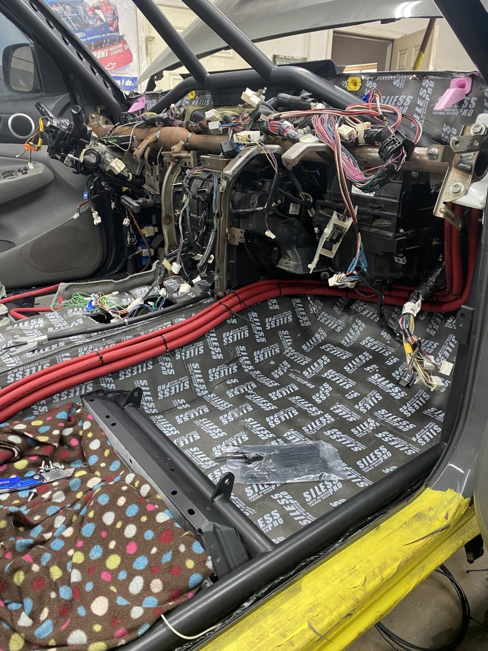

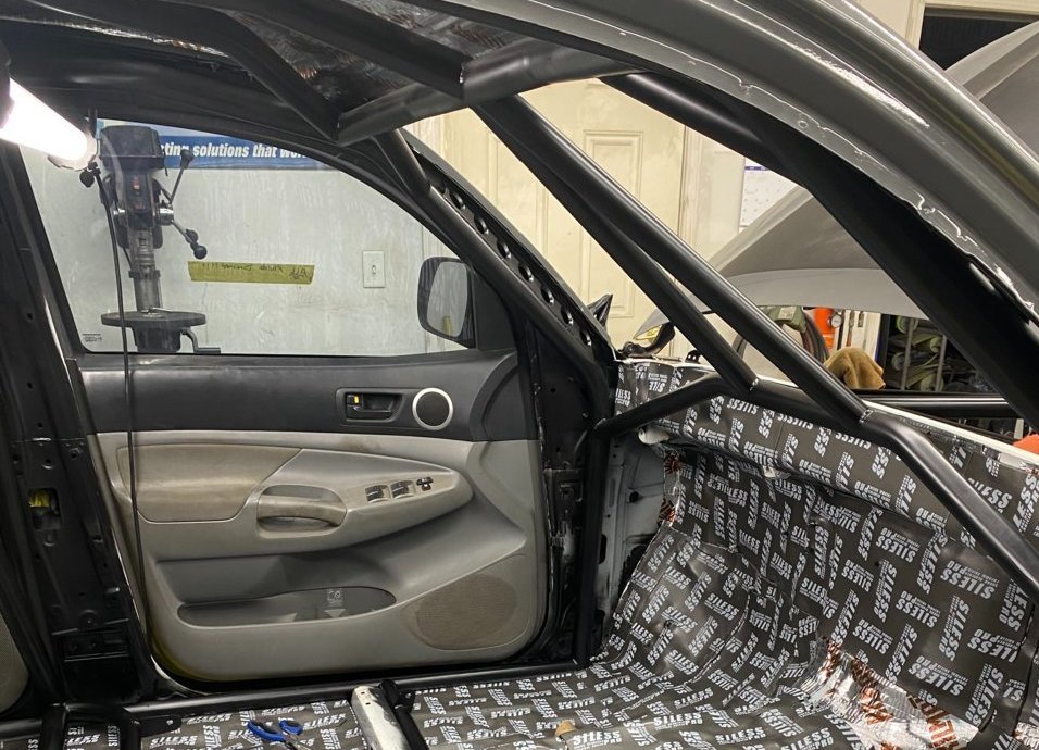

    I did mine in a way that still utilizes the factory dash bar and didn’t lose a single vent or HVAC function. But it was very labor intensive to do so.

    2000 Tacoma SC 2.7 4x4 5spd

    They are. And yes it’s big shit.

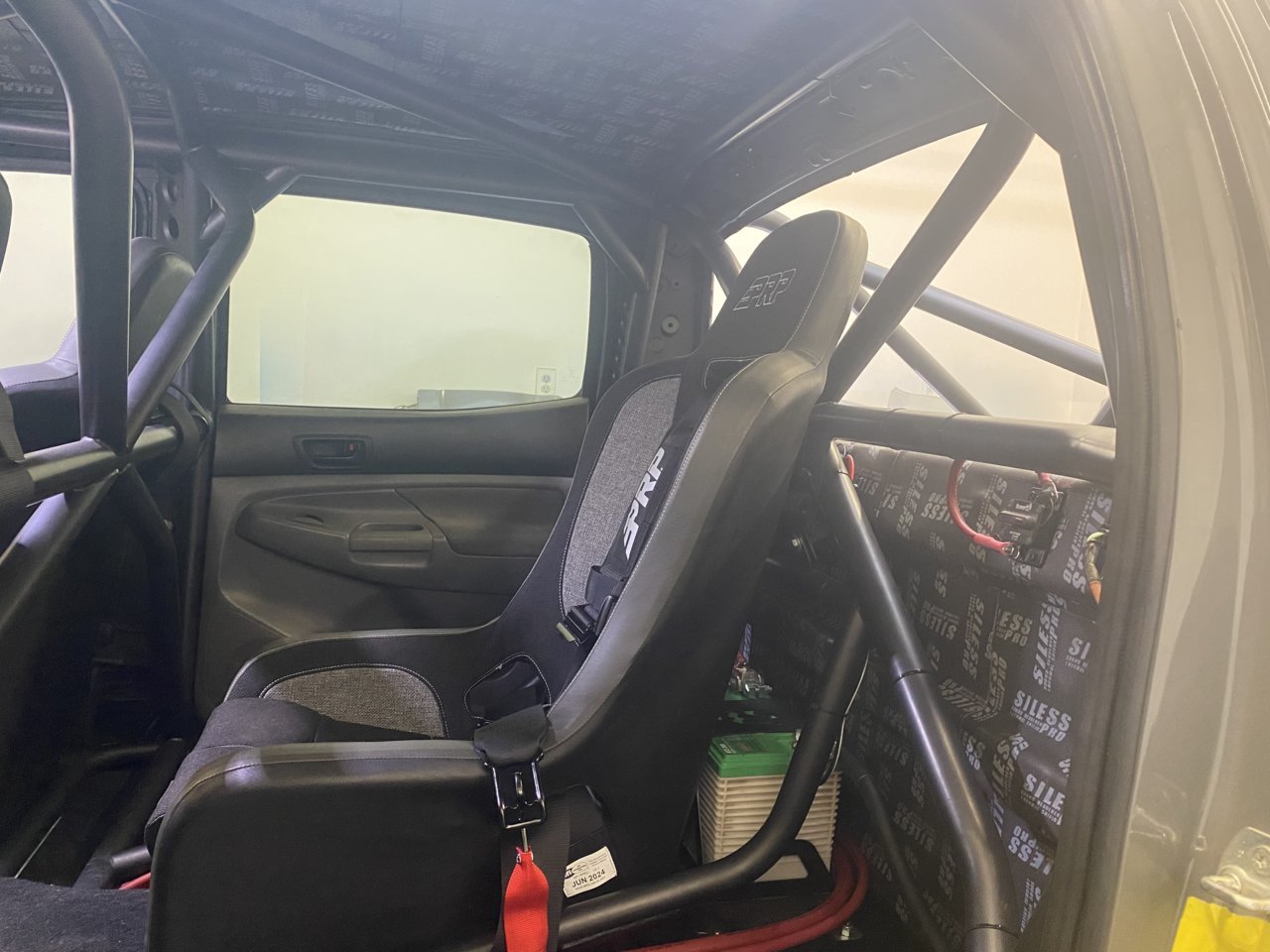

    is your battery in the cab? or in the bed?
  11. May 24, 2023 at 5:06 PM
    906taco
    906taco Well-Known Member
    Jun 22, 2021
    #369289
    3,903
    Cory
    08 Taco
    Behind the 3rd seat.
