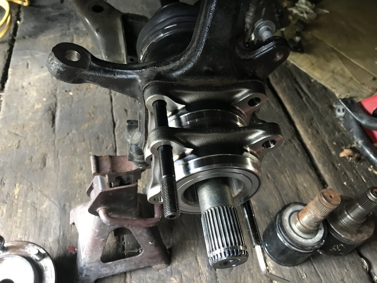

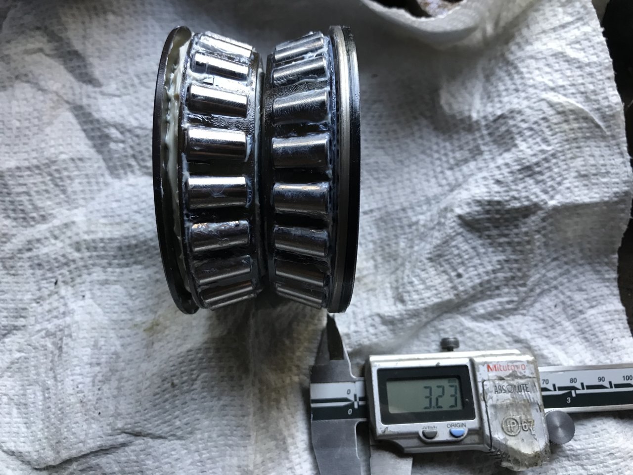

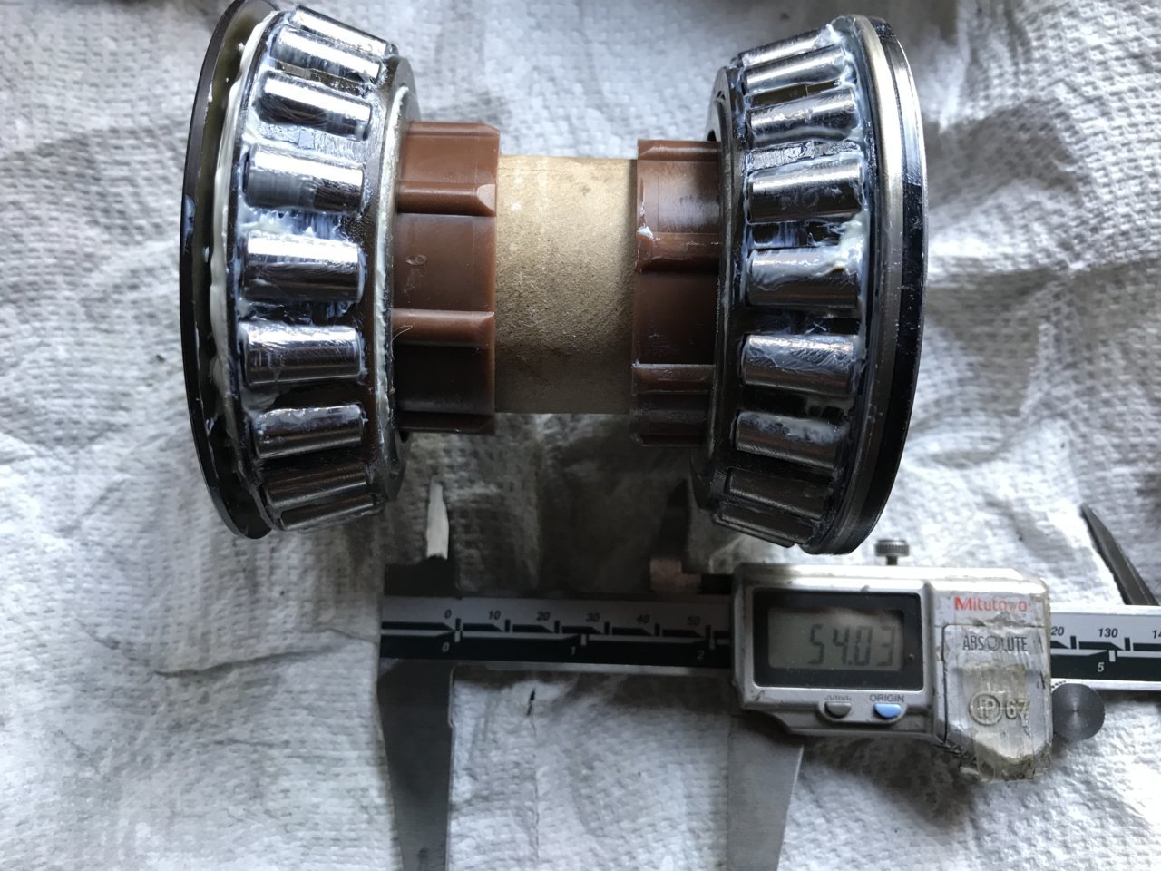

    Did someone mention bearing separation? Working on a kooky double wide unit bearing, separation will increase from roughly 3mm to 54mm. Custom hub required, but already have a CV Joint. Wheel offsets will need to change. Just something I’m throwing around…. don’t know if anything will come of it.
