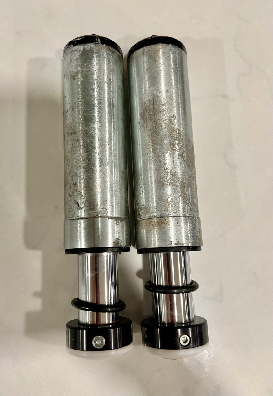

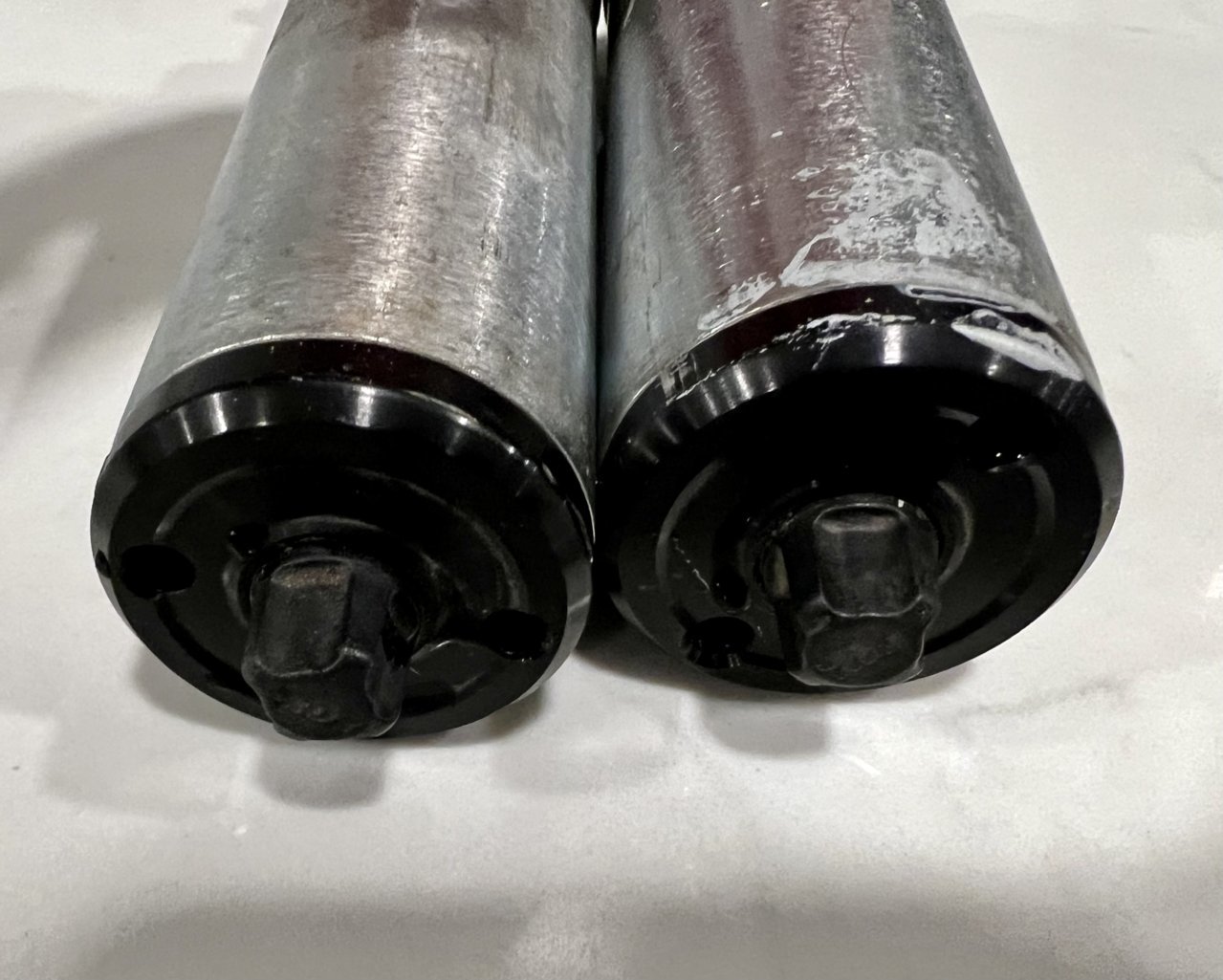

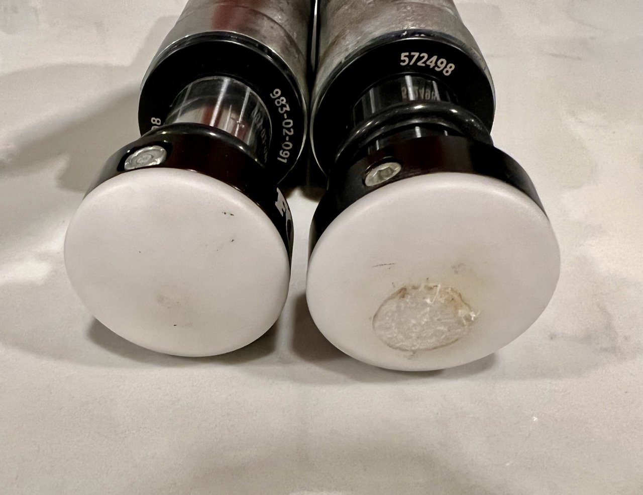

    SOLD Anyone need some Fox 2.0x2.0 bumps? Unsure of condition internally. Pulled to do 4” bumps on a new to me bouncer. $250 shipped

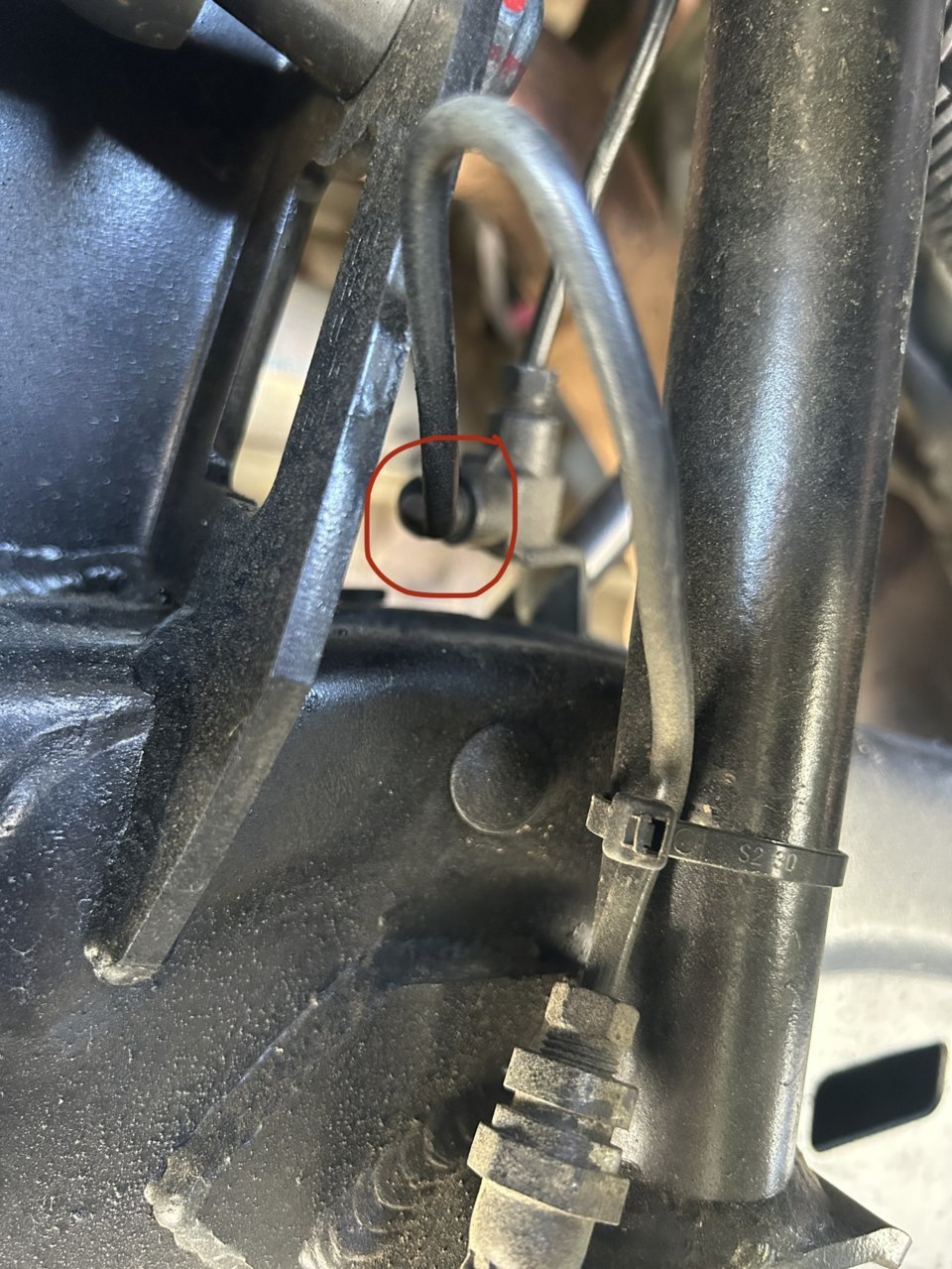

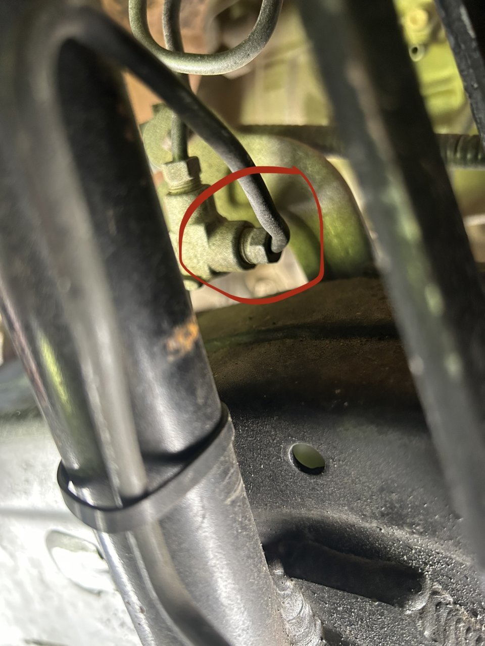

    Figure someone in here may know what type / size of fittings the front brake lines will be. I want to replace the had line on the frame side and caliper side with braided hose.
    They look like a standard fitting like the one that’s on the for existing soft lines and calipers…

    M10x1.0

    Yeah you just need an inverted flare adapter
