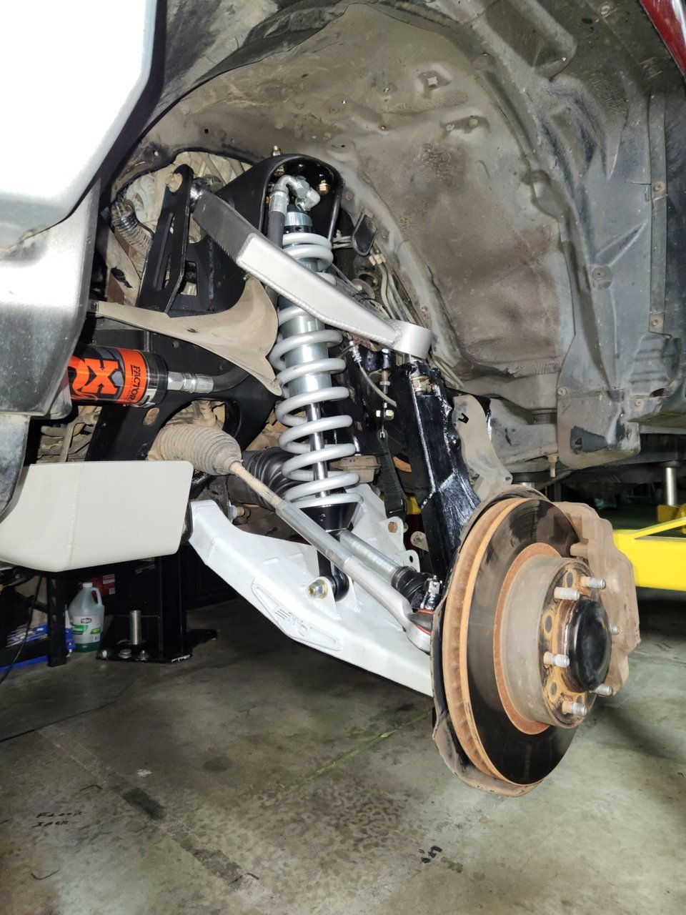

    As stated, valving is a crucial part to ride quality. Another is spring rate. What rate are you running? I've noticed that the wider kits tend to allow a softer spring rate or less preload. Obviously the motion ration plays a huge factor in this but I'm going to go down from the 600lbs springs I had on the DK 3.5" kit. Was way too stiff with the 600s. At least what little road driving I did with it.

    With the Stock valving from camburg, when I got my Foxs through them and their kit, I could feel every crack in the road, but it’s soaked up to speed bumps, and did great off-road. I just thought that’s how it was, and to a certain extent if you were running just a coil over, you have to make a compromise to handle bigger whoops.
    I somewhat recently got secondary bypasses, and even with the tubes all the way open, it was still extremely stiff. Like I couldn’t bottoms the truck with medium roughness driving since I pretty much doubled the shock and oil volume in the suspension set up.
    I got my coilovers revalved by a local guy in orange county, Onyx Shocks, as they needed a rebuild anyhow after a few years of daily driver and offroad duties.
    I told him that I felt my suspension was now a bit stiff overall with my recent addition of bypasses, as the coilovers were originally valved to work alone.
    I don’t know everything he did, but he said he lightened the valving and put a flutter stack in… the front suspension now works better and is more comfy on and off road than it has ever been.
    With a background in ”pro” motocross, I knew how suspension was supposed to work, but didn’t really understand what needed or could be changed inside the shocks. But tuning is everything, and off-road driving no matter what vehicle urine is the pinnacle for that.

    We’ve talked a lot about spring rates in this thread of late, and from hearing it, ive been drawn to the conclusion that there’s more than one way to skin that cat. When I was at Jd fab for SUA we took most of the preload off the 18x500s to get it level up front. Sure, it has more body roll but for a truck I want to float and take some hits, it doesn’t bother me. I want it to be soft and not interfere much on compression. That’s where I want the shock to take control, correct? And if it’s blowing through travel too fast, it could be fixed by either changing the compression stack or tuning the bump zone? That’s the way I’ve been looking at running a softer sprung suspension setup.
    clearly that’s not the only way to do it, given that @snowsk8air2 ’s truck works just fine with stiffer springs. I don’t know the secret sauce him and Tyler at ADS cooked up for that to work, but perhaps they took most of the compression valving out and are tuning the heck out of the rebound? :notsure: The point is, whatever springs ya got, they have to work together with the shock and travel to achieve the desired results. We’ll see if my setup is too soft in a few weeks at the flagstaff meet. :mudding:

    Definitely different ways to achieve shock tuning goals. Maybe I’m ignorant to some things as well as I never have tried a longer and softer spring other than what little we’ve messed with on @Sixthelement truck. And all this spring weight talk I went back and looked at weights. My truck is pretty front heavy. Only about 50lbs lighter than his truck and he’s got a 12klb winch up there. All I knew when ordering my shocks from dirt king was that I was running a 650lb coil on mid travel and didn’t want to go back down to the 600lb they usually come with. So I opted for the 700lb spring not knowing much about tuning or being able to achieve desired ride height with a lighter but longer spring. That said I do feel it’s the right spring for me considering I’m just shy of cool bind with as much preload as I am running to maintain my ride height. As for valving, it’s a lot less secretive than what Brian and I came up with to make things work with just the coil over. But with the coil over and bypass now, coil is 10/10, bypass is a fuckton of 20 and then 10 on rebound.

    To add to that. We had originally tried a 18” 600lb spring and it was too much. Even under the little pre load to get it loaded on the CO. We swapped to a 16” 650lb No preload, and it’s been working awesome. Granted every truck is different. Oh and last weight my truck was 3260 steer axle. For an idea.

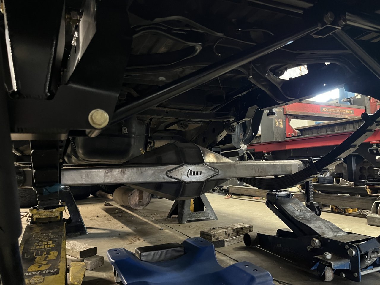

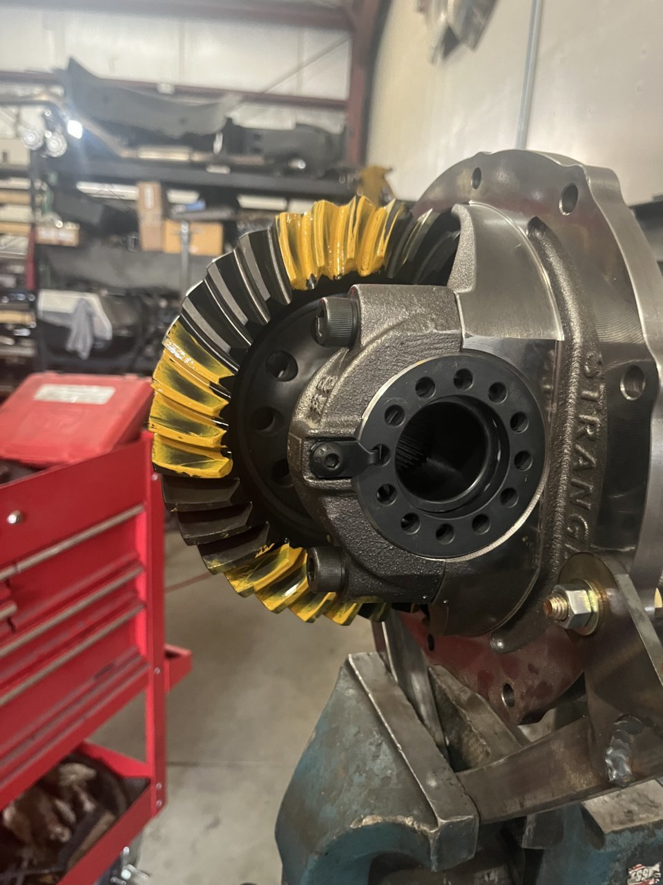

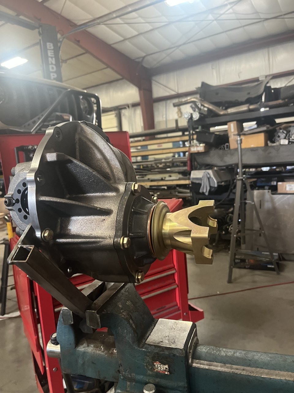

    I’m not sure on all the specifics of the internals yet. Once I get more specific information I will let you know. I’m kinda dumb with this stuff. I have lots to learn still but so far I went with 4.86 and a spool

    love my camburg 9". i went with a arb air locker with 5.29 nitros from ecgs.
