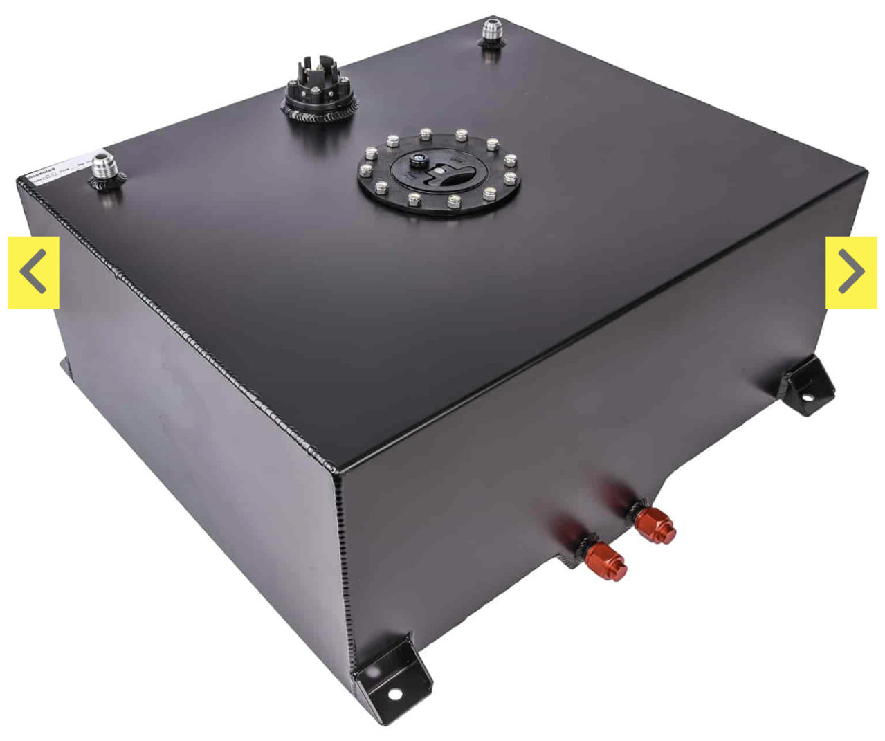

    I was debating this except the price is what’s holding me back at the moment and trying to figure out if the 20 gallon fuel cell I have now would work in that exact location.
    It’s a simple 20 gallon cell, depth of 10 inches and the deepest part of the sump is 11.5. 20x24 inches so it’ll fit in between the rails in the same fashion. Run a line from the sump to a y tap ill installed on the filler neck and in between that I’ll have a pump wired so it can push fuel on command. Install a breather and a roll over check valve, run a ground strap from it to the frame for OCD precautionary measure.
