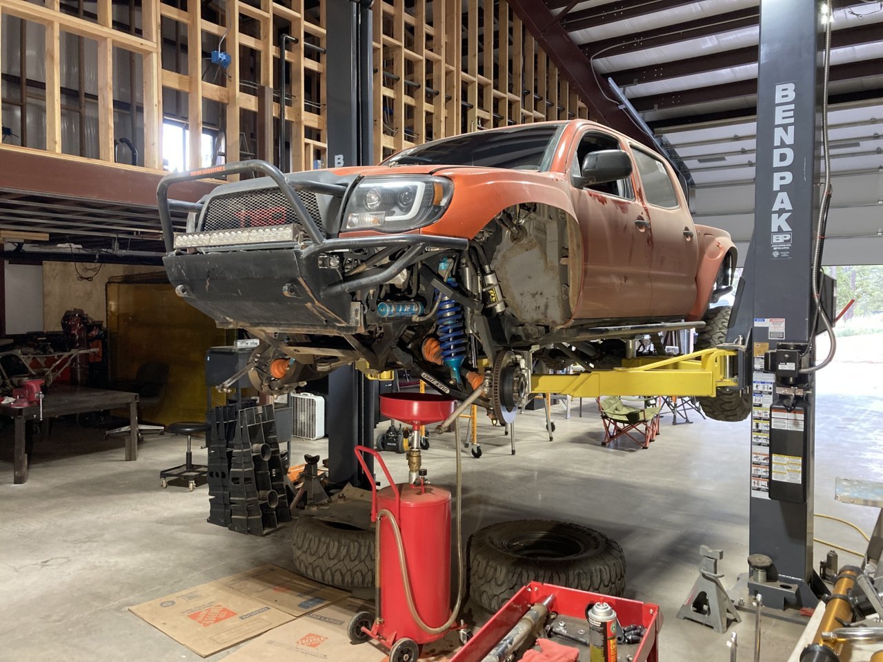

    Spoiled myself and went to the race shop to swap in a new steering rack and use the lift. Should not have done that. Jack stands are for peasants and now I need to figure out how to just move my tools over there and pay rent lol.

    yeah my buddies parents had a small shop behind their house and we put a lift in it and got to use it for like 2 years before they sold the house...saddest day ever was moving my tools out of that shop.

    Yeah they’re buying tools like crazy right now before his dad retires. Trying to up the capabilities of the shop for their racing endeavors. Mill, lathe, and cnc plasma were recently purchased. I’ll need to start practicing with those lol. Only thing is I like my welder better than theirs. But shop is around the corner from my house. Gonna talk about what fees they want to charge for me to use the shop for side jobs. It’s already been established that none of the friends will get charged to work on personal stuff but myself and one other buddy do side work out of our garages periodically
