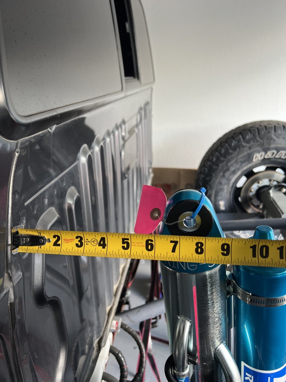

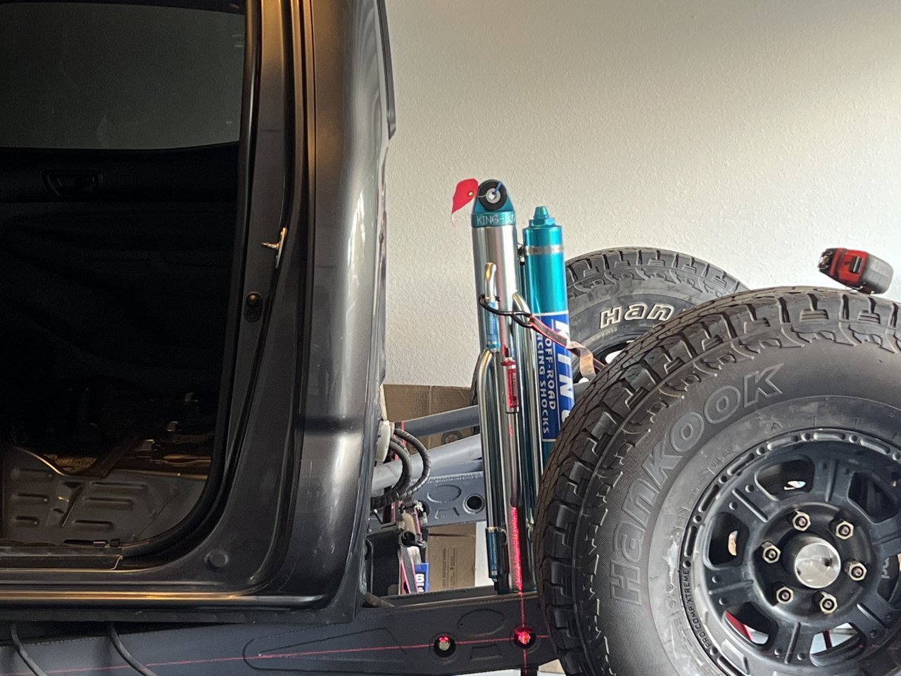

    Front suspension: Work in progress JD Fab +4 LT, LCA pivot kit, steering slide rack, 934CVs Rear suspension: Archive Garage shock relocation and SUA Conversion,King 14x2.5 shocks, King 2x2 hydro bumps, FN wheels 5 stars, sliders
    Things are going to get real tight and fun to deal with. Still need 2-3 inches of up travel. Still also really thinking of moving the pivots 5 inches forward too. Coilovers will probably be just inside of the back wall, bypasses will are looking to be right under and outside the window.

    What's with the cables entering the bottom of the cab?
  13. Aug 19, 2023 at 8:07 PM
    Dalandser
    Dalandser ¡Me Gustan Las Tacos-mas!
    Feb 19, 2015
    #149090
    17,673
    Anthony
    Downey
    08 PreRunner Regular Cab / 98 4x4 Extra Cab
    Empty Wallet Mod
    Power and plumbing for his massaging captains chair w/ latrine

    They were my quick and dirty rear battery relocation pathway. Grommet bulkheads to pass the cables through. Forgot to get a smaller one for the smaller cable to my accessories. Used an insulated cable fitting for outdoor electrical lol. It’s going to get ripped out and done differently. Probably through the cab.
