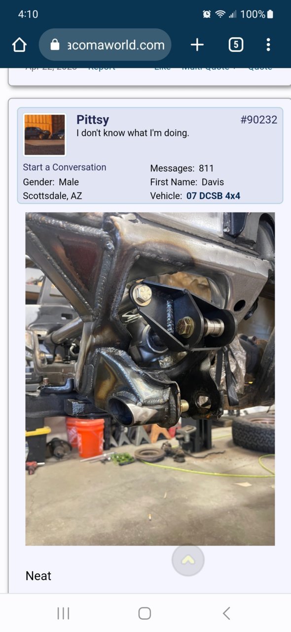

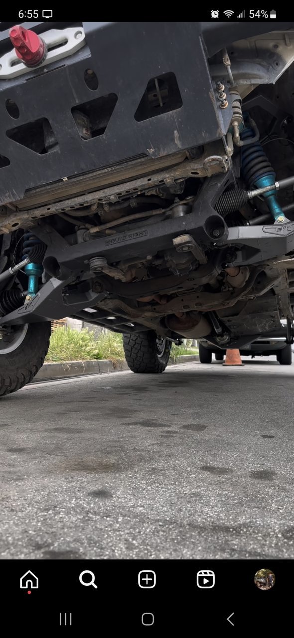

    Anyone see this front crossmember/lca kit before? I thought I saw something similar somewhere on here awhile back, cant remember

    never seen that before it looks like a one off custom done by The Truck Shop. Built Right is their in house brand. You’re probably thinking of the JD Fab LCA pivot kit

    Nah, finally found it

    454 out of (now) Arizona did that and it’s all just gussets on the stock mounts. The Built Right is the Truck Shop like @Evenflow said and looks like they removed the front cross member to replace with their own fabbed cross member.

    The picture is a 4 runner, it was also modified to use a land cruiser rack, yes it was a one off from Built Right or The Truck shop. May be going this route for my Tacoma.
