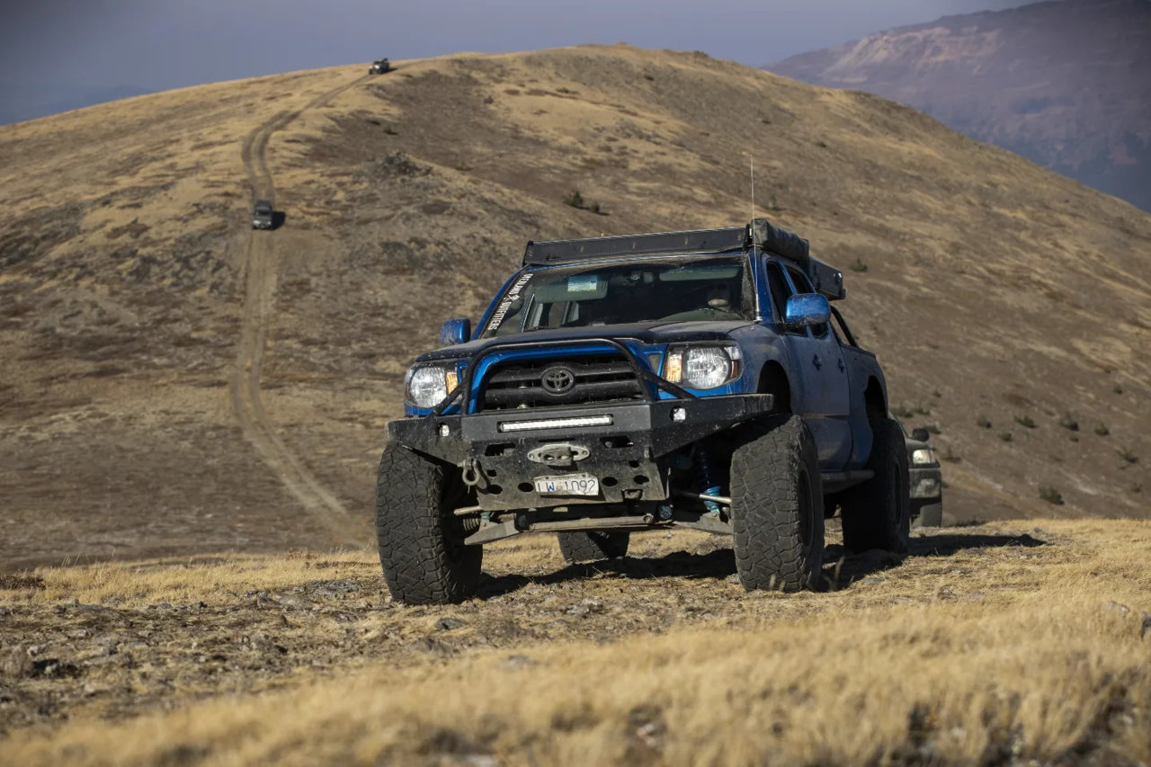

    4+ kit. 16x8 -12/4.00 backspacing. No rub around town with a CMC, but might have to trim glass with 35s in the dirt. Full stuff probably hits inner fenders. Back has 1.25 spydertrax.

    Your front bumper keeps growing on me every time that I see a picture of it.

    If that's a coastal offroad, they look good on 3rd gen 4runners like the one in this photo and they're economical in kit form - almost bought one but repurposed something I had on hand.

    @Dalandser called it. It’s a coastal off-road weld-it-yourself kit. The kits are economical if you have the skills and tools. They are stitch welded. I opted for an aluminum kit. Only weighs 50 lbs. I’ve been digging it

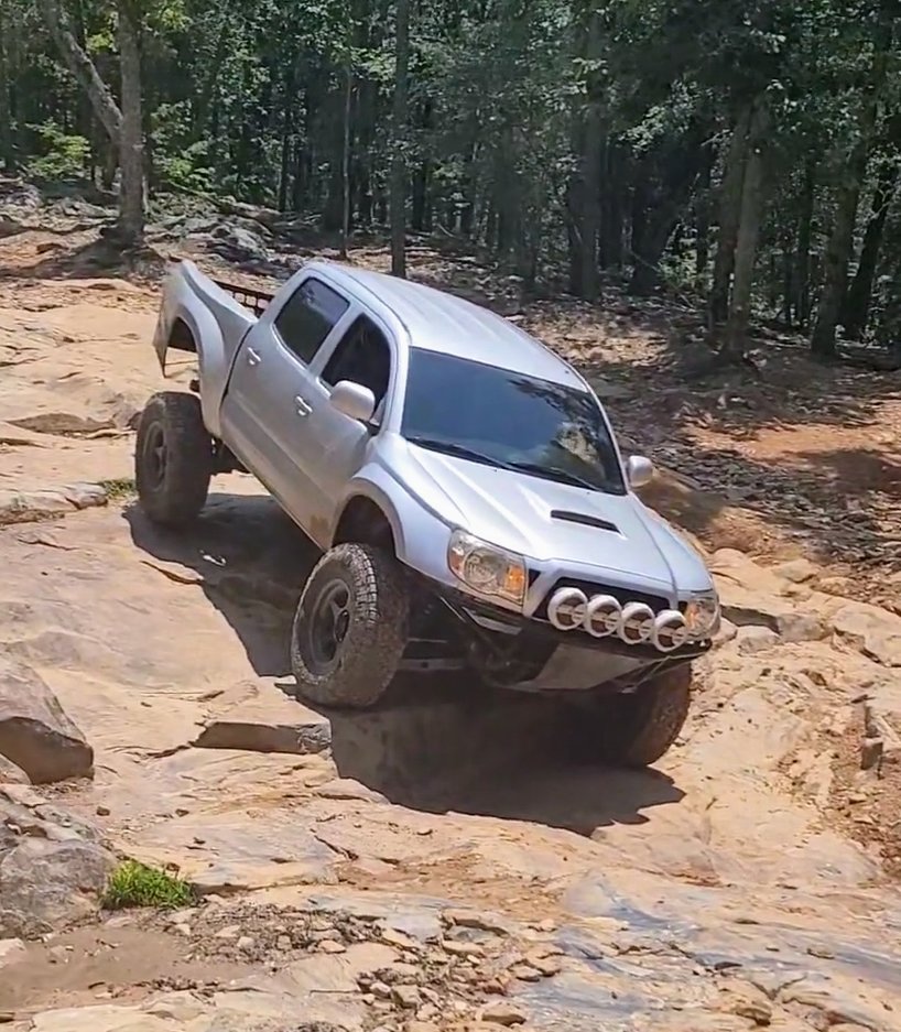

    Lt front/rear Jd fab…

    What are the bolts for on the truss along the axel? looks solid

    p clamps

    Hose/wire clamps?

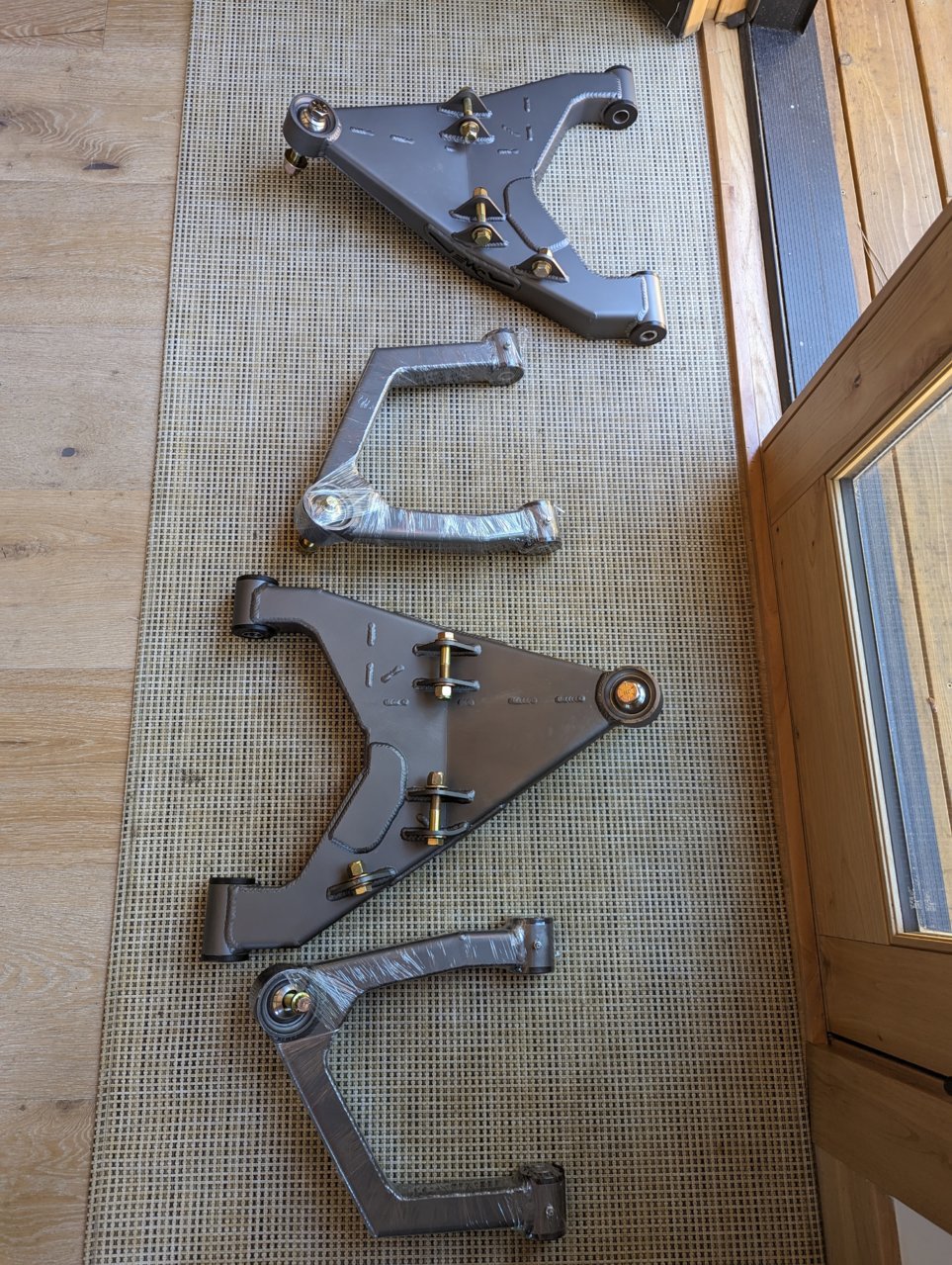

    It's heeeeeeerrrrrreeeee

    It’s still not too late to not go LT…
    Welcome to the darkside muhahaha
