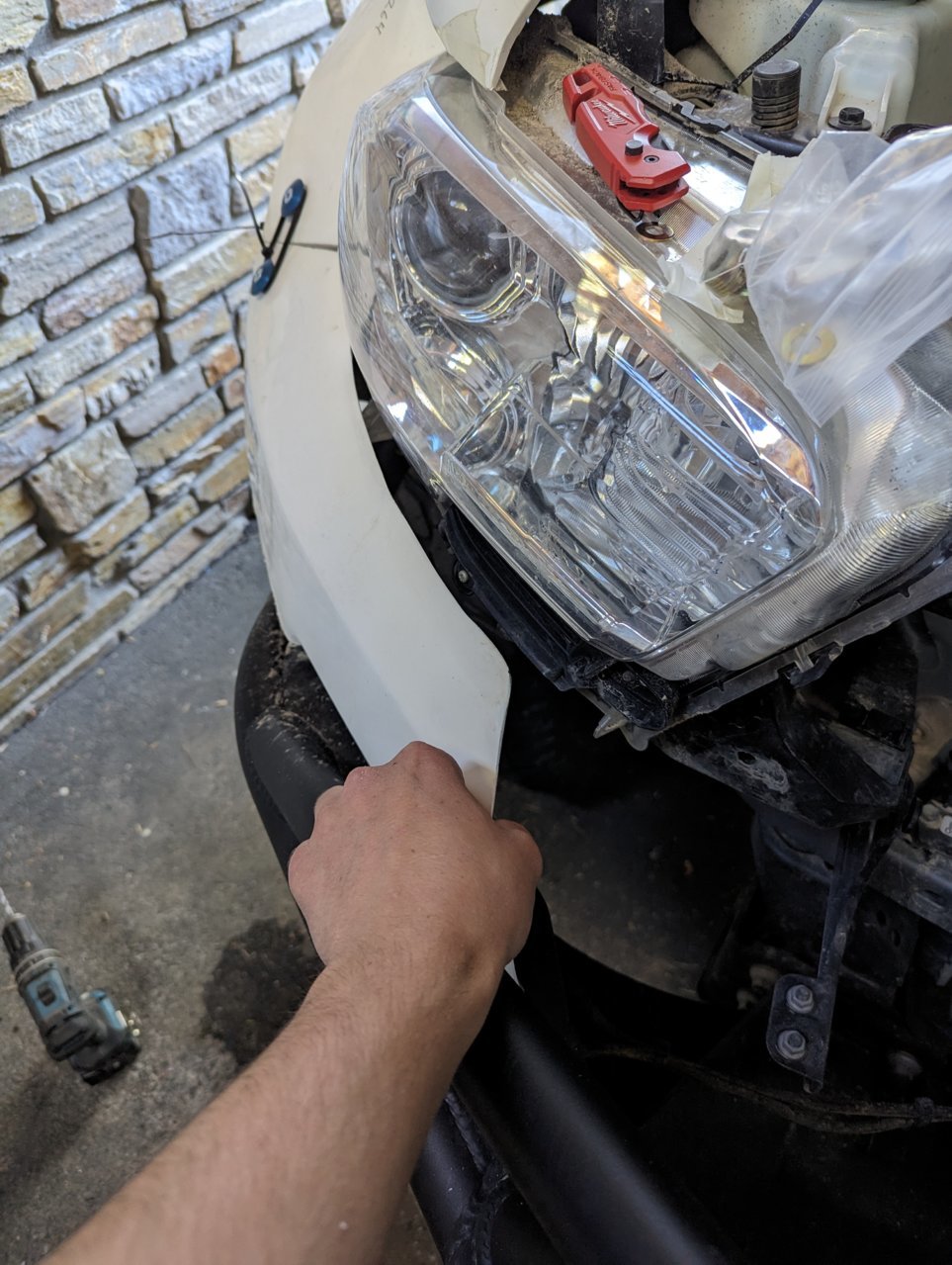

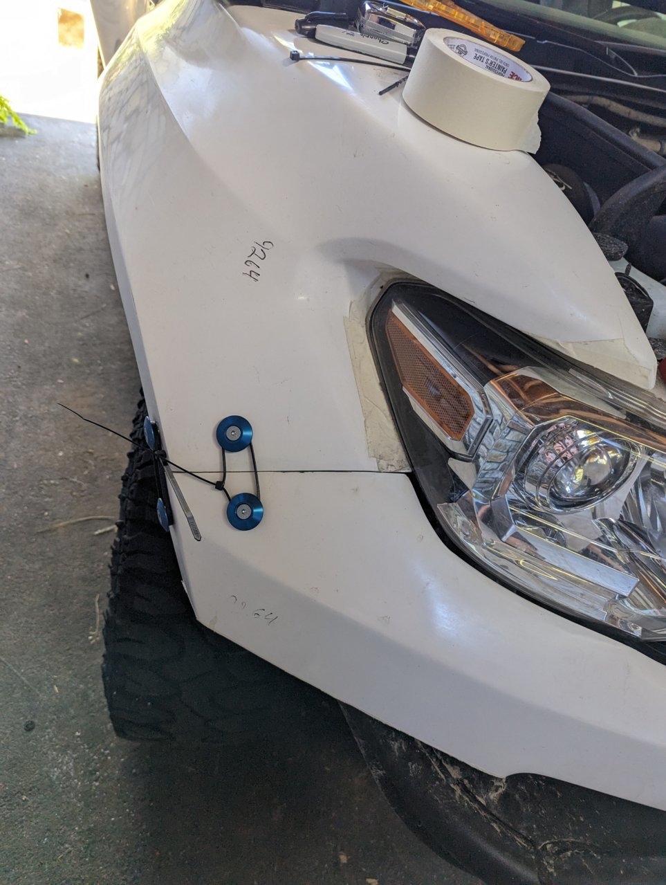

    I finally got bigger tires 2020 Long Travel Tacoma 1997 MAGNUM
    I got 6 inch mcneil glass and for the front headlight trim piece in having a hard time figuring out how to mount the pieces. Any tips/suggestions?
