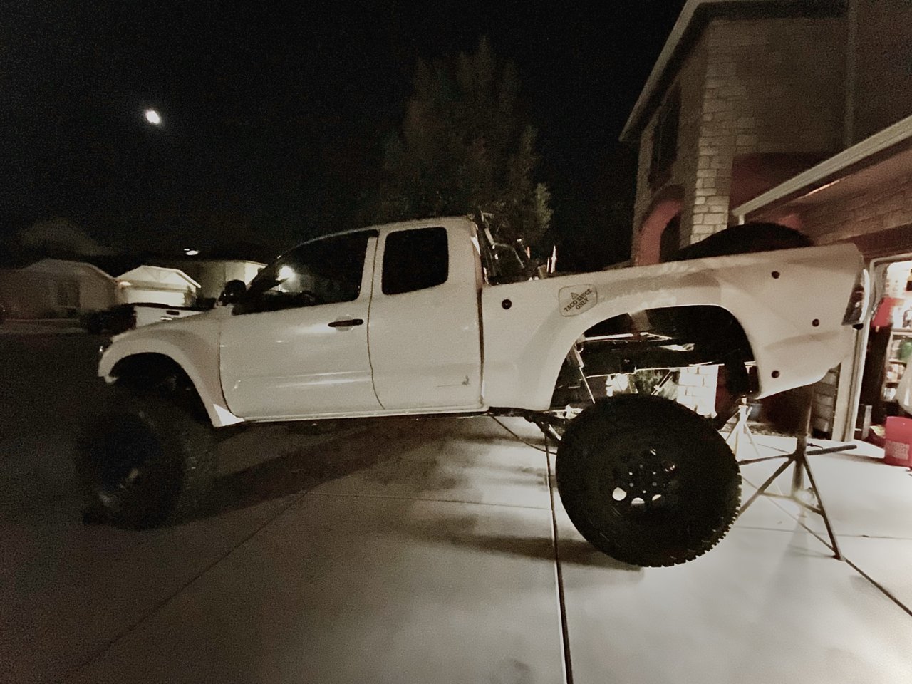

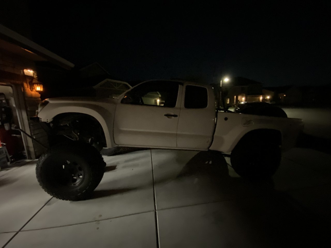

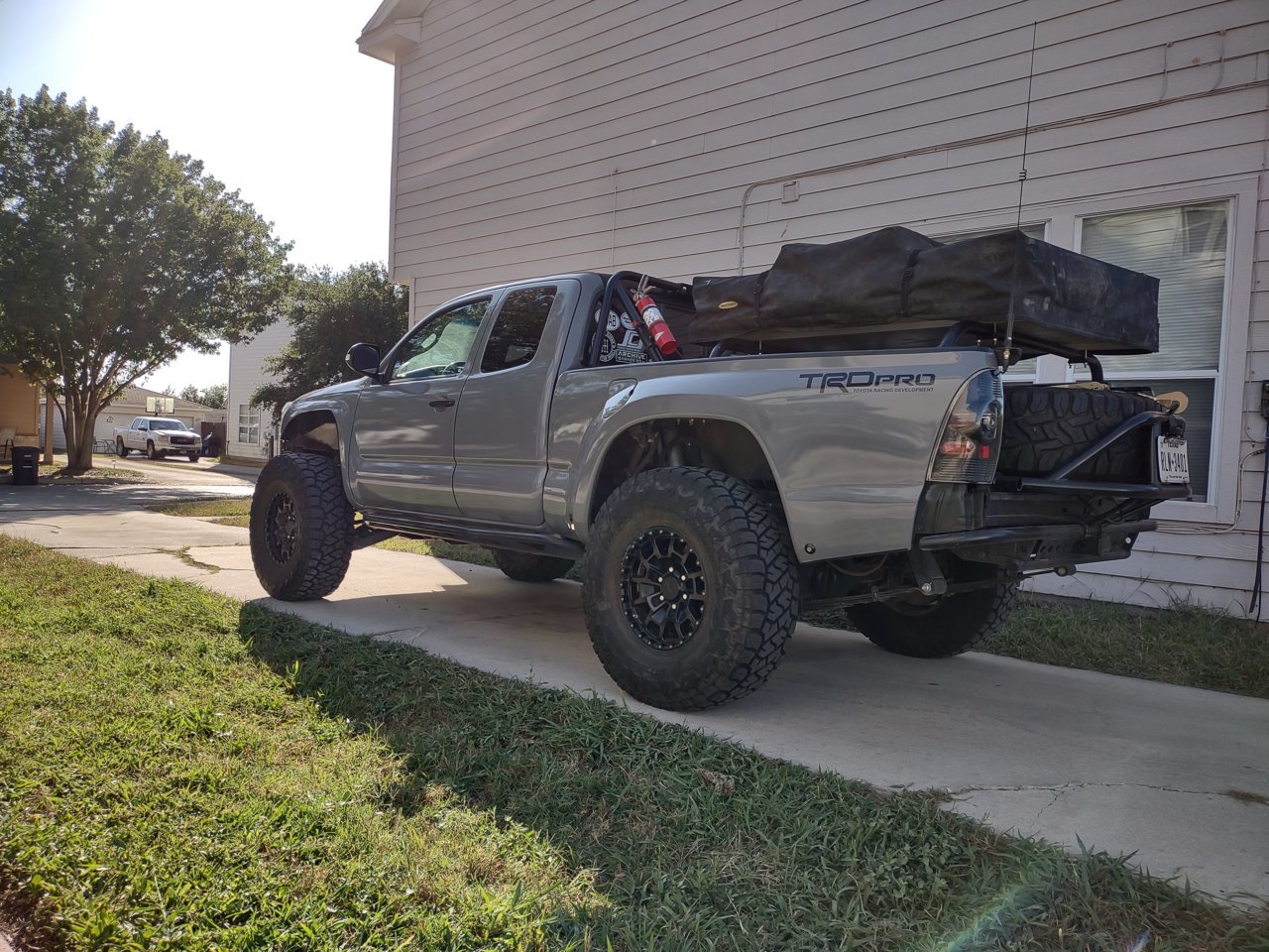

    This is how my truck sits with my RTT and camping gear along with a 35 spare. DMZ SUA just his regular leaf pack.

    Right around 6 inches. Usually sitting around 8 normally

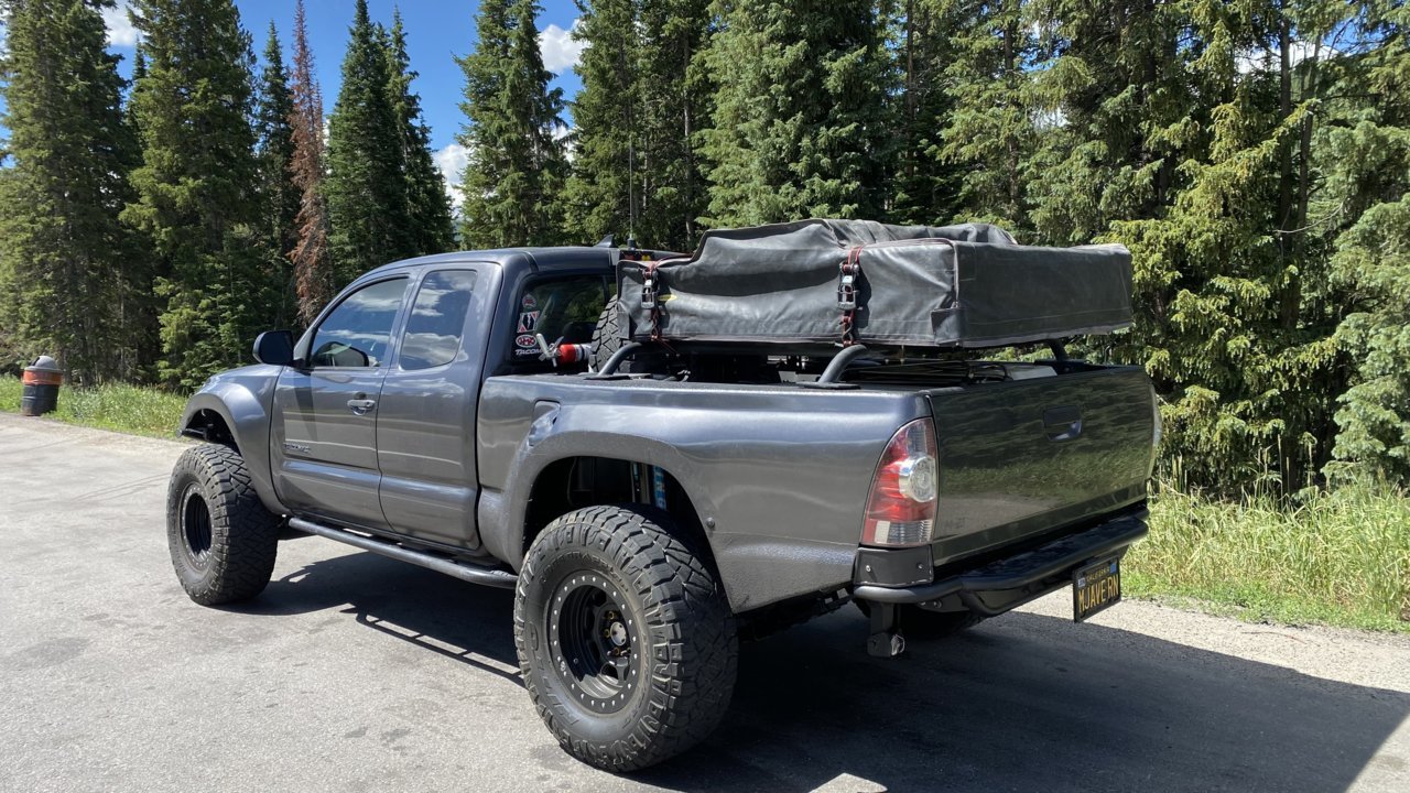

    I'll need to switch leaf packs. I have the H70 with an RTT and 37" spare. About 6" of up travel as well. JD spring under. Without the tent, it's perfect though.
