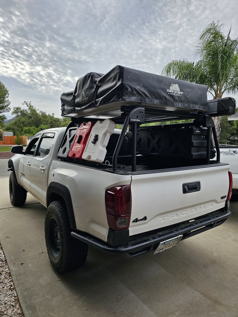

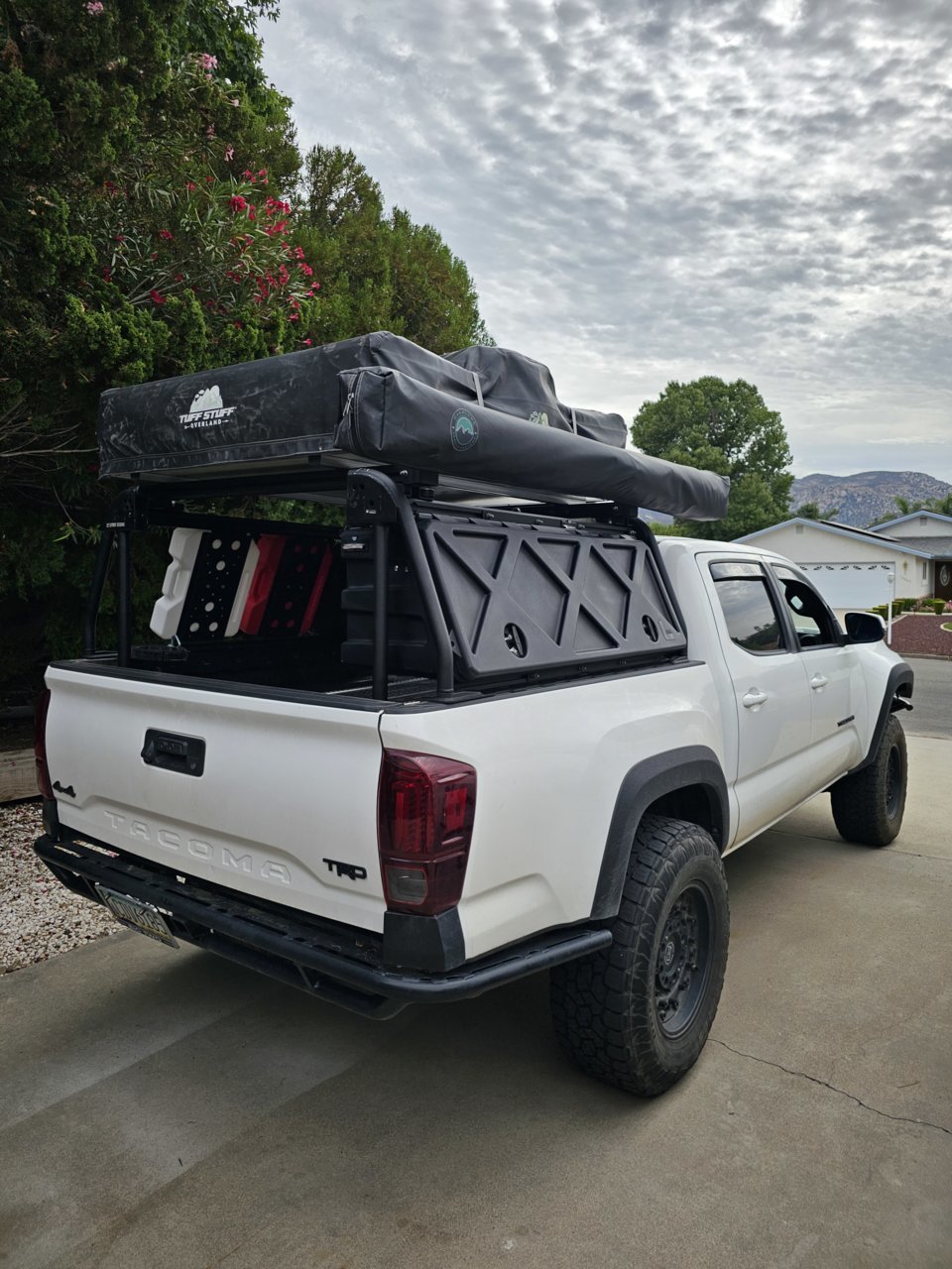

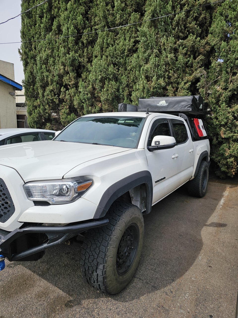

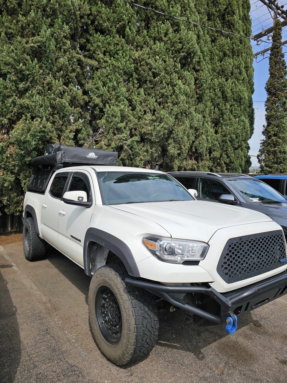

    Hammer hangers can do SUA with the right length shackle, but it's a stock length SUA, so all of the leaf springs mentioned so far would not fit.
    One thing nobody has mentioned yet is that, yes, you're carrying the same weight as many here, but your weight is very high on your truck which is going to give pretty bad handling. That tent way up high is going to give you a ton of body roll with SUA. Even with my RTT below cab height, I still wanted to put a sway bar on the back before I decided to go a different direction.

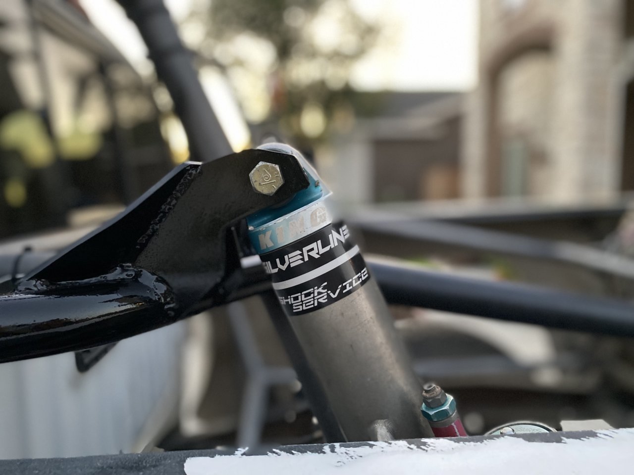

    everything working great! Next up I’ll notch the frame for the coil overs to finish stretching and cut these temporary shock mounts off for a real bed cage. They were just to get me to ATR since I did this in 3 days.
