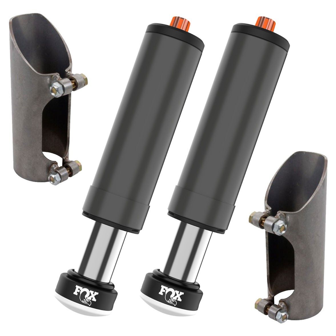

    Does the lip keep them from moving up? I thought they were adjustable and the pinch was all that was keeping them in place.

    I would have to tap in one of the other guys here with more experience than me to give you a for sure answer, but I bought screw adjustable ones because my understanding is they are supposed to be mounted on the lip.
    I figure with the force on them they would just slide up to the lip if you mount them lower, or if it is a smooth body just keep sliding.
    If you still have the pinch bumps that came out you could throw them in setup low of the lip then beat on it for a weekend and see if they slip.

    That definitely makes sense. All the pictures I see they are mounted at the lip. I thought I was going to get away with using the old mounts, but it ain’t looking good.

    I believe for most bumps that have the lip, they are designed to be installed ‘lip to lip’ with the bump can. I can’t see anything good happening with mounting the bump lower in the bump can and risking over torquing the pinch bolts. I don’t have any experience just a theory. The other risk I see is the bump moving up in the can from bottoming out forces and possibly causing damage to other components? Again, just a theory.
    Correct me if I am wrong but I believe King went away from the pinch bump can design to the pin/threaded top. Fox and a few other shock companies I see still have the pinch design.

    I don’t see it working out well for me. May crush the seals before enough torque is made to keep the bump from moving on big hits. That lip does a lot. Oh well, can’t blame a guy for trying to work less on his hobby haha
