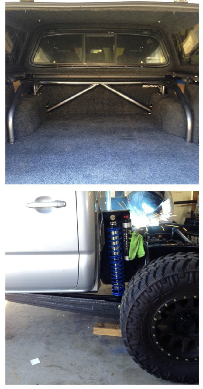

    My 3 link does not have the coil overs coming through the bed. The CO towers were built to exactly match the shape of the short bed wheel well and the bed cage bolts through the bed to the towers at two points ( 4 bolts each ) on each side.
    edit - of course this means you bump at the frame and with a 12” CO it cycles 20” bumped and strapped.

    Oh nice work. That’s pretty cool. I could probably get away with the bed cage (probably have to modify it a bit) and some holes in the bed.
    Mine is currently SUA and I was hoping to be able to reuse the bed cage and maybe initially the bypasses.
