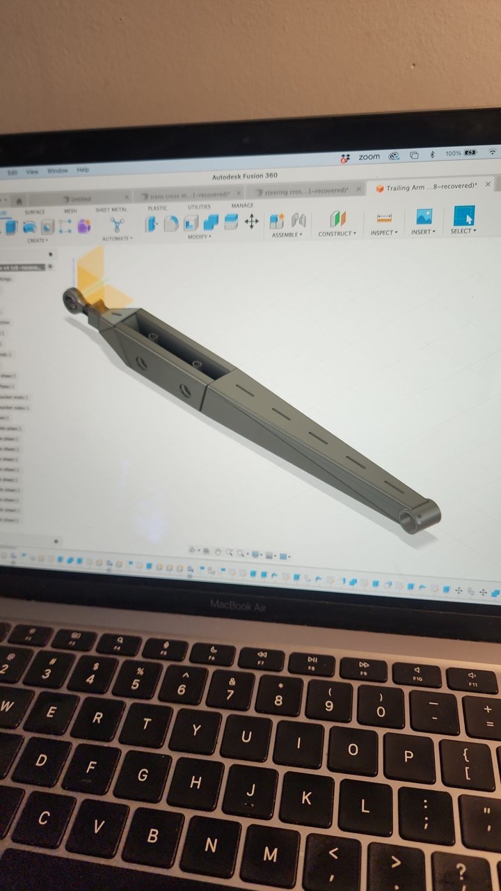

    This is my trailing arm design I've been working on. Shocks are pretty far back towards the axle cuz I'm trying to keep the wheelbase shorter without putting the shocks in the cab while the cab is moved back 2.5"

    Why are you doing your own? How much different would these be? RuffStuff URC Trailing Arms, Pair (ruffstuffspecialties.com)

    Because it's a good project to practice cad and I have a plasma table, plus I can make them the exact length and motion ratio I want, just for the price of steel. Plus it's just cool to do it all myself. I'll be designing and building a J-arm front setup next.
