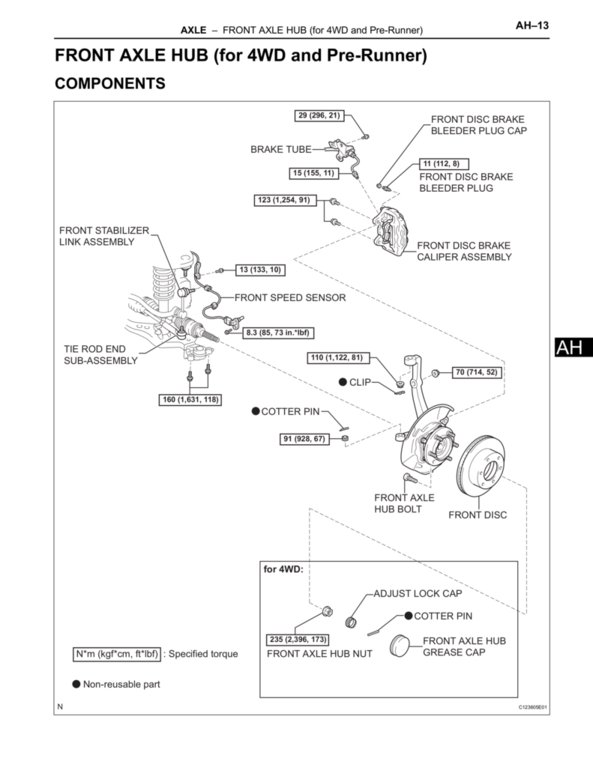

    Went to take off my driver side axle nut and was about to unbolt it when I realized it was hand tight. Should I be worried or nah

    Not if you're already taking it off. Just make sure it's torqued when you put it back on.

    Make sure nothing is wallowed out or galling/stripping threads. Also use anti seize when putting the nut back on. On very fine threads like those and with certain materials it's common for the metal to stick a bit and cause the nut to feel torqued before actually reaching the required clamping force. Could be the root cause of your issue

    Keep an eye on that wheel bearing now, might’ve caused some premature wear.

    Does loctite count as anti-seize? Lol I never want that nut to come loose and it’s supposed to be torqued to like 250ft/lbs or something. I’ve always done blue loctite and a handful of ugga duggas on the ole impact and called it good. And new cotter pins on that little crown nut cap thing every few uses.

    Lmao 173, it’s pretty easy to hit that number with a decent torque wrench.

    Coulda sworn it was over 200. Mine only goes to like 150 either way. And never had an issue with my method lol

    Maybe you saw the 235 and thought it was ft lb? That would make the most sense, that’s Nm though.

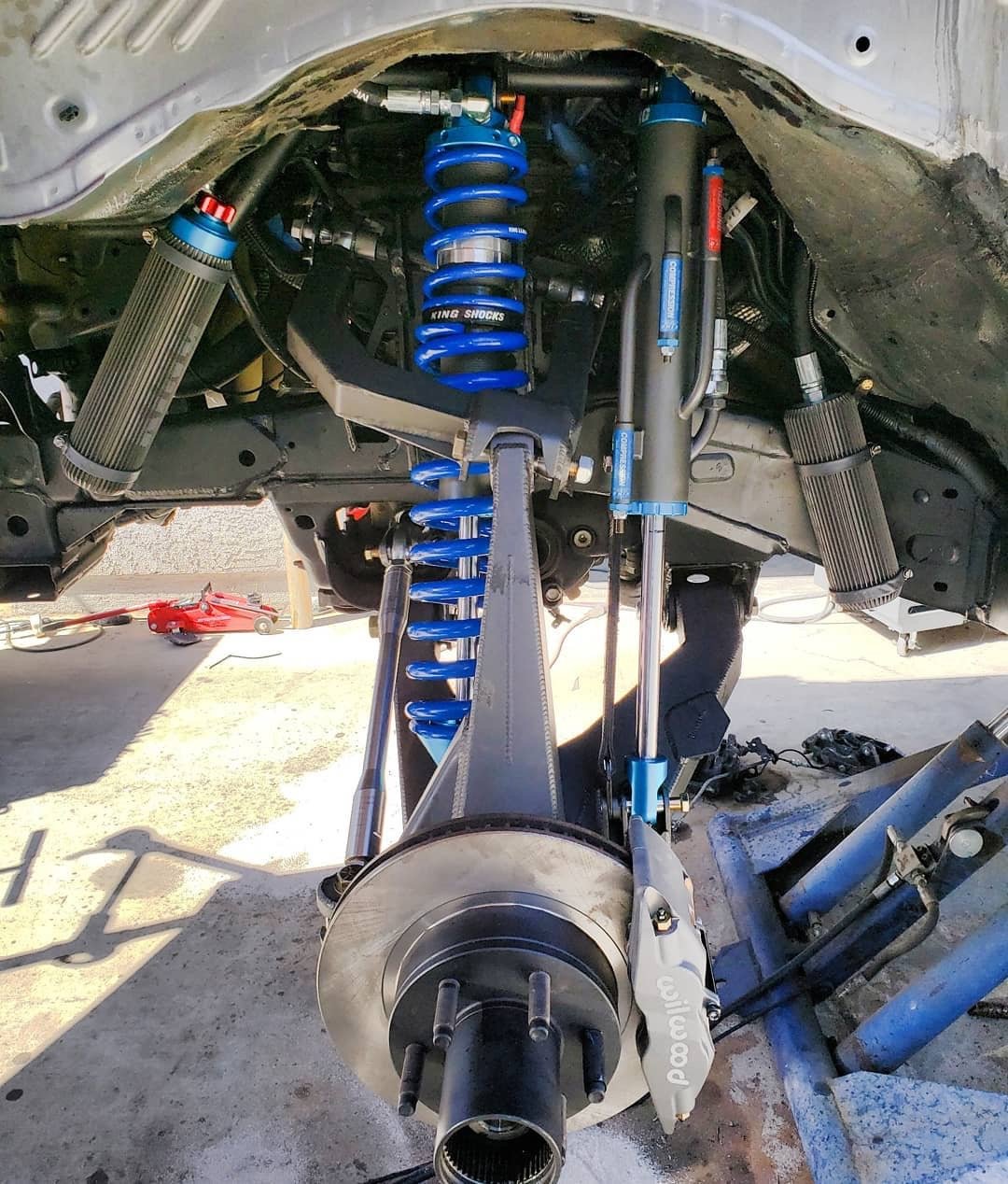

    Long travel installed. Rocking the Bluetooth axles and tie rods for now
