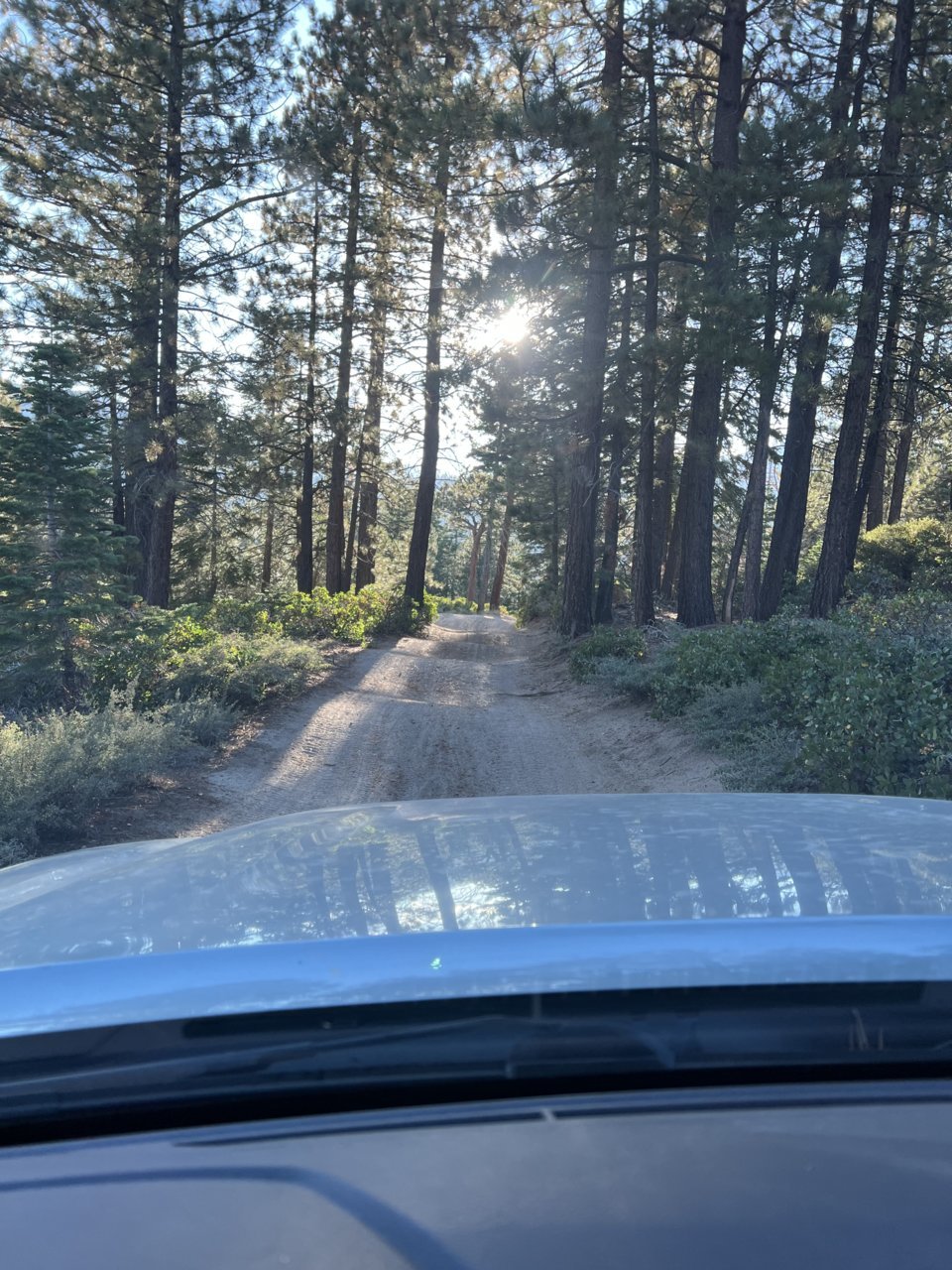

    It’s a third gen so no slide rack. I might do a tundra rack at some point, though.
    I do a lot of technical crawling and thin trails out here in NorCal so the 2.25” felt more appropriate. Is there that much benefit going wider? Looks to be about 1" of travel?
    Optimally I’d be hitting these at 40. :bananadead: And then the next day hit the Rubicon.

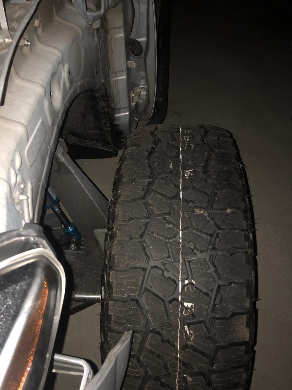

    From a visual perspective and how you’d fit on the trail
    A 4.5 kit
    Will be as wide as your mirrors are

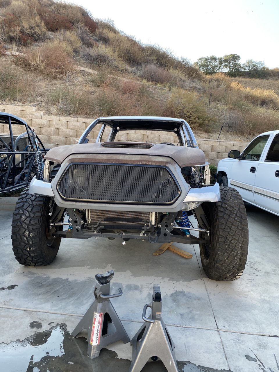

    God damn she's huge. What's the plan with that truck?
