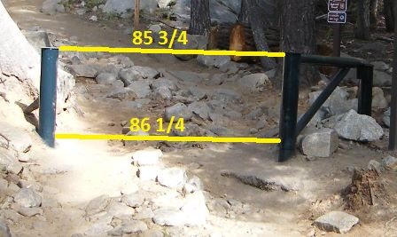

    I’m 95” wide
    So
    I wouldn’t even fit in that gate
    But I have 18” of front travel in 4WD
    So maybe I’d just crawl over it? (Jk)

    Haha, right out my backyard is Rubicon, Fordyce, Barret Lake which are all pretty tight rocky trails. Travel is important but I think the width might hurt me more than the extra travel would help me (talking specifically about the JD Fab 2.25 vs 4 which is 13" vs 14" travel per their specs).

    Being norcal and Rubicon the 2.25 or a 2.5 kit may be best. I'm 3.5 and some of the tighter trails up her I struggle. As well as those 'jeep' cliff edge trails, I have to hang a wheel off the edge and that isn't fun. My buddy build a 2.5 Chaos kit and it handles really really good in the desert. It's all about shock set up.

    Keep in mind a lot of jeeps/crawlers with full size axles and 40’s are pushing 90” or more nowadays. My truck is 89” in the front with a 3.5” kit, wheels with 3.5” bs and 12.5” tires. It feels wide in spots but made it through the rubicon and a bunch of trails in sand hollow and Moab without being too wide.
    Difference between a 2.25” and 3.5” kit is 2.5” or 4.5” with a 4.5” kit. Wider kit will have a better motion ratio for the shocks as well to allow better tuning.
