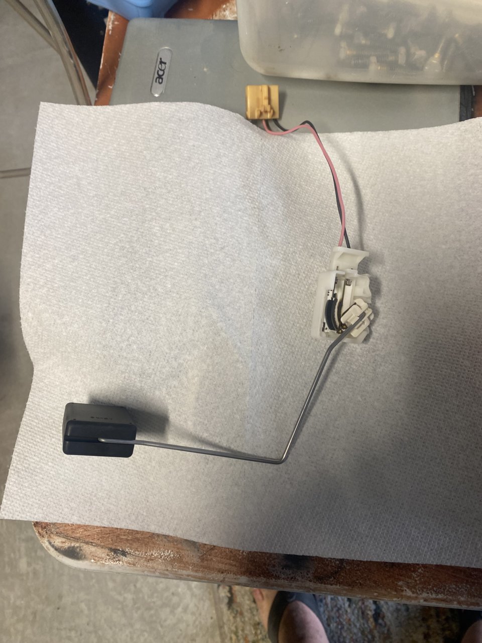

    Yes
    my gas gauge failed a couple months ago so i ran out of gas thinking i still had a 1/4 tank and it threw 10 codes / 5 per side that my cheaper reader will clear but they come back 2 days later i’m stumped so i was going to drop it off at the truck shop and let them figure it out

    Did you fix the gas gauge problem and are still getting codes?? My gas gauge failed(would not go below 1/4 tank on the gauge) and I put in a new sending unit and all was well. Though mine didn’t throw any Codes.

    I have not fixed the gas gauge problem yet, multi day troubleshooting projects are a problem for me because i live in a townhome and my truck is too long so i can’t close the garage door. I was thinking about just buying a new sending unit and going for it. I can’t imagine that the sending unit would cause all of those codes though ? and i really don’t understand why the codes keep coming back after just running out of gas ?

    What are the codes?

    they are all evap system codes :
    p043e - leak detect low flow
    p043f - leak detect high flow
    p2401 - leak pump control circuit low
    p2402 - leak pump control circuit high
    p2419 - system switch valve control circuit
    p043e - leak detect low flow evap system
    p043f - leak detect high flow evap system
    p2401 - evap system leak pump control
    p2402 - evap system leak pump control
    p2410 - evap system switch valve control
    I had zero codes prior to running out of gas so it just seems crazy that parts would be toast ?

    I had the same thing happen but with no codes - replaced the whole pump assembly since it’s a b**** to get to. It sounds like you didn’t replace the pump / float yet right? Could have a short or popped a fuse making those codes appear. I wouldn’t be surprised if they are all sharing some input parameter or relay etc.

    Ah yeah good idea I’ll run through all of the fuses tomorrow

    I had the same issue with my gas gauge. had a new sending unit put in and it fixed the issue. cleared codes with computer and did a battery reset as well

    It might have been a coincidence that you got those codes when the fuel level sending unit took a shit but all those codes point towards a charcoal canister/evap pump.
