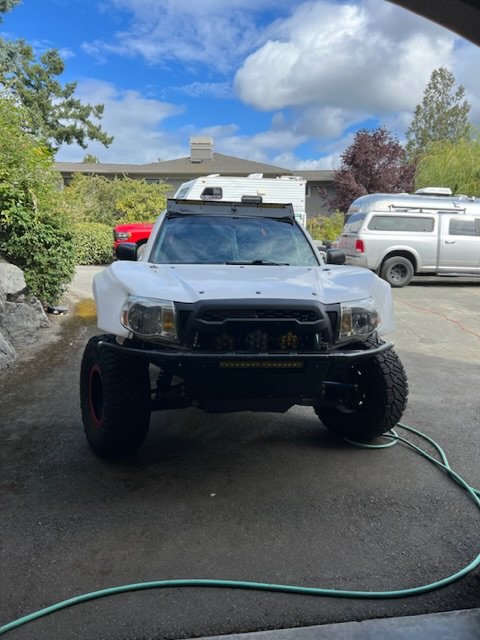

    tacotunner06
    tacotunner06 Well-Known Member
    Sep 2, 2017
    #228857
    2,266
    Edmonds, Washington
    2006 White Tacoma
    LS Swap with RSG Tranzilla, Custom hi clearance front bumper, Relentless: Slider's, bed rails, rear bumper, Prinsu with 40" BD s8. Dirt Designs 3.5 LT. Archive Garage rear towers/shackle flip/SUA. King Air bumps. King LT Coilovers in front. King 12x2.5 in rear. ARB rear air locker and twin compressor. SCS f5's with 33" Ridge Grapplers. 20" S8 mounted in bumper, squadron sport fog lights, squadron pro backup lights, LP6's bumper mounted.
    but how else is she gonna get this wide?
    Lol… also sad I couldn’t make the cinders trip.
    Supra4x4 and cowfootball[QUOTED] like this.
