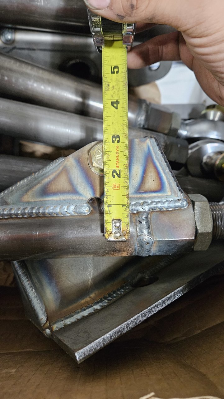

    I just did the Rubicon with Nick last month. He does not treat that truck well. If bending lowers was going to be an issue he would have figured that out by now.
    The extra clearance from the 40s probably helps the matter but you get the point.
    I'm pretty sure Nick did a podcast with some dudes and they discussed why he uses a 12" shock. He's explained it to me but I would do a horrible job a reciting the reasoning.
    From the pics, it looks like the upper shock mounts are the real limiting factor which he could probably squeeze a 14" in there if he did a redesign and moved the upper shock mount into the little cubby in the front of the bed like the JD kit does.
    I'll try to find the podcast.

    Uptravel wise, the panhard and the upper link are next in line (like .25") from bottoming out on the frame. I believe hes going to come out with a more traditional pocket trailing arm to fit a 14 but with the same shock tower, and also towers into the bed sometime.

    Right, I see that but a 14" shock is like 3" longer TLG than a 12". The gain would be down travel if he were able to fit the longer shock and not sacrifice any bump travel.

    Pretty much would be just a traditional trailing arm with shock bolt in the centerline of the link, as the shock bolt right now is 2.4" above centerline. For me I could care less about more frame uptravel, just less clearance in the rocks
