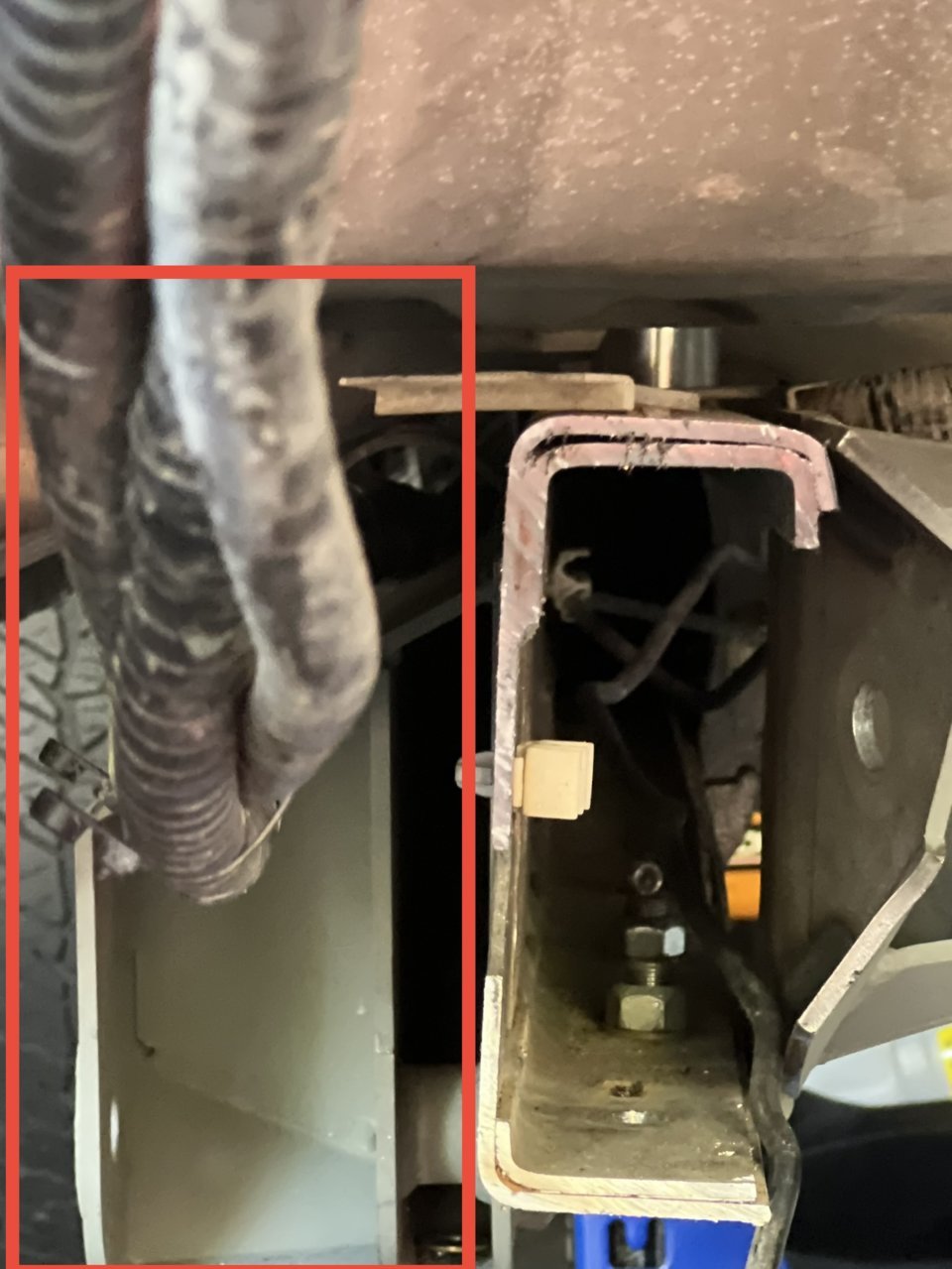

    To emphasize how much these frames are noodles, look at the c channel on my truck after I chopped it in half and removed the crossmember. The link pivots are loose on the frame, so ignore those but I put the red box as reference what is close to square.
    C channel mostly twisted inboard. I started working on attempting to square them up yesterday.
