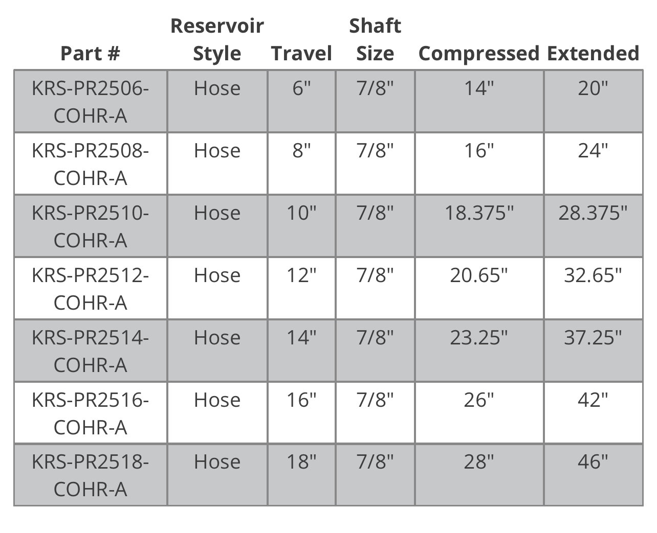

    It does seem like the best of all the ones mentioned recently but again the shock length seems odd they say it is a 14” shock under the bed ? My 12” CO are slammed to the roof of the wheel well

    yup i get it but a CO mounted to a trailing arm is a whole different story. my shock tower is slammed ie: perfectly matches the contour of the inner fender and is 1/2” from the back of the cab ie: you couldn’t possibly go any higher or farther forward.
    im actually in the process of wanting to update mine now that i've learned a bit more and i am going to cycle it and check it out next weekend but prelim looks at it i just dont see a 14 fitting without loosing uptravel because the body of the shock would hang down over 2” lower.
    check out the difference in compressed length between a 12 & 14
    the 14 is 2.6” longer compressed
    **just to repeat - i understand that crawlers don’t care about that but most of these convos have been geared around “ would it be good for the desert “

    The bottom of their body definitely looks lower than yours but a shorter rod end could make up an inch or two of up travel for them. It looks like a shorter rod end would work with those arms compared to yours.

    Your upper shock mount is about as high as you can get it. Looking at your current setup though you may be able to get a longer shock in there if the lower mount was further back on the arm. Your motion ratio would change but I would be curious if it would work.
    I realize a 14” shock is longer than a 12 and am not interested in sacrificing up travel to get a longer shock in there. I’ve installed a 14” smoothy with an Archive relocation and it wasn't ideal but the Archive relocation doesn’t put the upper mount as high as yours, JDs, or what I’m assuming Warfab has done.
