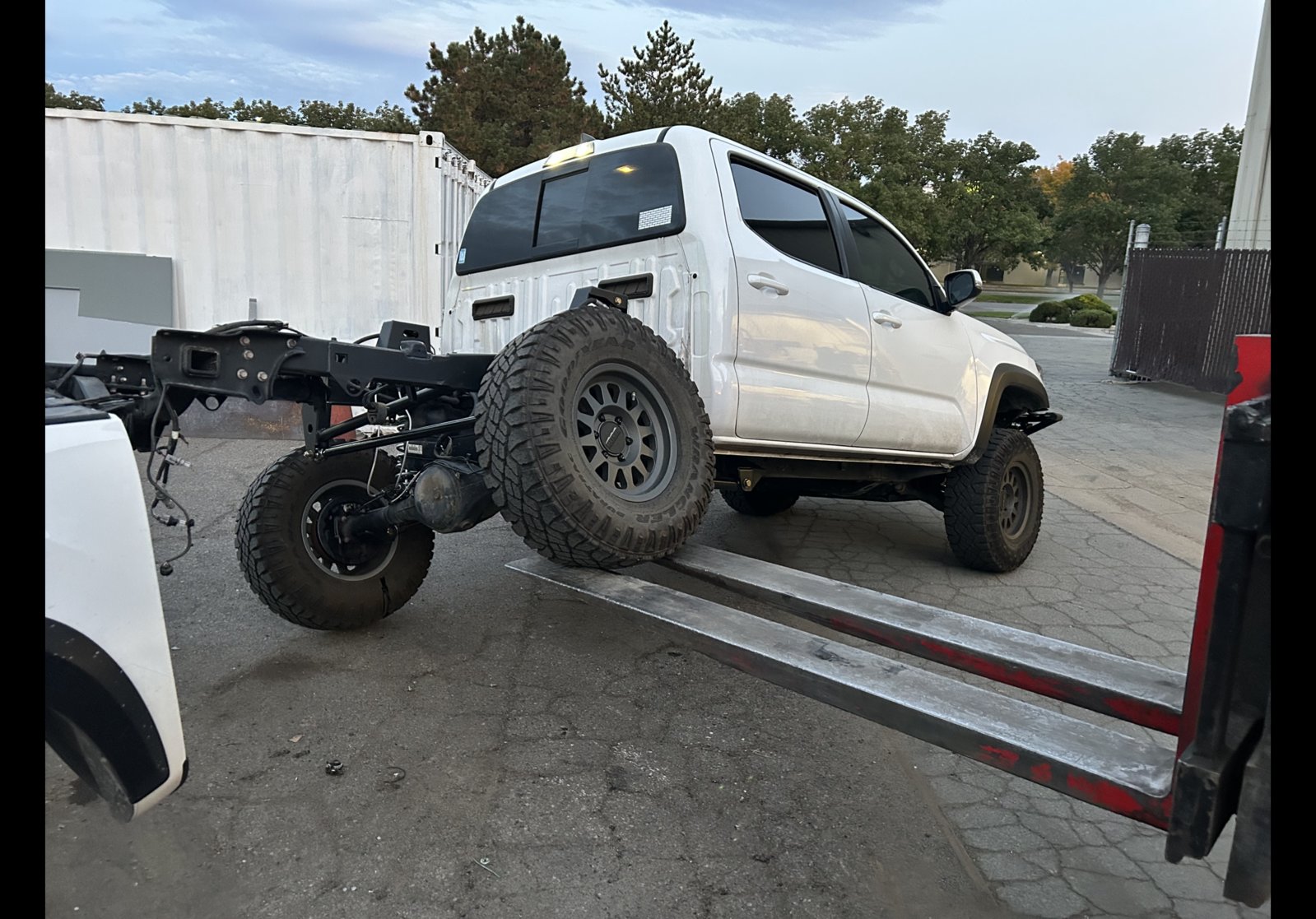

    A few things….

    Yes Martec, just installed today, great kit. Did it in 1 day.
    SoonToBeOn39s[QUOTED] likes this.

    A few things….
    Need custom hoses made for the shocks, fab and mounts for bumps and have to relocate rear slider mount points… but gained 12” of flex!
